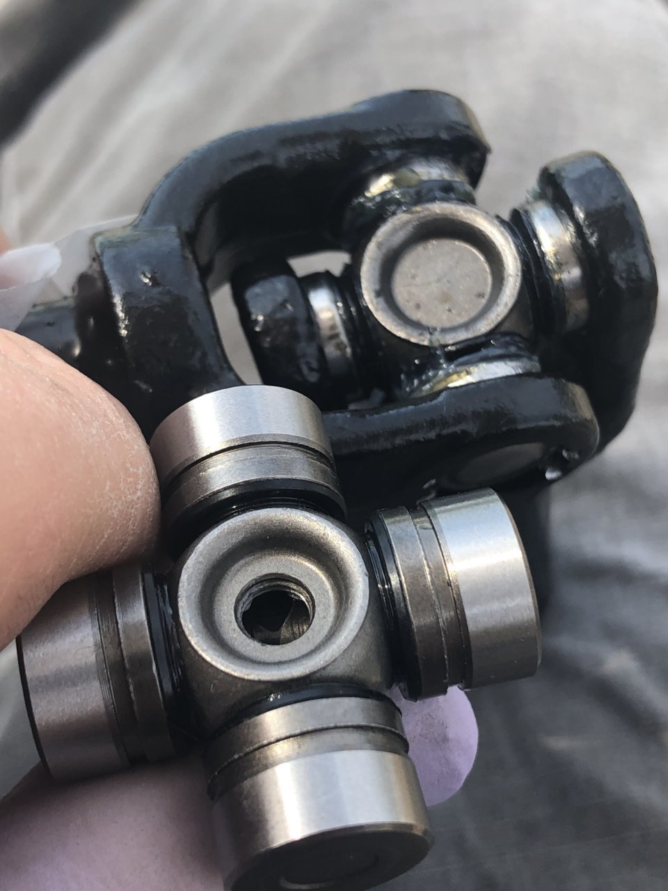

    Just a thought ... what about installing a grease/Zerk fitting on the cover plate of the non-greasable bearing?
    I ordered a new intermediate steering shaft (that comes w/ the non-greaseable bearing), along w/ the Honda 237-191010 greaseable bearing. I’m going to install a grease fitting and install that one. Then take the old, locked up shaft and replace that old nasty bearing with the new Honda one.
    Anyone have a preference or recommendation on whether to use a 90*, or 45* grease fitting?
    Thanks! LOVE the expertise contained here!5683F331-8973-4E44-B157-B761DF59B746.jpg
