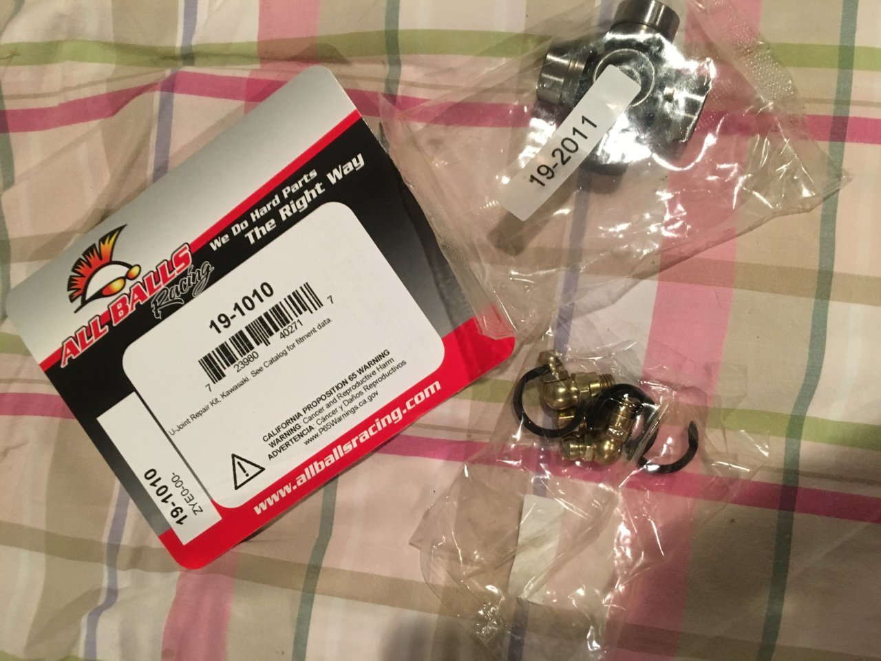

    I checked out the All Balls 19-1010 and found it at FortNine out of Montreal for $23.99. I have couple motorcycles and have ordered many parts from them and found their prices some of the best in Canada. I checked this thread cause I'm starting to have hard steering when going around corners. It starts out hard, releases and then easy to steer until I change directions again. When cruising down the road I'm not moving the steering wheel and all is fine. I'm going to try to clean up this u-joint first, blast it with a pressure washer, some release oil, and then spray her with white grease to see if it solves the problem. If that doesn't solve the problem, it will be repair time.

    So I ordered the whole lower steering shaft because I couldn't confirm that this U-joint would fit my 2WD 5-lug. They sent me the wrong part! However, I was able to compare the 2 shafts side by side and take measurements.
    The 2WD and 4WD models have the exact same size U-joints. Part# 45203-04010 is roughly an inch shorter than part# 45203-04020 and are otherwise identical.
    I have since ordered the AllBalls 19-1010 U-joint, repaired my lower steering shaft and installed it. So I can confirm that this repair works on 2WD non-Prerunner models.
    I got the U-joint from FortNine for $23.99 Canadian ($36.14 shipped and including taxes). The whole lower shaft was from the seller DIYAPS on Amazon.com for $145.95 US shipped (over $200 Canadian). For comparison, the 4WD shaft from the same seller is $57.95 US. The extra labor is totally worth it; I saved $165 for an hour of work.

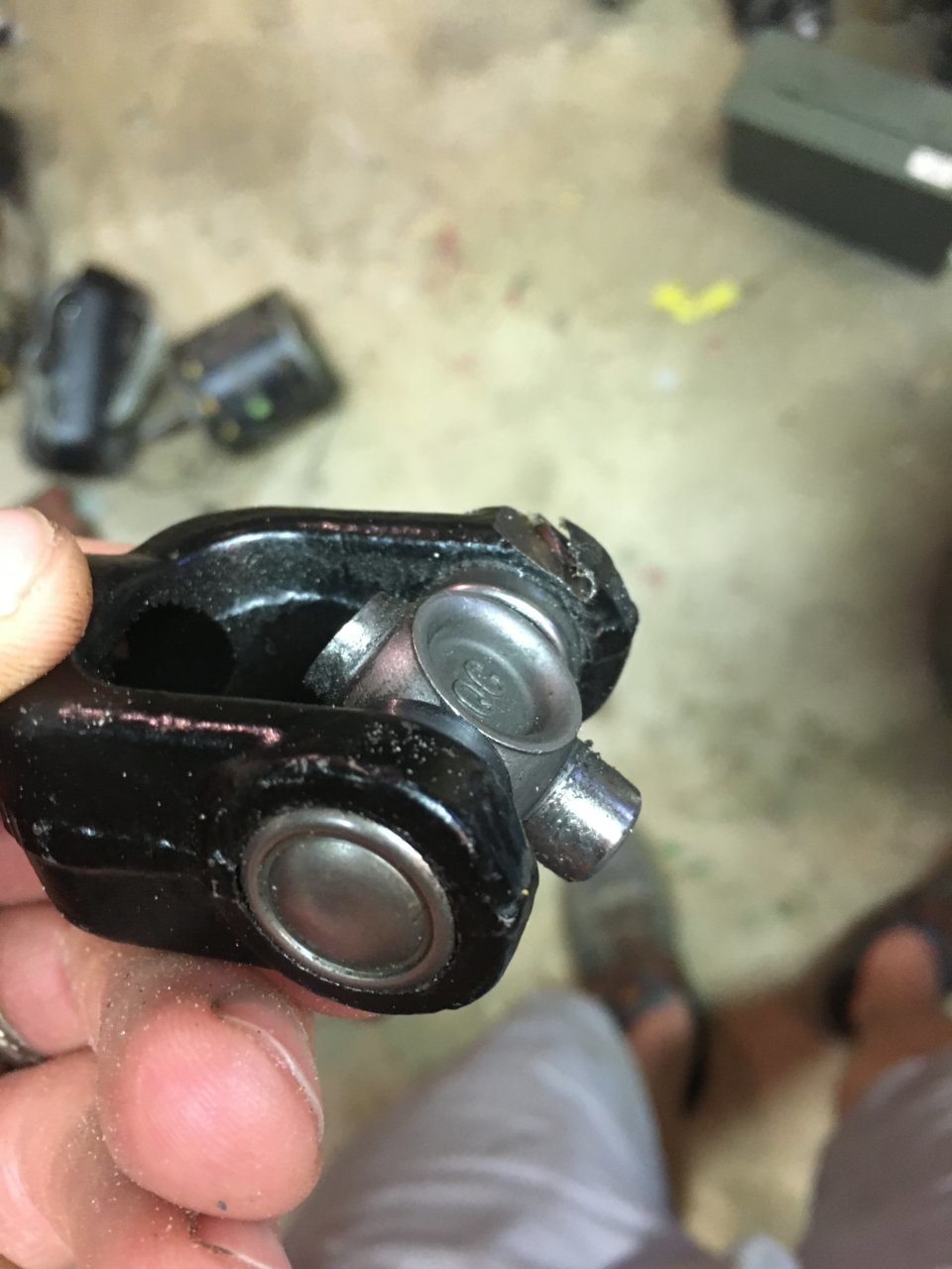

    Finally got around to installing my All Balls joint today. Of course the bolt on the lower yolk had to break, and although it broke in the middle, a little was still in the recess making driving it off that much harder. This then led to having to grind flush the little bit of threaded bolt that sticks out and then drill it out. Ended up replacing it with a 5/16” x 1 1/2” bolt and nylock nut. Installing the u joint went pretty smoothly. I ended up off a spline so a quick tweak of the tie rods and i was all gtg. Steering feels smoother. There was a good amount of play in the old joint so even though a shot of lube smoothed it out it was time for this.

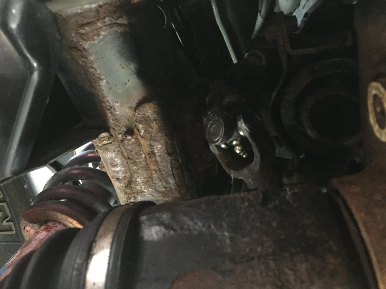

    @Toy4me my frame looked like this and they found a small hole like real small and they did the frame in my 2007 take it in and get checked out

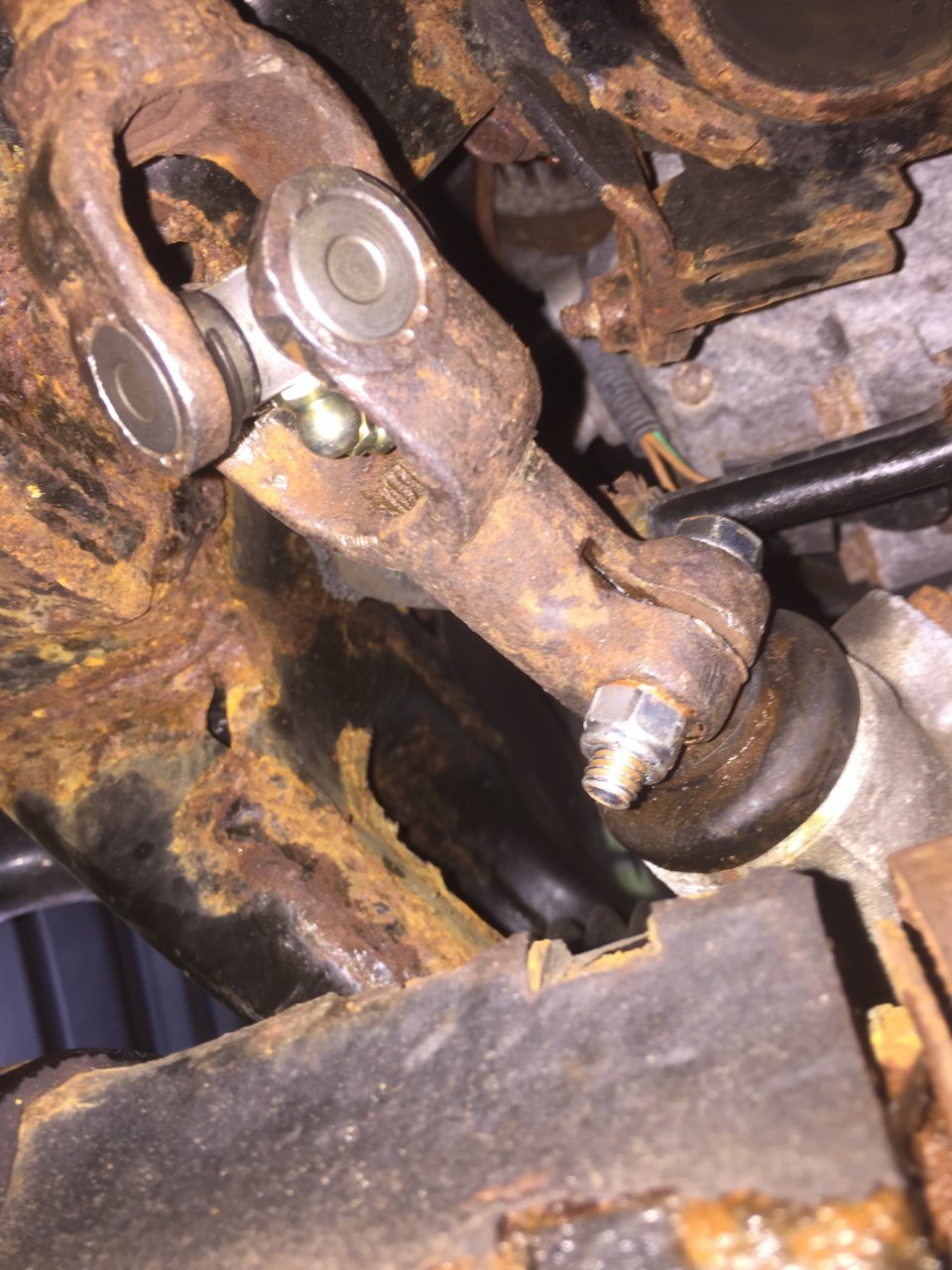

    my steering was sticking (but no play) and found this thread thank you.
    my poor farmer temporary fix was to spray and exercise joint till loose, then cable tie a length of plastic vacuum cleaner hose around it and pump it full of red grease. it's been too good since winter to fix it any more : )
