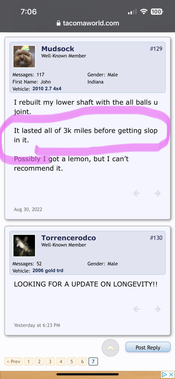

    Mudsock
    Mudsock Well-Known Member
    May 15, 2014
    #129878
    153
    John
    Indiana
    2010 2.7 4x4
    I rebuilt my lower shaft with the all balls u joint.
    It lasted all of 3k miles before getting slop in it.
    Possibly I got a lemon, but I can’t recommend it.

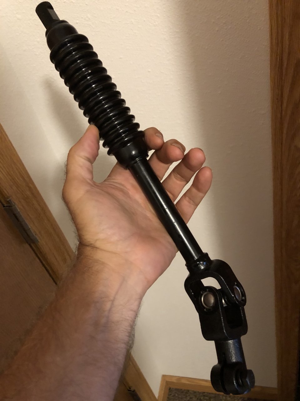

    I’d guess I had about a month and a half of just normal highway driving 89EAF76A-E033-4D02-A7AE-661F80A81186.jpg
