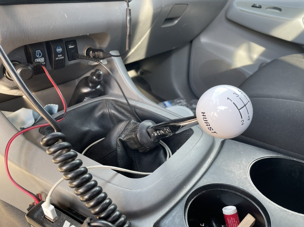

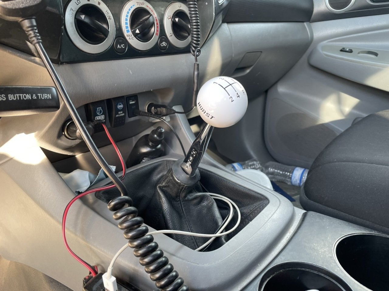

    OK...I have a 2007 Extended Cab 4x4 4 Cylinder 5 SPeed that I just bought....they have replaced the shifter know (which I don't like)...am looking for a stock shifter knob to put back on it...but also am considering going with a shorter throw for shifter and have several questions!!
    1. Looking at my pics does my shifter look to be stock (Other than the knob)....it seem high but maybe it is just the knob...and not sure why the boot rides down to where the shifter stick starts to taper up? Was there something on the original knob that held the leather boot up closer to the knob?
    2. I don't like the long throw on the shifter, so am considering replacing with a URD or the TRD short throw? Have seen some threads on comparisons...1 question with the URD since I am assuming i will be reusing my same shifter...does it mount the actual shifter into a lower position or is just changing the pattern?
    3. Is there a preference of 1 over the other (especially when trying to go to reverse)
    4. I am assuming that if I find a stock original shifter knob it will fit either?

    forgot them!! Pics of the shifter..

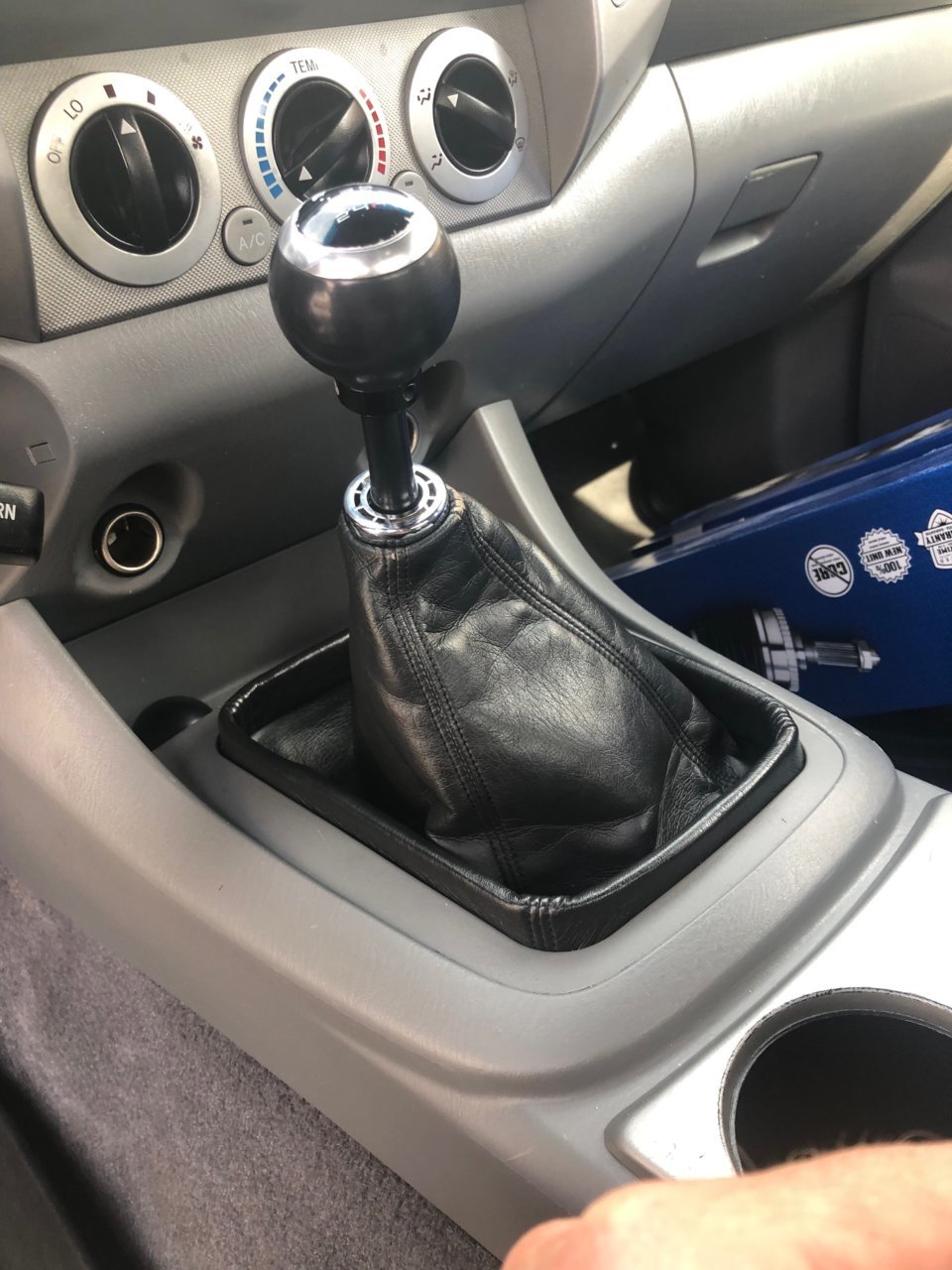

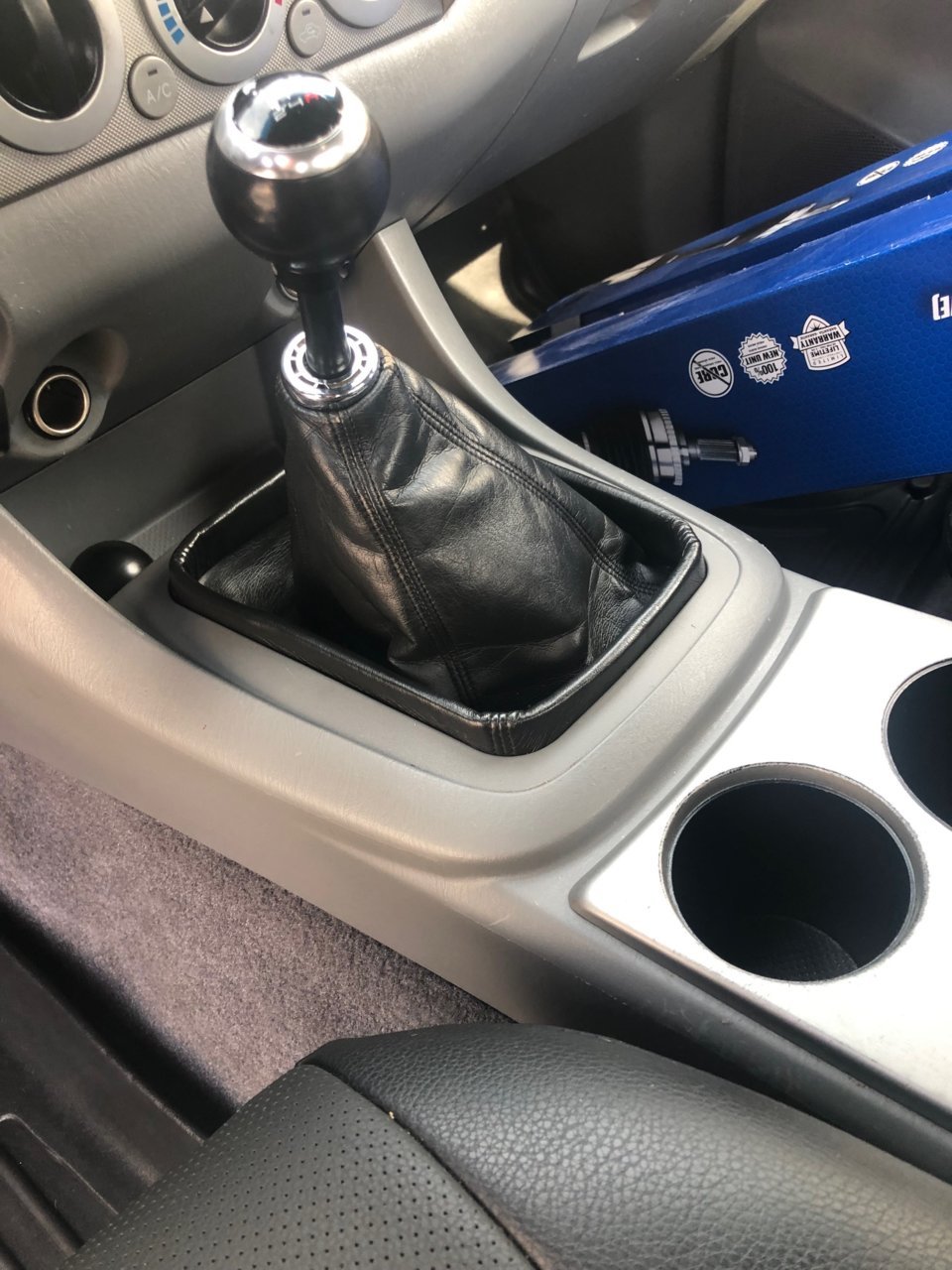

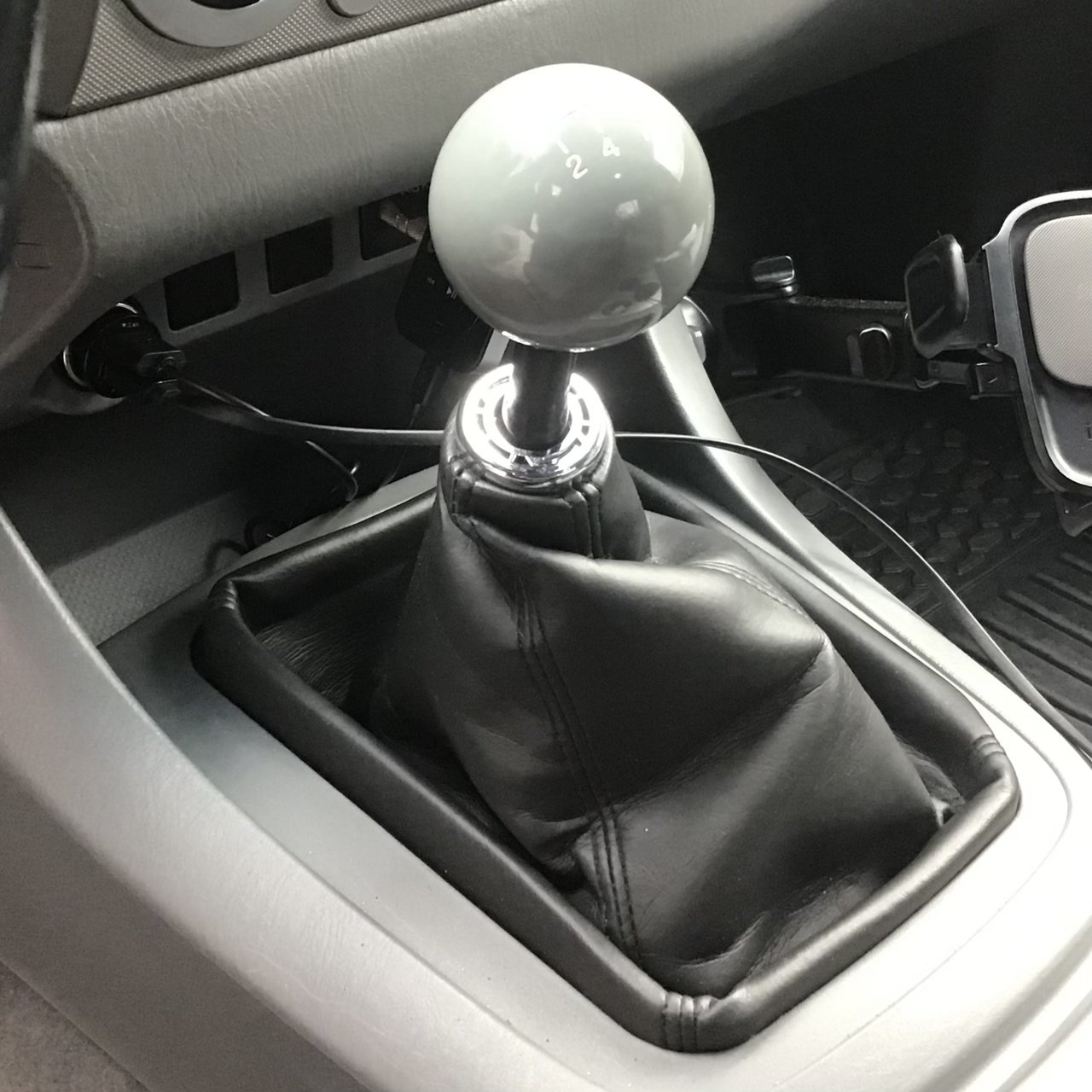

    I’m pretty sure the shifter is shorter overall here’s some pics for comparison
    here’s a pic in 1st gear
    and 2nd so you can get an idea of the throw 95D0FA6E-3D0B-46D5-8DB9-550D618F9294.jpg

    also from your pics I notice how the boot on mine is raised and different like a raised flange? Is that a 2007 thing or has it been altered or replaced?

    That is a redline goods shift boot that I installed. My stock oem pleather one was tired
