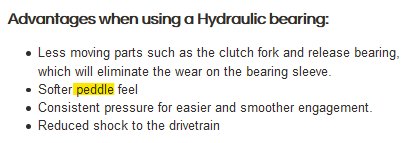

    I have an RA60F with ~80k without this issue yet.
    On a somewhat unrelated note, I got a chuckle out of the idea that a clutch-oriented business used the wrong word for something integral to manual transmissions (peddle versus the correct pedal).
