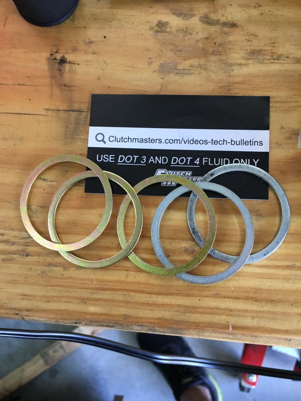

    @Canadian_Shooter is correct. Since the kit was designed specifically for the RA60/61 transmission and the OE clutch stack height (the total height of the flywheel and clutch) their is no need to set the air gap as the spacer and overall total height of the release bearing are what gets us the required air gap. Setting the air gap does come into play if you were to say have purchased the universal bearing kit and you were setting the kit up and had to make a custom bracket/spacer.

    6AD868FF-BA24-4873-88D3-0B703DB39F07.jpg What are these spacers for then ?

    Pretty sure you got one of the earlier kits that was already packaged with those spacers. Everyone else I don’t think got any spacers.

    yeah i didnt get spacers.

    Great! I’m neck deep in this right now and the spacers threw me off !

    If it's deep in the throw, then I would contact clutch Masters and see if their earlier throw out bearings needed spacers compared to the later throwout bearings.

    @garciav there was no changes with the kits. Pretty sure the only reason you got spacers was because of the way the kit was originally packaged with spacers. My understanding with the bearings and spacers is they are just something the shipping guys have on their pick list to put in with those kits, but after they determined they weren’t necessary they weren’t sent with the later kits. The actual height of the spacer never changed from what I know since all the rest of the spacers were made off the dimensions we determined using my rig.
