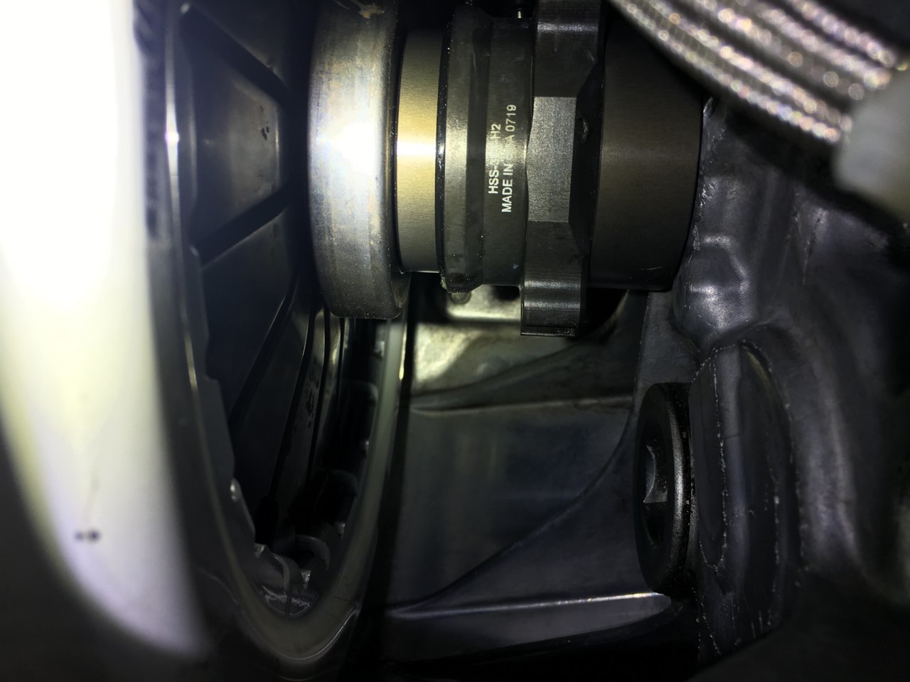

    That makes sense and could be the case. Yours looks pretty similar to mine though. Here’s a video I took of mine in action.
    https://youtu.be/A82ZCYAgRUo

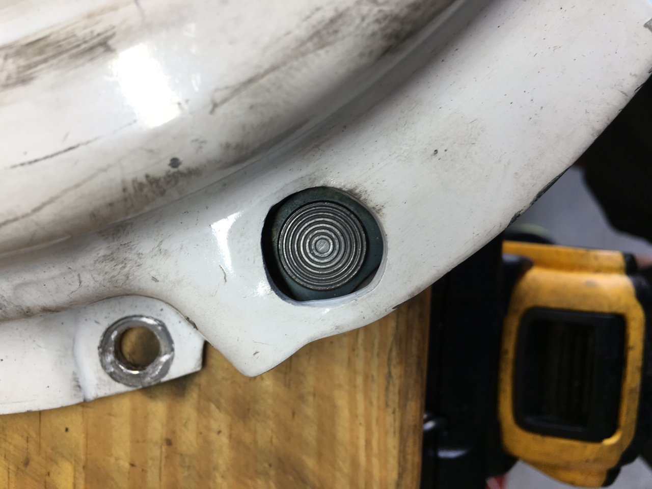

    Is the pressure plate powder coated?
    I had an issue once where the dowel pin holes on the pressure plate, were coated through. Wouldn't slide over the dowel pins without resistance. No problem once bolted down, right ??? Nope. Distorted the pressure plate. Disassembled from flywheel. Dremeled out the powder coating to allow it to slide without resistance, over the dowels on the flywheel. Clutch worked like a champ then.
    Maybe or maybe not your issue. Worthy of investigating.

    Update: @Torspd the comment you made about the dowel pins got me looking at the clutchmasters pressure plate more closely. Comparing it to the URD one, it looks inferior in many ways. The URD one definitely has more room for the plate to lift off the clutch..
    Anyways I threw the URD pressure plate back on , got the trans back up, lines bled and boom! I can get into all the gears with ease with the truck running. The URD pressure plate also has a much more firmer feel.
    I guess I’ll be hitting up clutchmasters on Monday and see what we can do here to fix this...

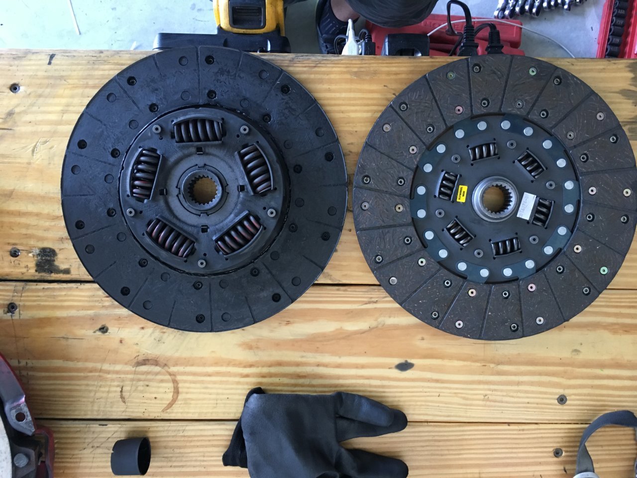

    Hope my post didn’t come off as rude, i do appreciate your input- I’m just a wannabe mechanic..
    Anyways take a look at this side by side pic of the urd clutch plate vs the clutchmasters one. Notice the difference in hub size and hub springs..

    27,954
    2009 Tacoma AWD Turbo 2TR-FE
    Full-time AWD & BorgWarner EFR 6258
    That would explain why my URD clutch is a bear to push in.

    582
    Houston, TX
    2013 Tacoma TRD Off-Road 6MT
    TRD SC,HPTuners
    I think that's actually from the clamping force on the pressure plate.. which URD clutch kit do you have ? after installing both pressure plates back to back the clutchmasters one made the pedal feel kinda flimsy...
