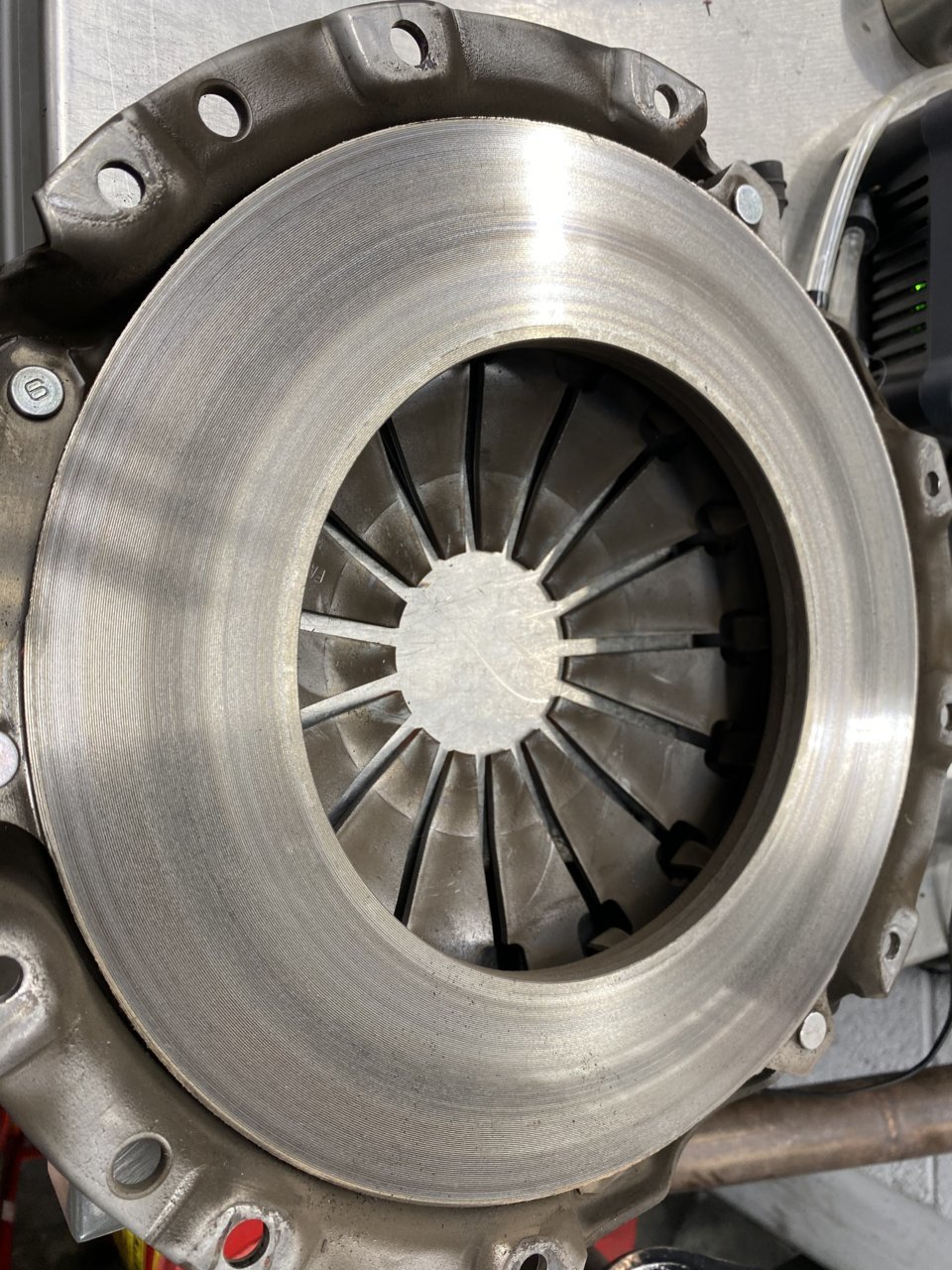

    Maybe contact your local parts stores. I do believe my local NAPA resurfaces flywheels, although I haven't done that in a long time so I can't say for sure if they do or not. Sounds like LuK didn't use the correct ring gear on the flywheel, or the ring gear was put on backwards!
    I do think the OEM flywheel is a good weight for these trucks if they are pulling double duty on the street and on the trails.

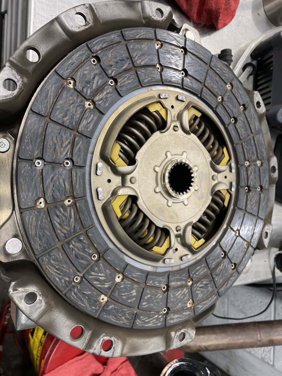

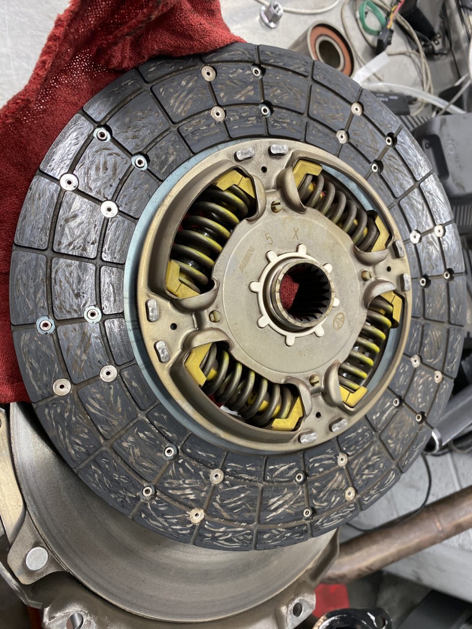

    I was just over on the FJCruiserForums and someone had posted an update on their CM kit install. After taking out their clutch, this is what they found! Notice anything wrong with those fingers on the diaphragm!? Wild how uneven the wear is and almost to the point of serious failure. I'm curious what would have happened if the fingers broke and the TOB pushed through....this is a direct result from the constant preloaded TOB on those fingers with the OE setup and probably can attribute some of it to the way the clutch fork actuates the TOB in an awkward uneven way. I know the TOB should pivot on the clutch fork but something must have cause the TOB to stop being able to pivot. Just wild speculation at this point but pretty interesting picture.

    What clutch is that

    87
    I believe he said it was the OEM clutch

    My shit is all stock.
    Correct. OE Toyota / Aisin clutch with about 20k miles.

    Torspd Custom Turbo kit [] Borg Warner 9180EFR Turbo [] Haltech Elite 2500 [] TiAL Q BOV [] TiAL V44 Wastegate @ 15psi [] CP Pistons [] CP Carrillo Rods [] ARP Head studs [] ARP Main Studs [] ARP Header - Head Studs [] Ported Heads w/ 1mm oversized valves intake/exhaust [] Brian Crower Forged Stroker Crank [] Darton M.I.D. Sleeved Block [] Kelford Camshafts [] Torspd 160* T-stat mod [] APR Large Fuel Rail [] Walbro 460 LPH E85 Fuel Pump [] FueLab FPR [] APR T56 Conversion Kit [] KP RACING Built T56 [] McLeod Racing Custom Twin Disk Clutch [] One Piece Aluminum Driveshaft [] MGW Shifter [] Custom lowering kit [] Ohlins Front Coilovers [] QA1rear shocks [] Custom Ron Davis Radiator [] Dual SPAL Electric Fans []
    Bad news when those plastic dampers, at the ends of the springs, break. Not a fan of that design.
    Start stop friction. Wow. Almost wore through for no ability to actuate.

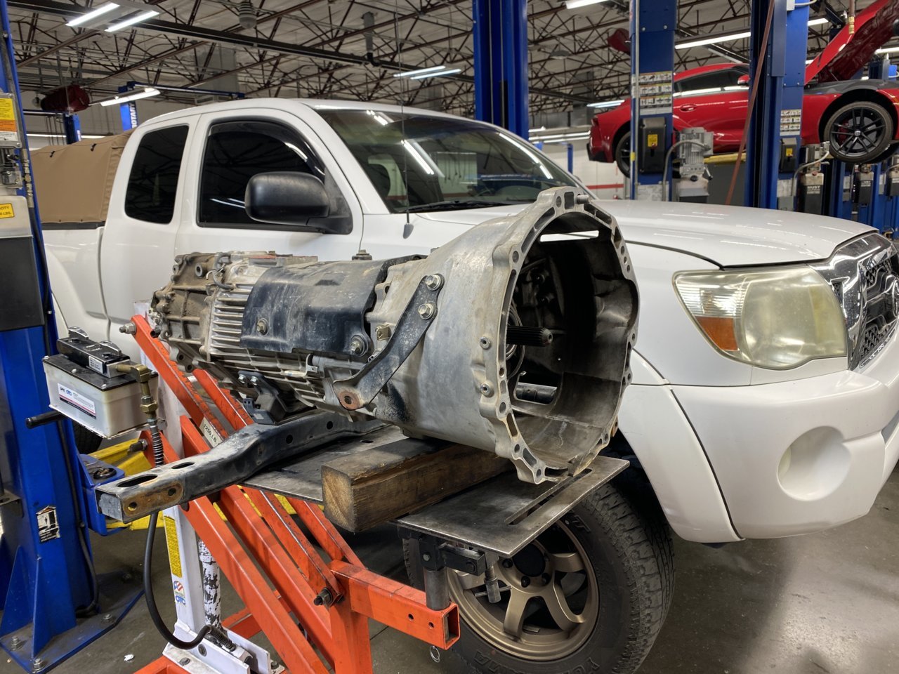

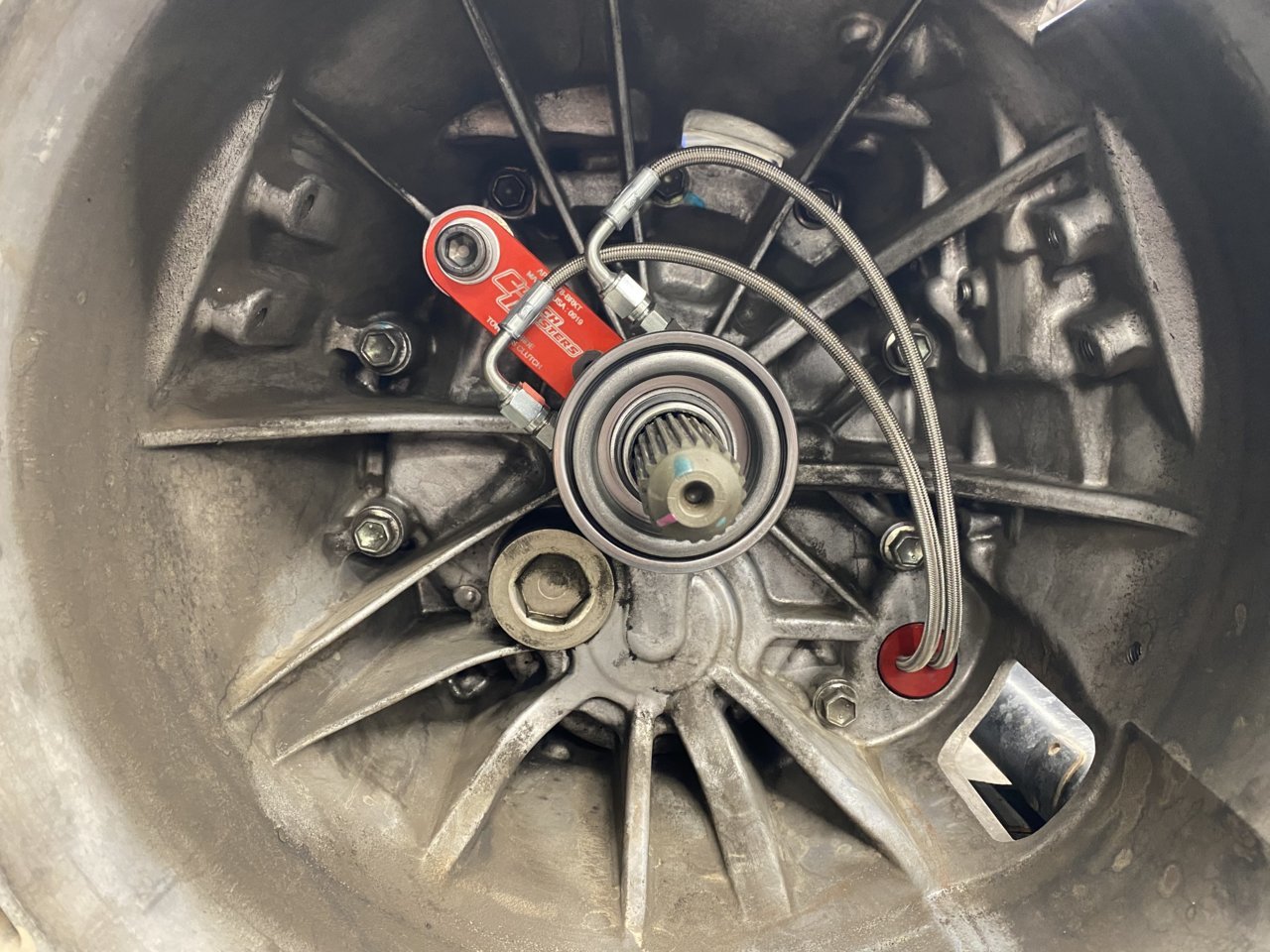

    New clutch and TO bearing are in and running. Clutch seems to be working. But, I need to play with some adjustments. Clutch engages like immediately within millimeters of starting to let up on the pedal. I also am having trouble getting it into gear. As if it’s not totally disengaging or dragging. Also, if I just sidestep the clutch, the pedal comes up really slow. As if the fluid is passing through a tiny orifice. I don’t think it would matter during regular driving though. Is that just the nature of a hydro bearing like this? I bled the system as well as I could. No air, nice clean fluid pumping out.
    One complaint. The pressure line was excessively long. Had to get creative with the routing to try to prevent air traps. They really should include a shorter line for Tacoma applications.

    Another note. Before even connecting the pressure line, when looking into the inspection hole, that bearing had quite a ways to go before it contacted the fingers of the pressure plate. Maybe 3/8” or so had to be made up before it made contact. No sure how much travel these things have. I’m wondering if the spacer behind the bearing needs to be thicker.

    Same thing with mine, the pedal was adjusted way to far down. It's super easy to adjust at the clutch pedal though and you should easily be able to get it to engage and disengage in the middle of the pedal throw. Try adjusting your pedal and see if that clears things up. On my rig if I pop the clutch pedal off the floor the pedal travels slower until the point it reaches the disengagement point and then pops right to the top. Yes there is a small orifice that fluid is traveling out of in the hydraulic bearing housing.
    Since the hydraulic bearing kit is a self adjusting system the bearing does start off with what might look like a lot of air gap. The first time you push on the pedal the bearing will make contact with the clutch diaphragm and as your clutch wears those diaphragm fingers start to move out towards the bearing, pushing the bearing a little further back into the housing. There has to be some gap to account for the clutch wearing. As long as the bearing piston doesn't pop out of the housing, which CM hasn't heard happening, you're going to be ok.
