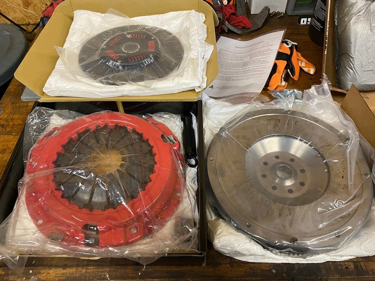

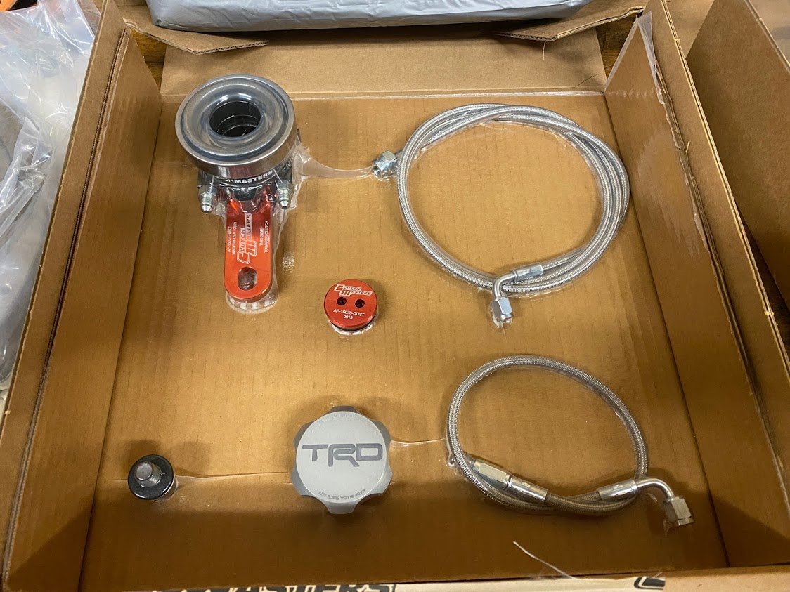

    #387
    6 gearT444E
    6 gearT444E Certified Electron Pusher
    Feb 3, 2018
    #243372
    7,786
    Deep South
    Herculiner Hootus
    These are going in tomorrow, wish me luck!

    What brand clutch (package) is that? ClutchMasters or ??
  11. Dec 28, 2019 at 8:27 AM
    #391
    wrmathis
    wrmathis Dark Lord of the Sith
    Sep 10, 2008
    #9126
    9,446
    Bonaire, GA
    2006 Tacoma TRD OR 4x4
    parts and stuff
    he got a URD clutch and i think their heavy flywheel

    URD stage 3 and URD heavy flywheel

    The PD&M sleeve was for sure a much better solution then the factory setup since it reinforced the aluminum quill with a steel sleeve. That was initially going to be the solution I was going to end up going with until I kept doing research and found that people were having massive failures with those kits as well (entire quill snapping off). Probably a rarer situation then the OE setup but still wasn't my first choice at that point. Ideally this whole issue could have been avoided had Aisin manufactured the transmission with a bolt on steel quill or snout like a majority of transmission out there have.
    I'm putting on miles as quick as I can lol, about 2800 miles in and zero issues. I have taken the inspection plate off and everything still looks brand new in there, zero signs of wear to the piston.
    Yes the TOB still technically rides on the diaphragm, there is no way that it couldn't. However compared to the OE setup that preloads the TOB against the fingers, the CM setup is just riding on the fingers with zero pressure. When I approached CM about this fix, I never intended or expected to have a solution that would eliminate the possibility of a TOB going out down the road. I mean there's only so much you can expect out of a bearing that spins thousands of RPMS for several thousands of hours runtime. My main goal with developing this kit with CM was to eliminate the possibility of catastrophic failure with the quill/snout or pivot ball. I do feel however that the TOBs should last longer with these kits because of the fact that they aren't being preloaded against the diaphragm.
    Ha yeah Albins, that's definitely a typo! Aisin is the manufacturer of the transmission. Yes this kit has been specifically developed to work with OE stack height clutch kits. CM developed a spacer specifically for these transmissions where as a lot of the other hydraulic release bearing kits for other applications were made with a more universal spacer setup.
    As I mentioned above, yes the TOB does ride on the PP fingers. The air gap is setup to allow the bearing/piston to self adjust with the PP as the clutch wears. @gearcruncher has explained it perfectly in previous posts on this thread.
