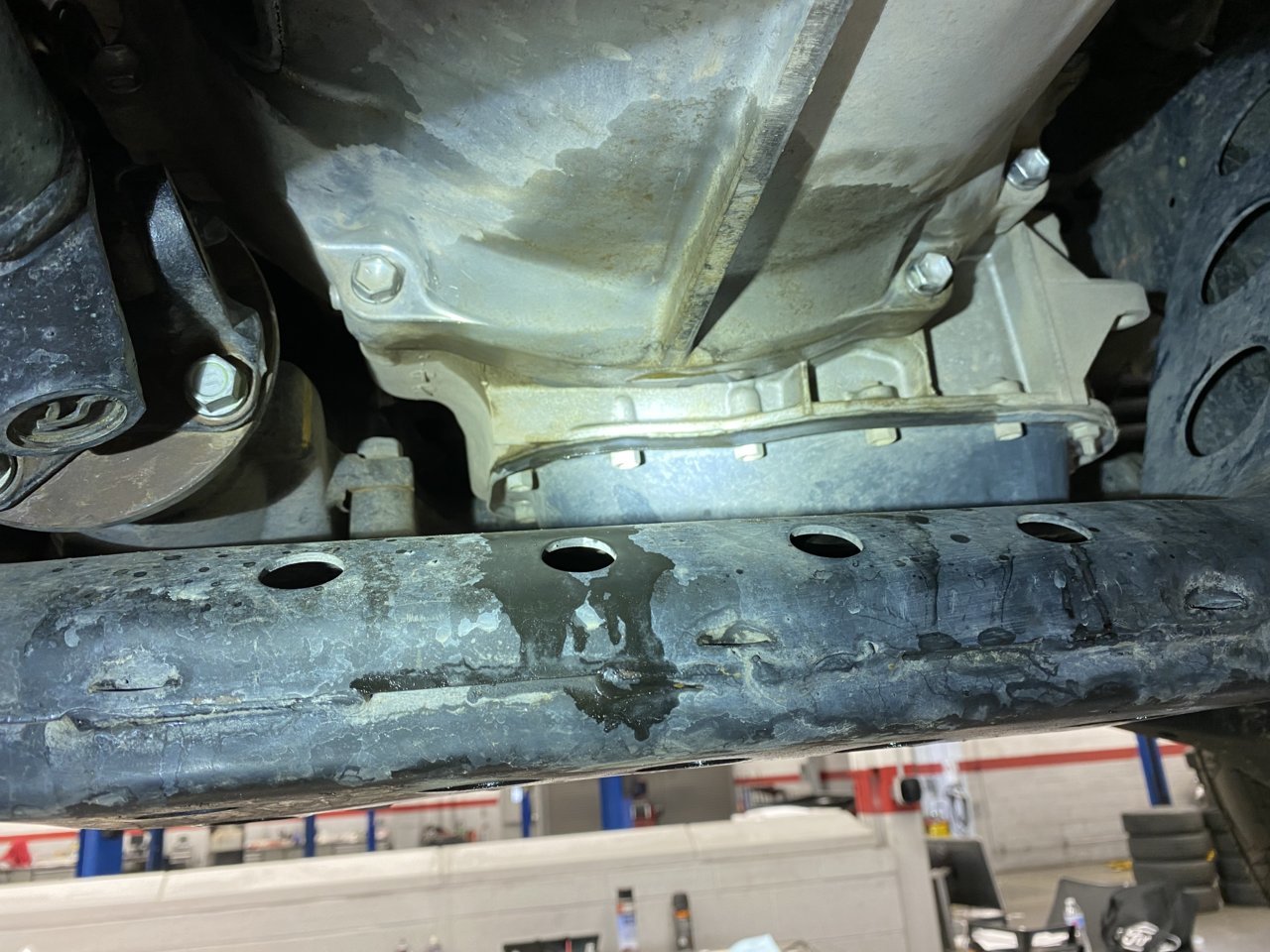

    I can’t see the top of the braided lines. But, as my helper was pumping the pedal, I could see fluid building up around the black bearing seal a bit more with each stroke.

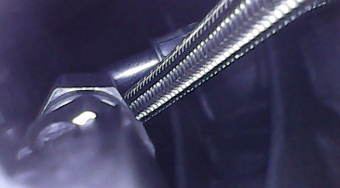

    can you sneak a endoscope in there to see if the if its the fittings that are leaking ? I hope thats the case, otherwise us that have this installed are rolling on a ticking time bomb. good thing I didn't throw away my URD hydrobearing kit...

    That's a great idea. I'll work on that.

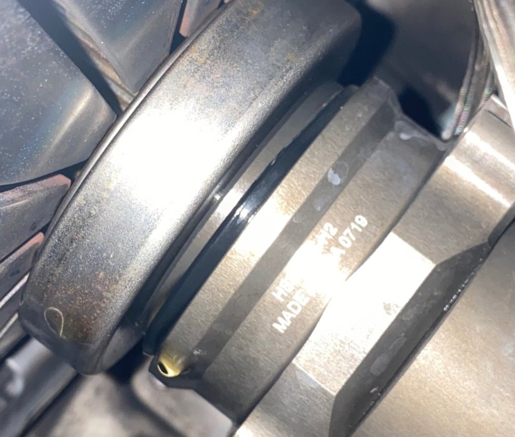

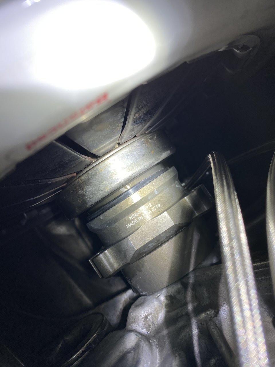

    Best pic I can muster with the scope. But, the top of the bearing is dry.
    I'm noting obvious distortion to the rubber seal/boot which is where the leak is coming from.

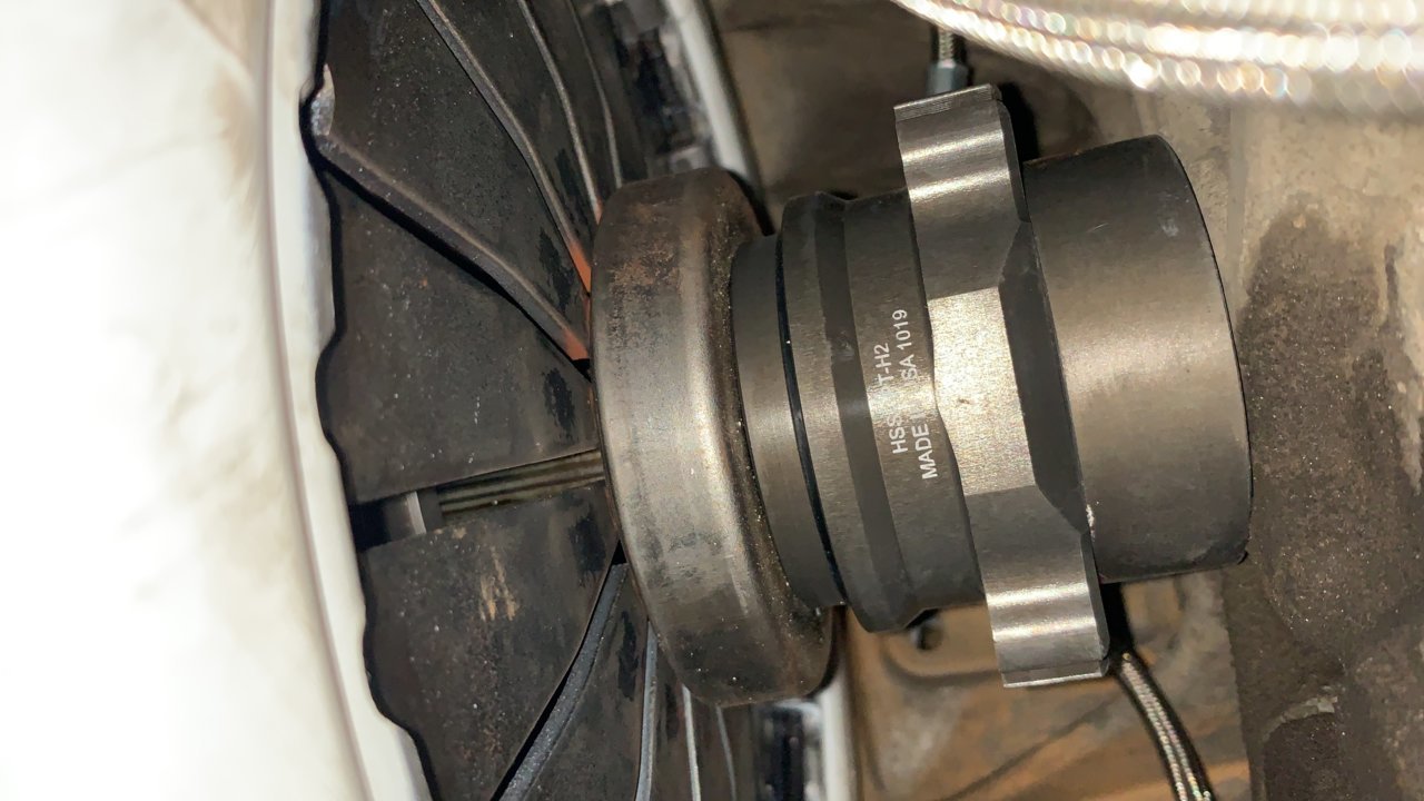

    Guess I'll crawl under and check mine since the inspection hole cover is MIA...

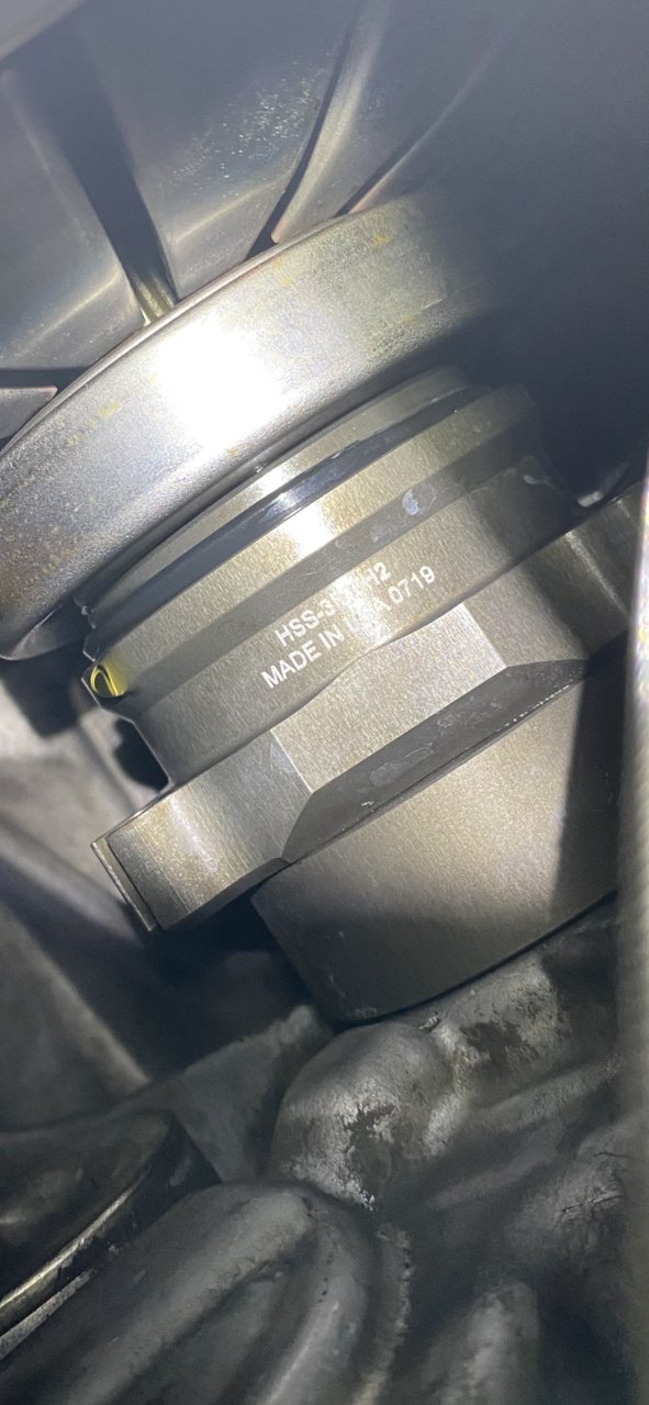

    Edit: Added pic
    Looks ok so far

    Better pic ?
  10. Feb 18, 2020 at 3:40 PM
    #530

    See how fat the black seal looks on mine compared to yours?
    hoverlover[QUOTED] likes this.

    Looks like it didn't get seated all the way when it was assembled. Might be the camera angle (I just used my phone) but it looks like your bearing has less air gap than mine as well.

    It's pretty obvious. That freaking blows. Hopefully they get you taken care of.
