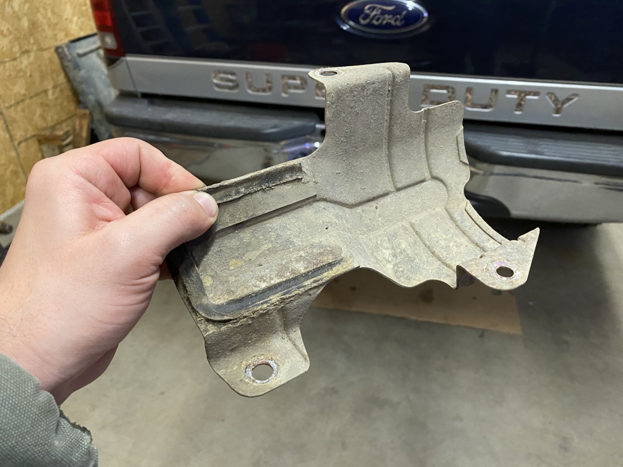

    sorry for the delay. Here’s the dust cover for the clutch. You can see the side I’m holding goes against the transmission and that gasket seals against the hole on the side of the trans. It’s not leak proof by any means but should keep any rocks or dust out.
