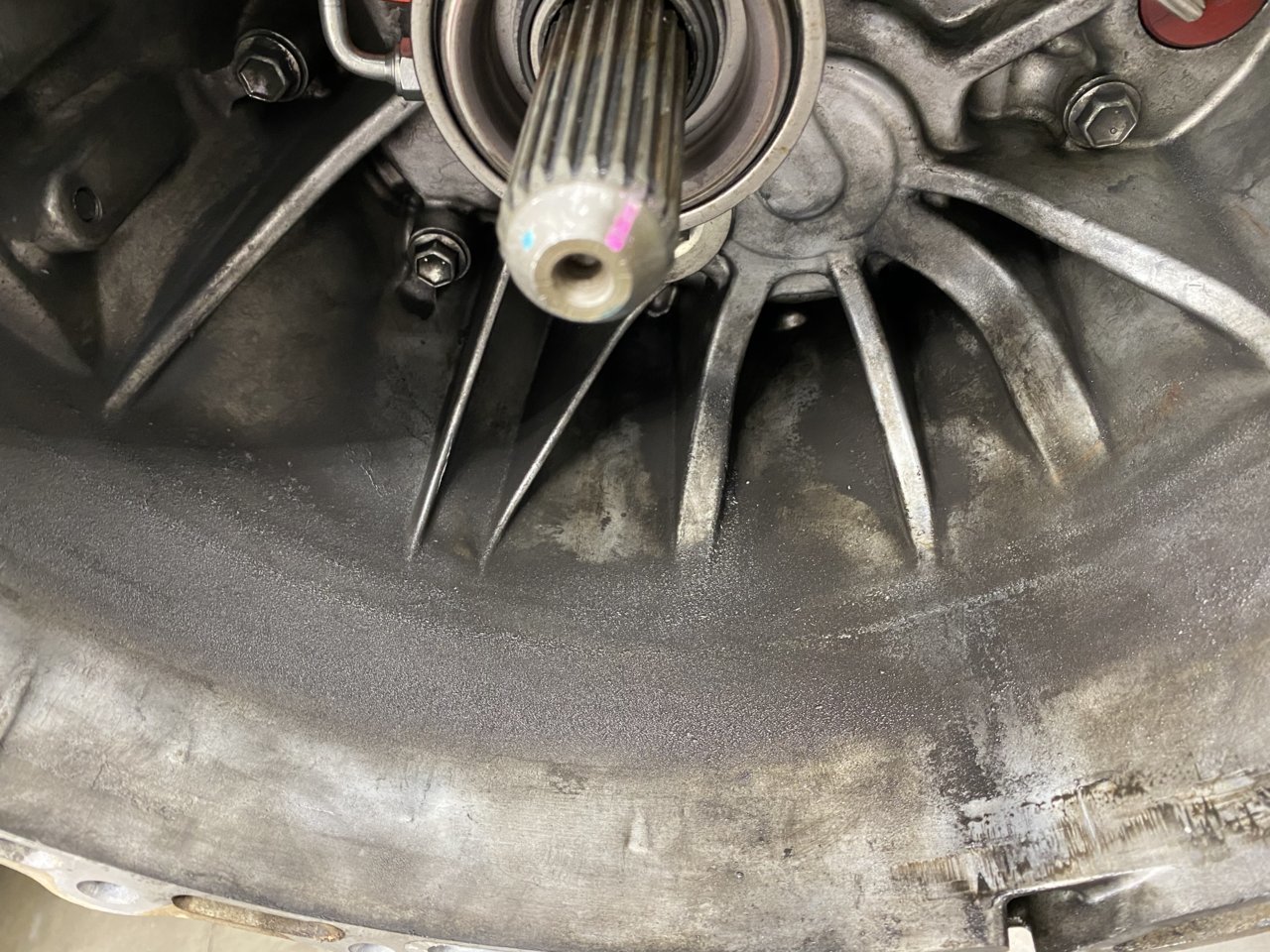

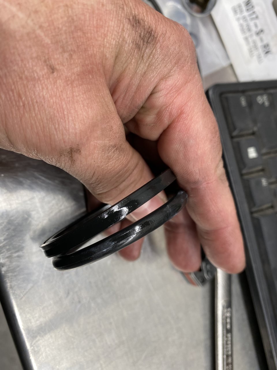

    I pulled the trans out today.

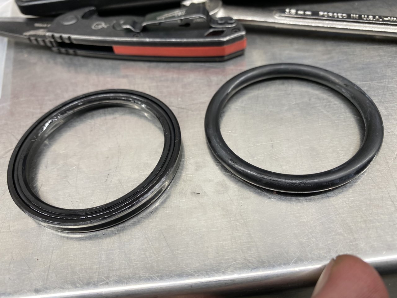

    Here’s the mess inside the bell housing from the leaking Clutchmasters hydro bearing.
    Replacement oring is a round oring vs. the square seal that it was originally built with.
    The outer dust/wipe seal is just that. No fluid sealing happening at that point.
    Machine shop still has my flywheel. Hope to have it back tomorrow morning.
    I also had a shorter pressure line made. No pics yet.

    Did you already ask them why they sent u a o ring vs the square one ?

    It seems the original one maybe was round and got distorted??
  12. Mar 27, 2020 at 7:31 PM

    No, it was definitely square on purpose.
    Yes, I did call Kevin when I got it all apart. He assured me that the two styles are interchangeable.
    Looking at the old one; There’s no obvious problem with it. Wasn’t twisted or pinched.
    It went right back together with the new, round o-ring no problem.

    interesting, maybe they stopped using the square ones because of leaking issues like you had

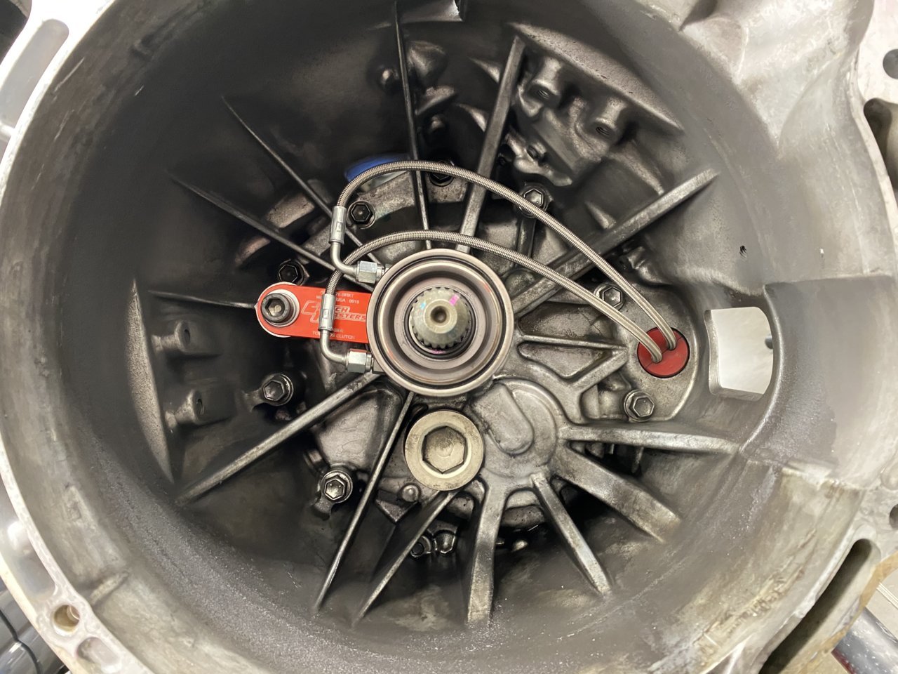

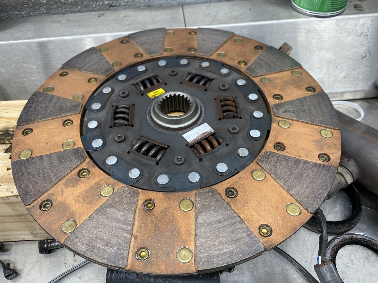

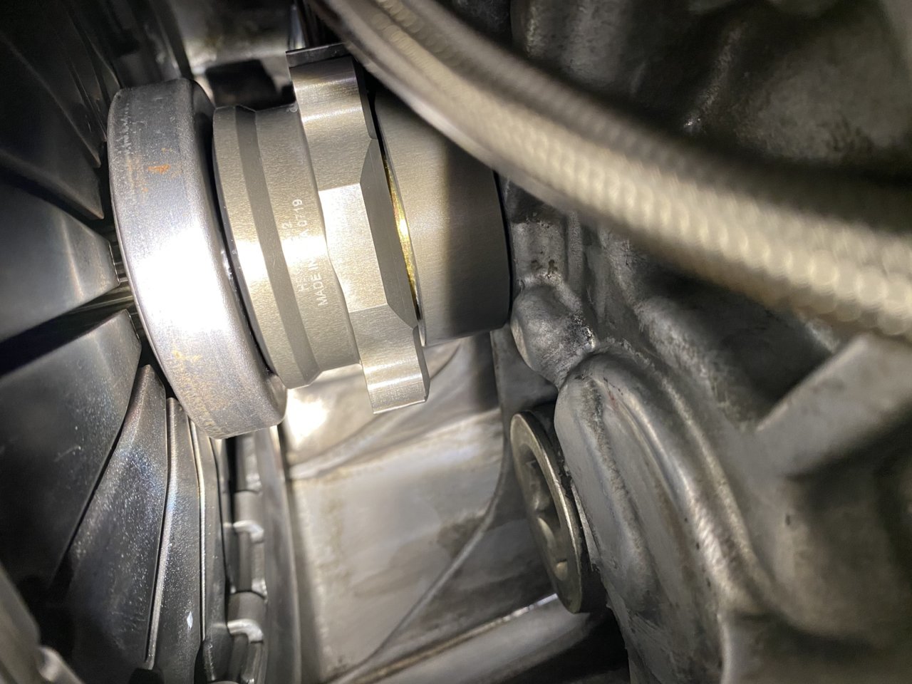

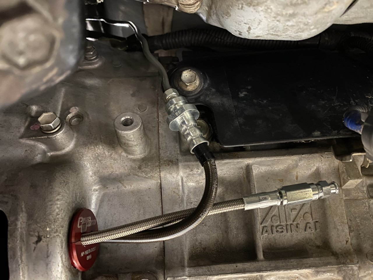

    Random pics from re-install.

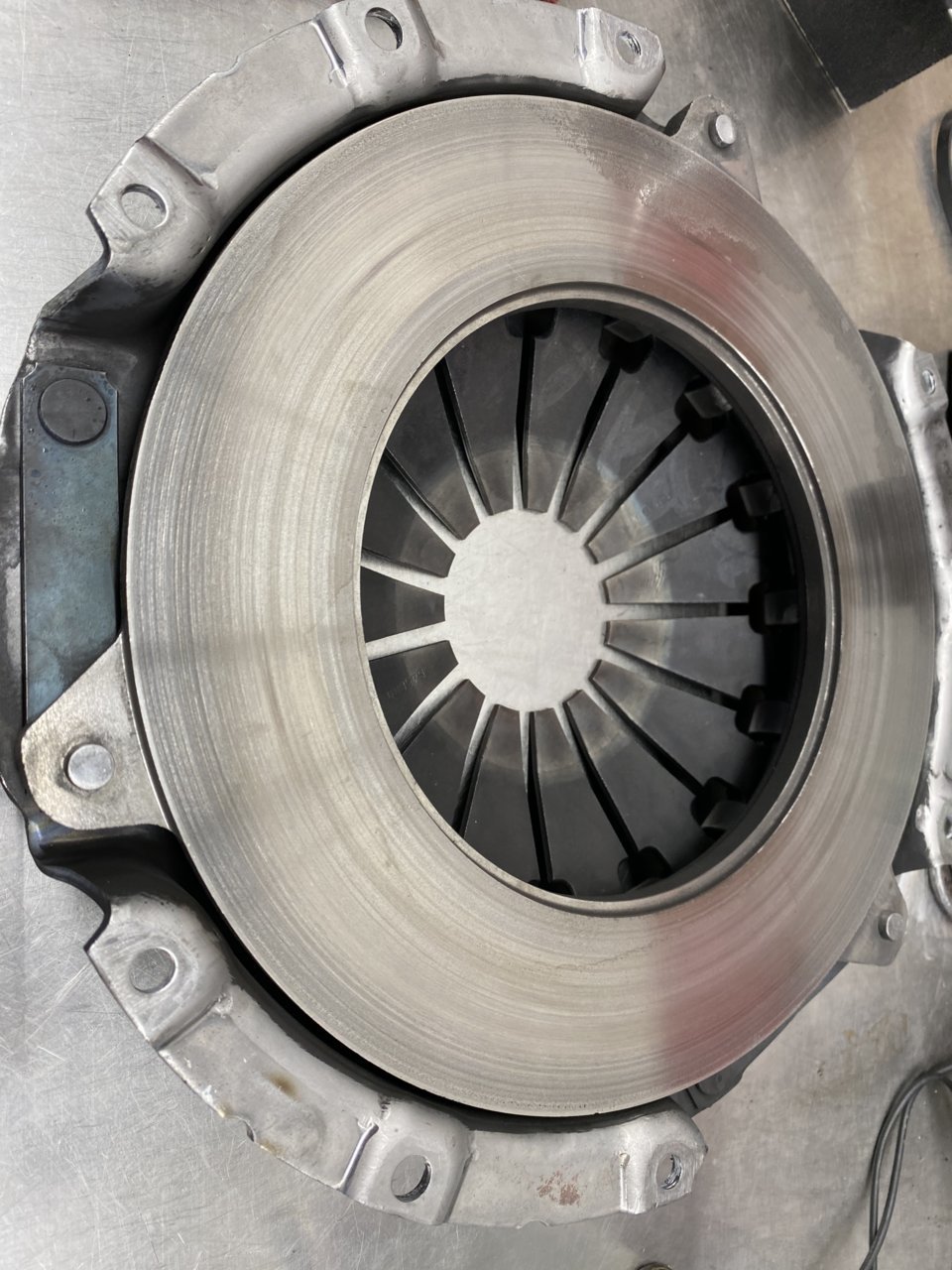

    The disk and pressure plate showed basically zero wear.

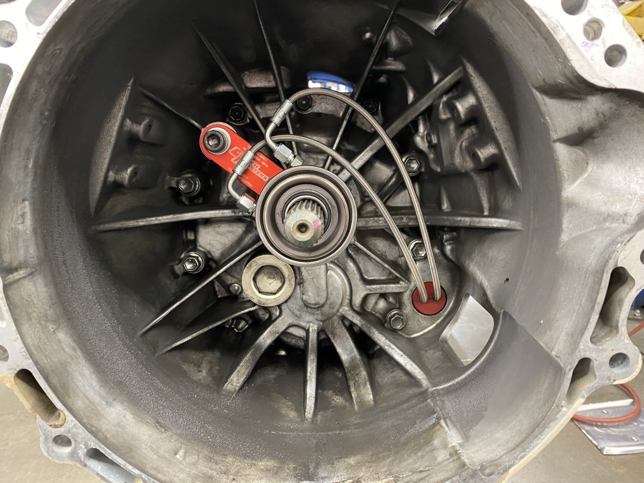

    Since my flywheel has been machined a couple of times, I went with a .060” shim behind the bearing. It was the slimmest in the shim kit that Kevin sent. I like the spacing I ended up with. This pic was taken before any hydraulic pressure had been applied (bearing fully seated)
    Here’s the shorter pressure line that I had made. It connects directly to where the OE hardline would normally connect to the damper/accumulator. This pic was taken before I wrapped these lines in a split piece of heater hose to protect them and to prevent any vibrations. I then covered them with the cover plate that lives here.
    I’ve only driven it a few miles since. First impression is that the clutch reacts a bit quicker with the shorter pressure line. Before, with the super long pressure line, the pedal was very slow to come back up.
