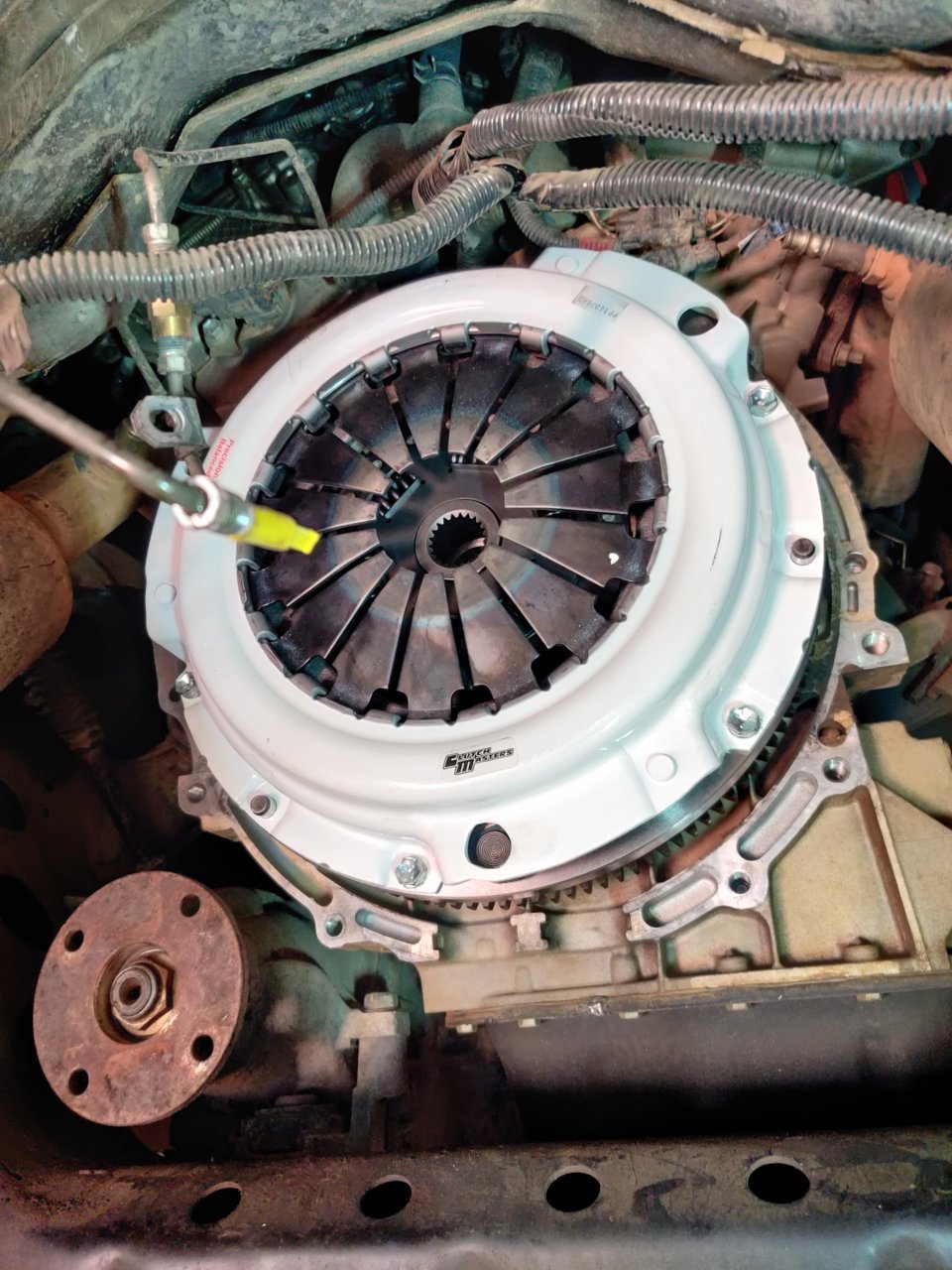

    Awesome pictures . Thank you for posting them up . How close is that bearing to the pressure plate fingers ?
    Are you running accumulator delete ?
    I am working with the manufacturer of the bearing . When we are done , that bearing is NOT going to touch the pressure plate fingers when your foot is off the clutch pedal . Thats my goal
    General Motors uses the same darn transmission in the Camero and they introduced a clutch release bearing that doesnt touch the pressure plate fingers .
    This is the only fix for the dreaded release bearing squeal as well as a partially applied clutch in our Toyota Tacomas .

    As I installed it, before pressurizing anything, the bearing is roughly .060-.070” away from the fingers of the pressure plate. Once pressurized and in regular use, the bearing only retracts (I should say “gets pushed back”) as far as those fingers push it.
    So, after having it apart and seeing how it works, as well as and watching it in action. To answer the question that most here are likely interested in; Yes, the bearing it always contacting the fingers and therefore spinning. Even when the pedal is up.

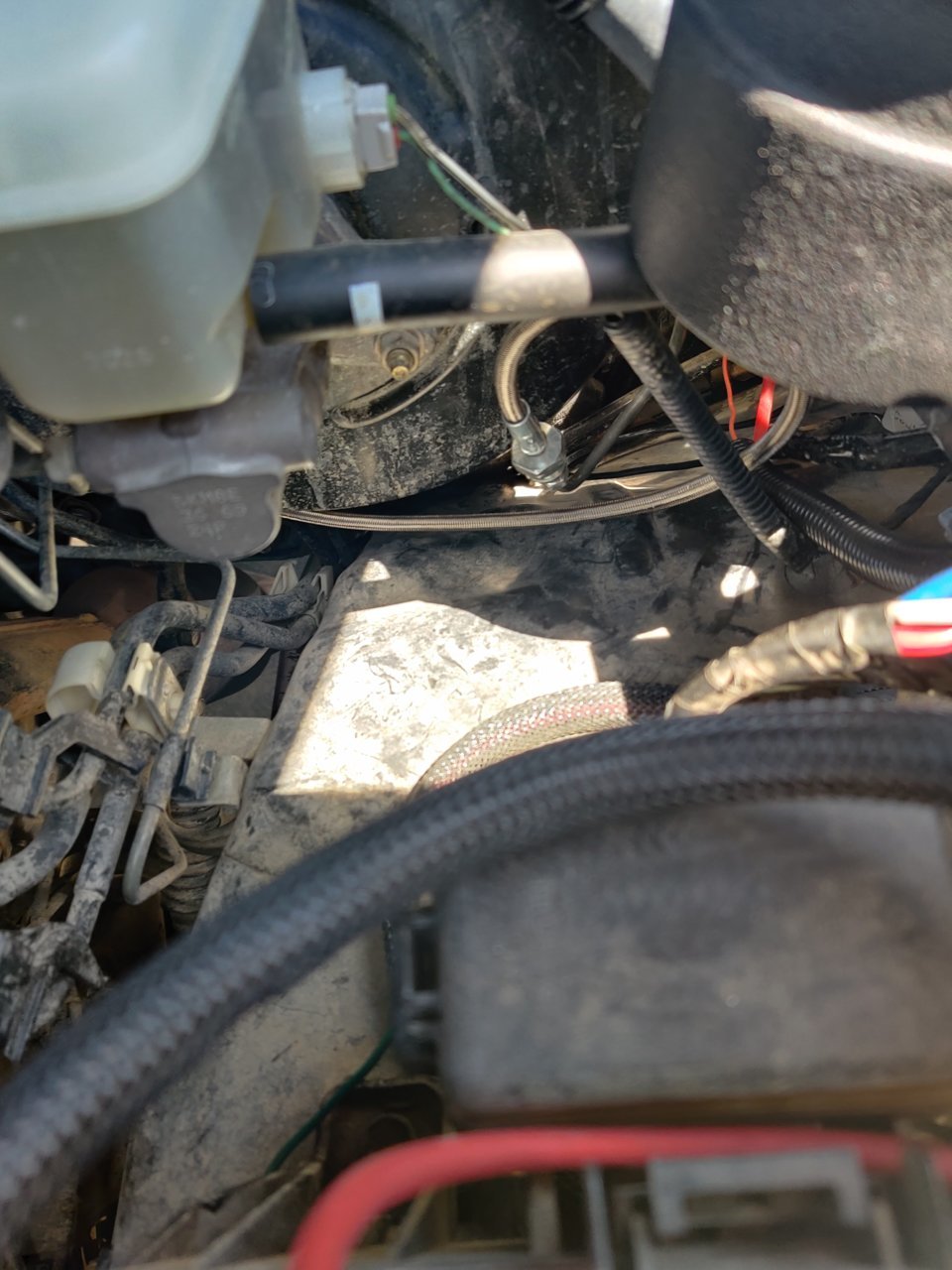

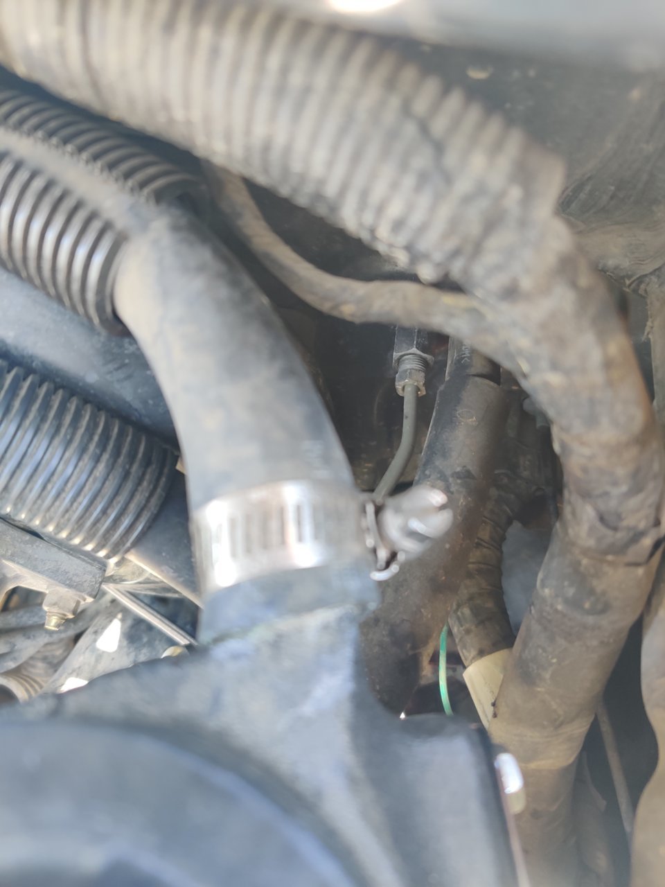

    can you take a pic of where you attached the braided line up at the firewall?

    I can get a picture tonight after work.

    Its right to the left of the master cylinder.

    when standing at the front bumper looking at the firewall. it will be to the right. just follow the feed hose off the brake fluid reservoir to the firewall. the clutch pressure line is right next to it. or follow the hose off the clutch reservoir. depending on the setup of your vehicle.

    Here are the pics that were asked for.

    I attached mine to the fire wall using a short hard line I took off the slave. But if you get a 10x1.0 by 10x 1.0 male to male adapter you can hook up the line right to the fitting for master cylinder that sticks through the wall

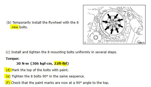

    Finally got around to taking mine in to get it installed. Drove about 20km home. Pedal didn't need any adjustments. Pedal feels a lot lighter and shifts much smoother. Happy so far.
    Turns out that Toyota busted a flywheel bolt and left it first time i took it in to get RMS and TOB done under warranty.

  16. May 22, 2020 at 6:19 PM

  18. May 23, 2020 at 8:07 AM
    #598
    BillDaCat8
    BillDaCat8 Well-Known Member
    Jun 25, 2017
    #222348
    1,915
    Jake
    PHX
    07 4x4 Access Cab M/T
    My shit is all stock.
    Those flywheel bolts are a one time use stretch bolt. They should be replaced every time they are removed.
    Part # 90105-10294
    dnl_tacoma, Norton and Torspd like this.

  20. May 23, 2020 at 10:15 AM
    #600
    Torspd
    Torspd Tor-nication
    Sep 18, 2009
    #22958
    26,451
    Tor
    The Great America!
    MMVI 4.4L 4x4 Access Cab
    Torspd Custom Turbo kit [] Borg Warner 9180EFR Turbo [] Haltech Elite 2500 [] TiAL Q BOV [] TiAL V44 Wastegate @ 15psi [] CP Pistons [] CP Carrillo Rods [] ARP Head studs [] ARP Main Studs [] ARP Header - Head Studs [] Ported Heads w/ 1mm oversized valves intake/exhaust [] Brian Crower Forged Stroker Crank [] Darton M.I.D. Sleeved Block [] Kelford Camshafts [] Torspd 160* T-stat mod [] APR Large Fuel Rail [] Walbro 460 LPH E85 Fuel Pump [] FueLab FPR [] APR T56 Conversion Kit [] KP RACING Built T56 [] McLeod Racing Custom Twin Disk Clutch [] One Piece Aluminum Driveshaft [] MGW Shifter [] Custom lowering kit [] Ohlins Front Coilovers [] QA1rear shocks [] Custom Ron Davis Radiator [] Dual SPAL Electric Fans []
    May be a repost, but www.urdusa.com sells ARP flywheel hardware. A worthy addition if getting in there.
