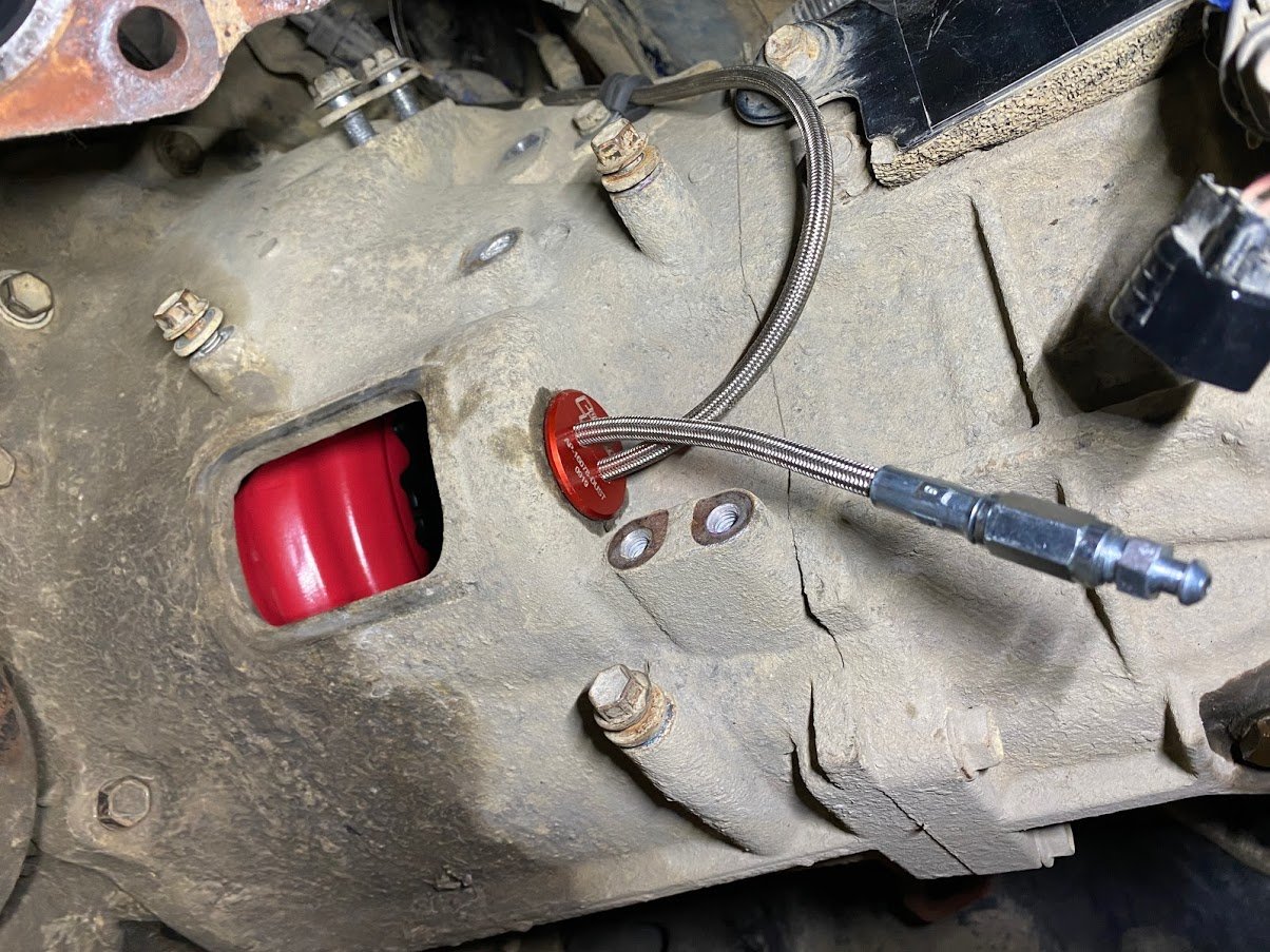

    Just installed the kit.
    Need to figure out why the pedal is soft and slow to return; maybe it could use some more bleeding. Which is strange because I already put 2 liters of DOT4 through the clutch line at 20psi.
    Also going to look up what mounting clamps I can use, maybe bolted to empty screw holes on the transmission, to hold the stainless line better and away from the exhaust. Maybe even some custom heat shields.
    6 gearT444E likes this.

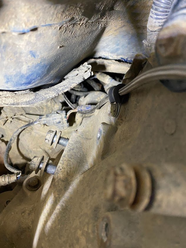

    Bleed, bleed, and bleed again. I did mine 3 times before the pedal feel came back to "normal"
    Just use a few of these on some of the old accumulator or slave cylinder mounts, worked great for me and already had them laying around. No need for a heat shield if they are close against the transmission. IMG_2999.jpg
    Chris(NJ) and lo2hi like this.

    Exactly. I've seen those loops at hardware stores and figured they might work. Will need to find the right size.
    I kept my old slave cylinder mounting bolts in hopes of later on using them to screw on loops when I buy them.
    I ziptied the bleed point to the other line like the instructions said, and put a rubber screw cap on the end I had laying around.

    Yes they work perfect, cheap and easy. Don't remember the size off hand but want to say 5/8" maybe? I have the TRD offroad 6 speed to the clutch reservoir is separate from the brakes entirely. Even if you didn't I believe they are a split reservoir so if you ran out of clutch fluid you wouldn't run out of brake fluid. My reservoir was very small (maybe 1/2 cup), so I bleed 3 times with a buddy filling the reservoir, and I'm underneath draining. If you aren't using the vacuum bleed method it's important you don't leave the bleeder screw open once pressure dissipates otherwise you can suck air back in.
