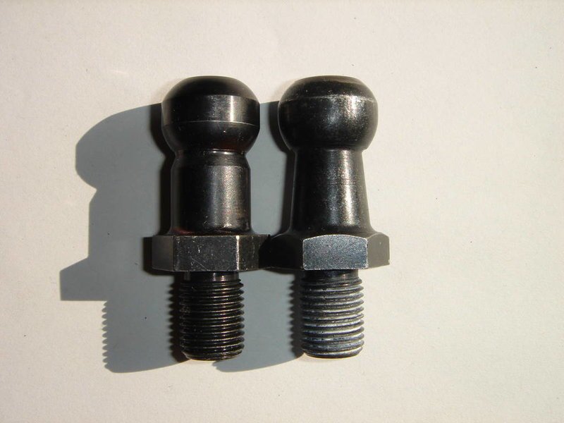

    Hello everyone, I just replace my flywheel, clutch and pressure plate with URD stage 2 and heavy flywheel combo with aisin clutch release bearing in my truck a few weeks ago, after driving it for a while i noticed when things got hot i could hear a chattering noise coming from my transmission area when the clutch pedal was release and motor was at idle, so i did some research on the forums and found the TSB squeak/chatter from USA Toyota and noticed it says to replace the clutch release bearing (which it has been in with newer style with the current clutch install ) support fork pivot ball and the slave cylinder. So i so i bought the upgrade version of the salve cylinder and installed / bleed it myself and I noticed it helped some but the chatter would still come back after everything heated up again but not as bad as it was before the new salve ( also no noise when motor/transmission is cold FYI ). So the only thing is left to replace is the pivot ball which means dropping the transmission again to have it installed and hopefully that would finally fix the chatter noise. I took my truck back to the transmission shop yesterday that did the install so they could listen to see what they thought the sound was coming from and basically said it sound normal and couldn't hear it. Which is not true because i hear it myself since i have owned the truck for 11 years now and know exactly what noises it makes.
    My questions:
    1. So my question is now is it going to be worth dropping the transmission again to replace the fork support to see if that finally fixes that chatter noise?
    2. Should I replace the fork its self with a new one to make sure there is a tight fit with the new pivot ball ?
    3. Or should I save the money from replacing the clutch fork and fork support and go the route and purchase the Clutch masters N16078-H (TOYOTA TACOMA AND FJ CRUISER 6-SPEED RA60 / RA61) ? So then it should completely remove and chance of chatter now or in the future when things start to fail with the flawed clutch fork system ?
    My transmission shop said it would only take a couple hrs to drop the transmission again since it was out already and things will go quickly, (i only paid $500 Canadian to have the everything done the first time) So it would be fairly cheap to do have the fork support installed. ( I have thought many times to do the work myself ) but for the couple hundred dollars Vs my time and doing everything on the ground on my back is just some times not worth it lol, or just live with the noise until something else fails? I just hate knowing that the fork it self will do damage to the bearing sleeve over time ( also the mechanic said the sleeve looked good when he did the clutch install )
    Picture of the old and new fork support ( found on the forums )

    The pivot ball won’t cause any noise. Not worth the trouble to drop to replace it. If you are set on getting rid of the noise, get rid of the stock setup. Install can be done in a day and then you’ll have a few hundred for beer and pizza.

    Thanks for your advice. I am really leaning towards buying the clutch masters hydraulic bearing kit.
    So what is it then making the chattering noise? I figured the fork it self was rattling on the end where the fork connects to the support pivot ball end because or bad design and wear and tear ? When i used a screwdriver to listen to the side of the transmission it was loudest between the mid housing to the back end of the bell housing basically just about the salve cylinder.
    It goes away when the pedal is push in or when trans is cold as i mentioned.

    Not sure if you miss read my first post but i don't have a squeak noise it is a chatter sound. I had the squeak noise once before (around 30K Km )from my original bearing when i bought the truck brand new but Toyota replaced that many years ago under warranty. This is a completely different sound Like chatter ( two pieces of metal hitting each other ) this was never there before replace my clutch and everything few weeks ago. But now after that install this chatter noise has appeared.
    Also I haven't seen no new fork design or replacement part numbers in my searches.
    The TSB only replaces the clutch bearing, fork support and slave cylinder.

    I may have misread your first post I apologize, but regardless that does not change what I'm recommending
    Toyota issued the TSB (T-SB-0365-10) and it increases the spring length and pressure of the release cylinder (slave cylinder) to supply constant pressure on the throw out fork and thus bearing against the clutch pressure plate. I apologize, I mis typed above, meant to say fork pivot not fork. The reason for that noise is likely you disturbed where it was resting when the clutch was replaced. Did the shop replace the throwout bearing with the new part number (31230-60241) or the original offender?

    ( also the mechanic run his own transmission shop and he is a old friend which i trust) Yes the mechanic used the same bearing part number as was used by Toyota the first time the bearing was replaced. So both bearing replacements used 31230-60241, the only thing that wasn't or hasn't updated to the new version of parts is the pivot ball "fork support" 31236-35050 which leads me to think its lose enough inside the cup where the ball ends goes because its using the older version and causing the chatter noise probably from the bearing being maybe slightly unbalanced and shaking the fork, (i looked at the bearing while dust cover was off and didn't noticed any unbalance load on the bearing. I can feather the clutch pedal in and out a few inch several times in a row then bring it back to the resting position while the truck is idling and some times the noise gets better or worse when slave cylinder, clutch pedal, clutch fork, clutch bearing etc are all in there normal idle positions.
    Part used couple a weeks ago
    Part used by Toyota several years
