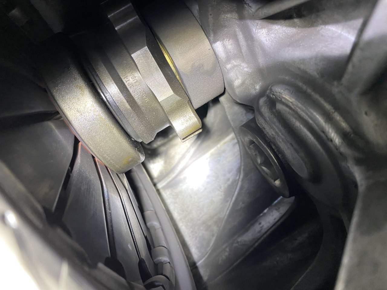

  12. Sep 19, 2020 at 12:11 PM
    #692
    TacoTuesday94
    TacoTuesday94 Well-Known Member
    Jul 26, 2017
    #225061
    253
    Ry
    Huntington Beach CA
    Supercharged 4.0 2010
    UPDATE: Took the truck into my mechanic and he agreed there was something wrong. Before having to pull the trans to put the stock bits back in, he tried a very thorough bleed. It does feel better now with no pedal sticking. I guess air may have formed in the line or something (not really sure how? I really don’t think I could have boiled my DOT3 with normal daily driving?) Hopefully it’ll be good for another 30K. But honestly I don’t have a lot of faith in it, which is a pretty shitty feeling.

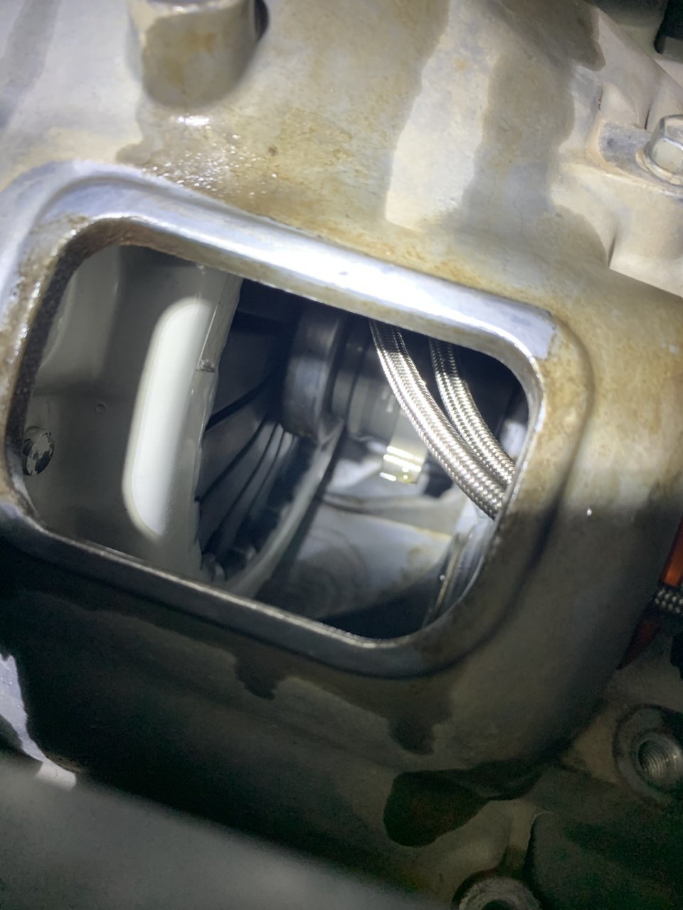

  13. Oct 17, 2020 at 7:48 PM
    #693
    BillDaCat8
    BillDaCat8 Well-Known Member
    Jun 25, 2017
    #222348
    1,915
    Jake
    PHX
    07 4x4 Access Cab M/T
    My shit is all stock.
    So, I put the truck into the air tonight. Another pressure bleed. Pedal has been super inconsistent (like every shift). Also going to try switching to DOT 5.1 Fluid. Sucked the reservoir dry. Added the new fluid. Hooked up the pressure bleeder and then cranked it up into the air and got underneath. I remove the access cover and see this through the inspection hole:
    Yeah. Really. This motherfucker is leaking AGAIN!
    TacoTuesday94 likes this.
