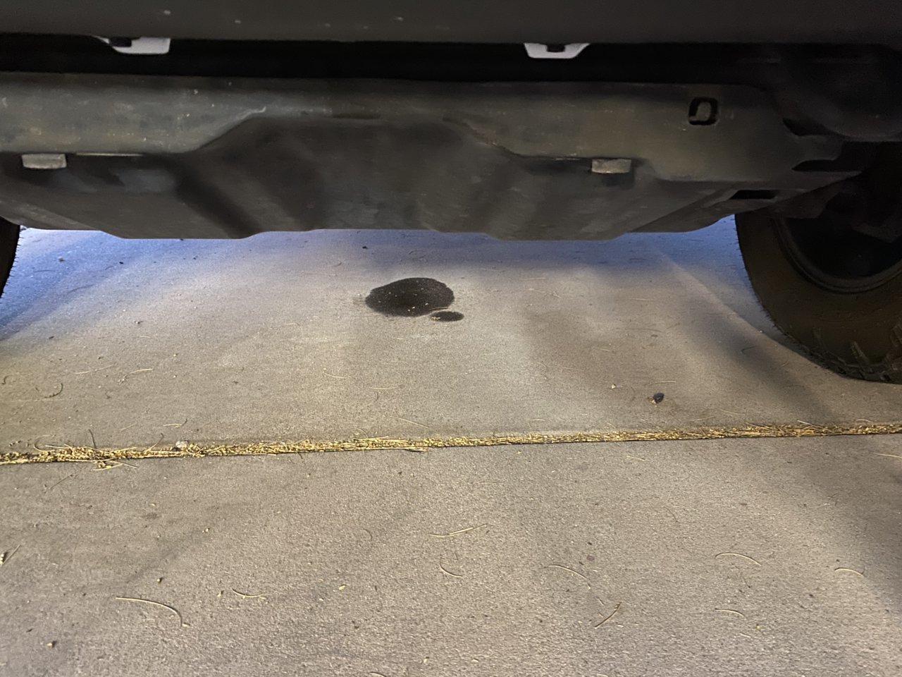

    I agree about the pedal feel being “all over the place”. That’s exactly how I’d describe the way mine feels.
    That “slight” leak will get worse. Mine was “slight” mid October. Now there’s drips under the truck each night. I’m parking in the gravel on the side of the house now and filling the reservoir regularly.
    Still no response from Clutchmasters from my email I sent to them Friday.
    Anyway, for you, I suggest a new bell housing and go back to a stock-ish setup with the quill sleeve and bearing from PDM. Not cheap. I know.

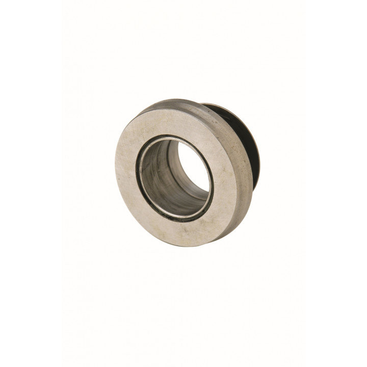

    Since we are flinging out fixes , Here is my fix . I already know it will work . I just need a truck with a 6 speed to fab it up .Using the factory Aisn or Luk clutch and the upgraded factory slave with upgraded factory ball, install a shallow " self centering release bearing " with a" Wide "contact face and a " Grease zerk " with quality seals to prevent contamination . sorry picture doesnt show the grease zerk or the remote grease line .Self centering bearings compensate for out of round . Your factory bearing has a narrow contact face so I may have to compensate with heavier hydraulic assist . Accumulator delete is a must . you guys dont need a cushion .The factory bearing is not self centering and its open meaning all kinds of crap can get in it .
    This bearing will Not be pro-loaded against the pressure plate fingers " period " . Going to be old school set at 3/8" air gap . Go ahead and shock load the shit out of it . No more wore out quill .No more bearing pushing through the pressure plate off center and no more squealing release bearing and no more driving around with a clutch thats partially applied . I am not re-inventing the wheel here . This set up worked for well over 100 years . Let,s see what the critics think lol

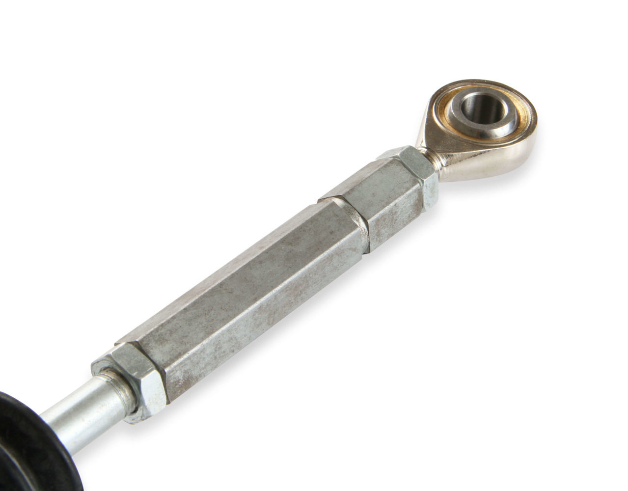

    Remove the factory master cylinder pushrod from under the dash and install the larger adjustment rod . I will also place a return spring on the slave as well as a threaded step to maintain release bearing gap .

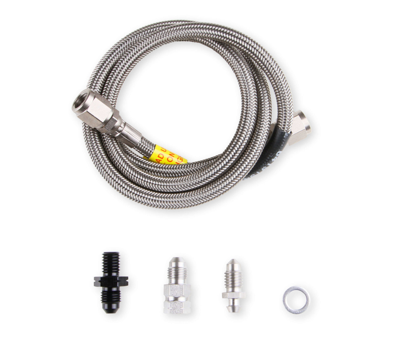

    This is going to be the remote grease tube that connects to the release bearing .You can lubricate your clutch release bearing at the same time you grease your universal joints using the same grease .

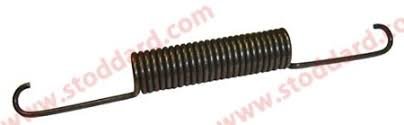

    Release bearing return spring

    There is one downfall to making this clutch completely adjustable . You will have to make occasional adjustments to maintain 3/8 release bearing gap . As the clutch disc wears in , the fingers on the pressure plate move closer to the release bearing.
    If you dont make yearly adjustments per say , you will end up with the same garbage you have now .
    Due to lack of adjustment clearance with the factory junk , its difficult to set the air gap adjustment on the release bearing and maintain it . The factory bearing is far too long to make it function with air gap properly . This is a cheap work around that will eliminate all the issues with the Tacoma clutch in the RA60
    To make the clutch masters hydraulic slave function properly , you will need to place two large return springs on the slave cylinder bearing support and mount the springs to the transmission case . This will aid in moving the release bearing away from the fingers of the pressure plate .
    With this being said , a larger master cylinder may be required to accomodate the larger release bearing face and the opposing return spring set
