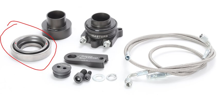

    Too big of a gamble for me......I got a CM hydraulic bearing new in the box, still packaged how it came. I’ll sell it if someone wants it. Will probably go up on the for sale page soon.

    Went out to the truck this morning. Game over. Clutch pedal flopped to the floor as soon as I touched it and stayed there. Reservoir is empty. Truck is down.
    Still zero response from ClutchMasters.

    Whoever has a CM kit that has not installed it, I need some measurements on the bearing itself. Need id and od and need to know the measurements between the two tiny points I've drawn on this bearing in the pic. See any numbers on the bearing at all? That would be super helpful as well.

    They just sent me an Oring. Interestingly, It was of significantly different design than what came out of the bearing. I posted that up before. In this thread I believe.

    I wouldn’t be surprised if you had a defective bearing/unit. Sucks CM won’t get back to you. I think you have said you emailed them but have you called?

    Thinking of getting your own bearing made?

    Something like that. Yeah.
