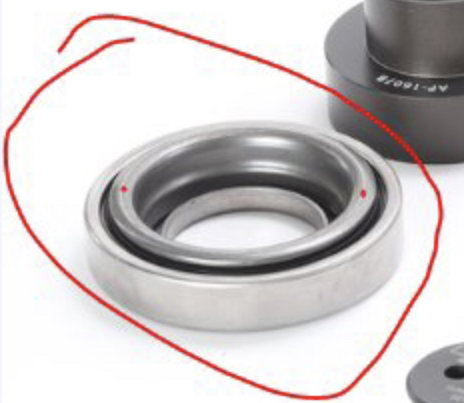

    I’m actually just looking for the bearing itself. 68-75mm OD and 40mm ID with a concentric contact face. Needs to be of the highest quality of course.

    Yes. I’m sure it’s a bearing for a different application that they’re using. My bearing is fine. But, it’s still installed in my truck which is broken down in my driveway. I need another one or something similar/better for the setup that I’m trying to put together. I’m documenting that in another thread.

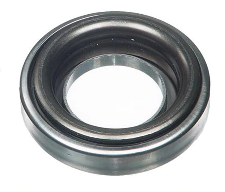

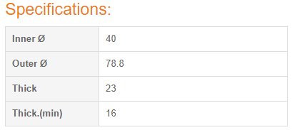

    After spending the bulk of my morning searching; I think I've found my bearing. Looks like it's intended for a Nissan. We'll just keep that tidbit on the DL tho.
    National 613015
    Nissan 30502-45P00 or 30502-30P00
    Koyo RCT40SA.
    I'll have it in my hands tomorrow.

    Would you mind having a look at the bearing on it for me? Pretty please?

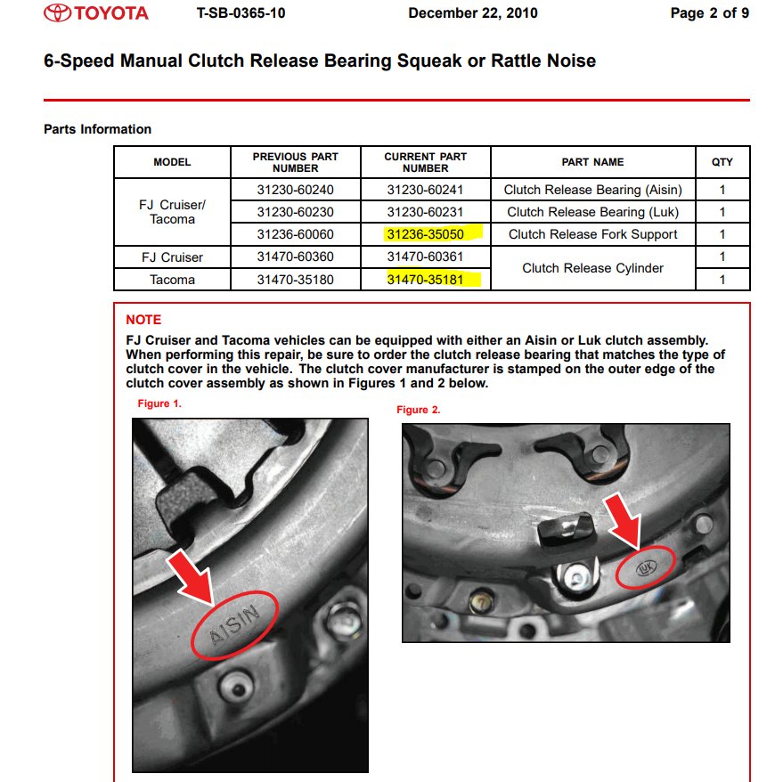

    I wish I had a truck in front of me to answer your question .
    At this time , I beleive Clutch Masters has the best aftermarket design , however , judging by the customer service and quality of parts , I would be skeptical of installing the CM assembly without some serious tweaking .
    I would like to see the factory release bearing dimensions . Does anyone know how much difference there is between a LUK clutch release bearing and an AISN clutch release bearing ?
    Below is the PDF showing the upgraded master cylinder for the factory clutch application . The TSB is part of the clutch pedal squeek issue . This TSB has nothing to do with the clutch masters aftermarket install but also changes the clutch master from plastic to metal

    Of course man. I saw the post last night and forgot.

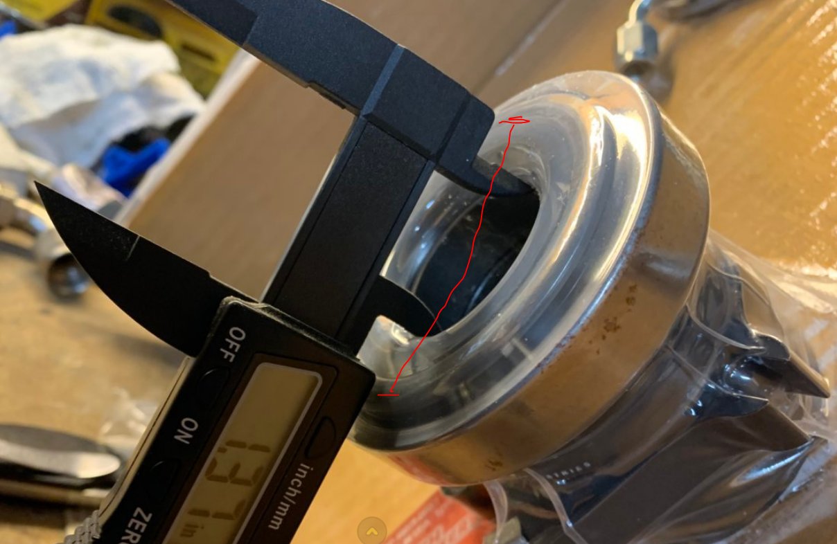

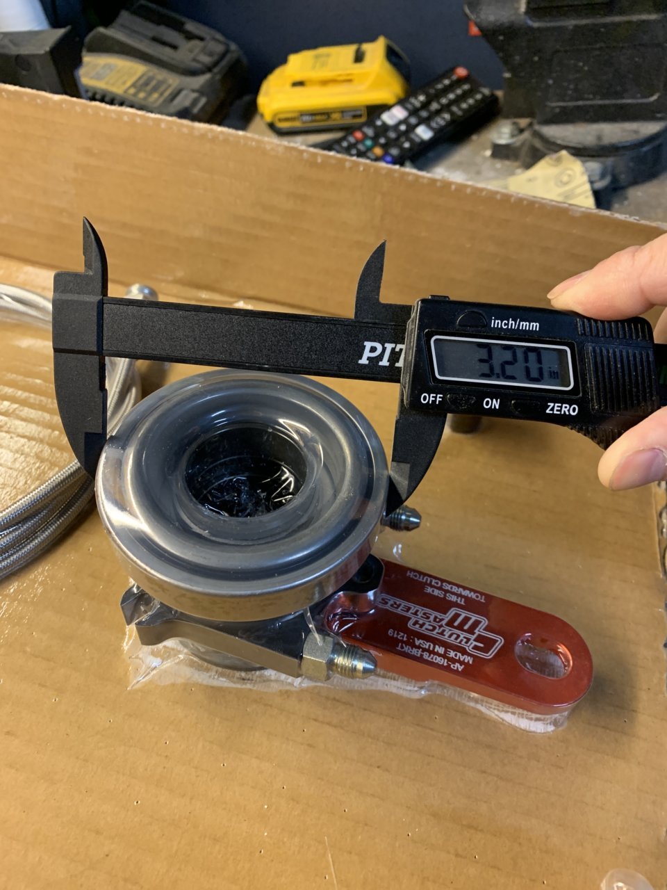

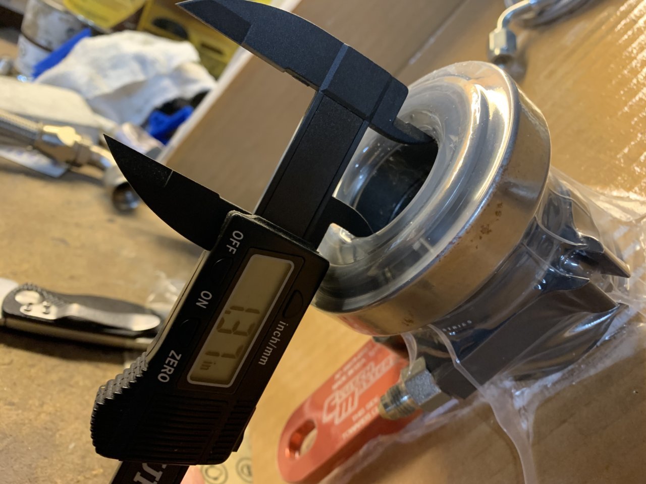

    Ok Jake, incoming......ID, hope I did this right. 1.37”

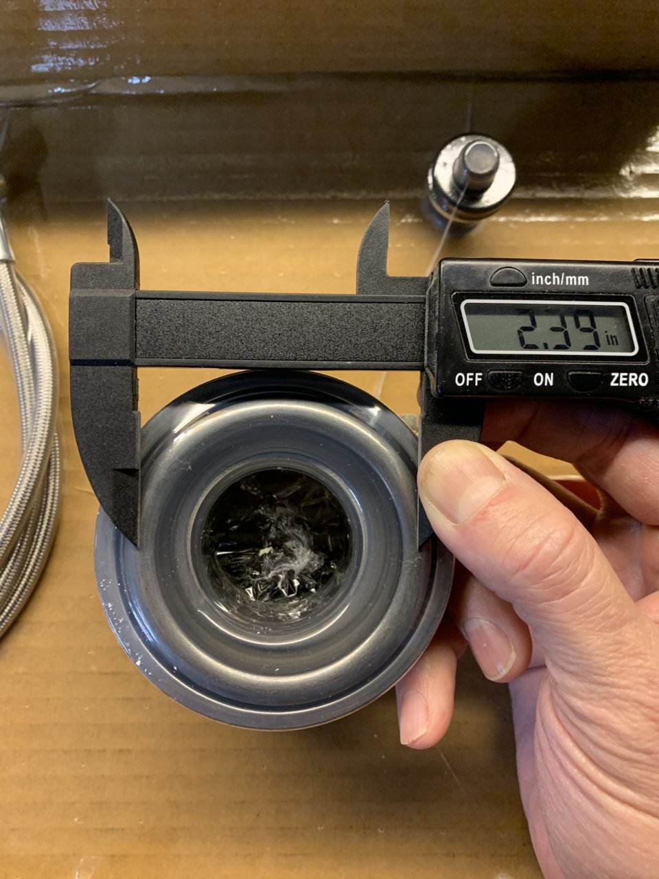

    My shit is all stock.
    How wide is the contact point where it touches the fingers?

    Center of the 2 red dots , 2.39”

    Awesome. Thank you.

    2.12”

    I knew this harbor freight measurement tool would come in handy at some point
