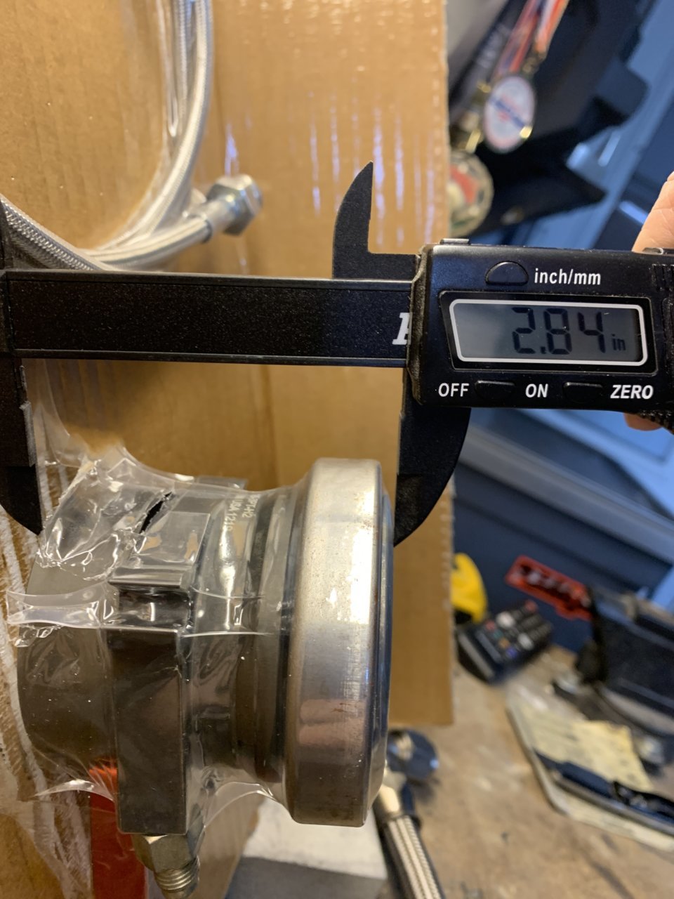

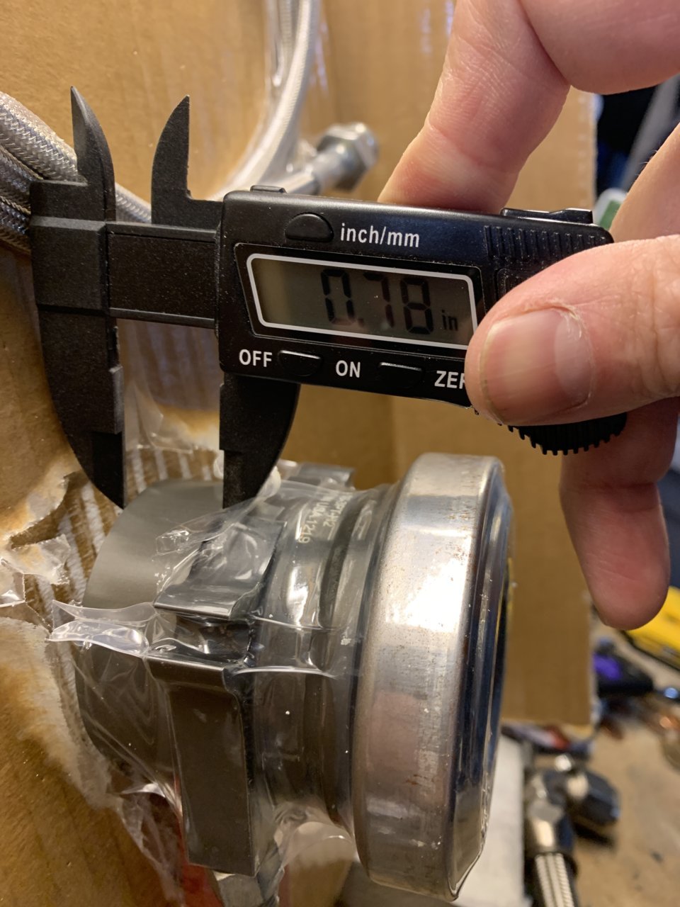

    Y'know. See if you can measure the overall height of the main unit. From the cardboard to the contact surface. Lay a straight edge across and measure that distance.
    There's a spacer in there too. Roughly 3/4" thick or so. See if you can get a number there too plz.

    No Kidding! Thank you Juan.

    No worries. That’s what the site is all about. If you need anymore or redo any of the ones I sent to double check just ask. It’s no bother.

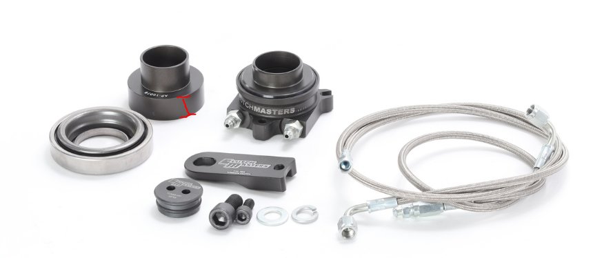

    @BillDaCat8 what is your goal with the new bearing here? Not sure if you've already said or not. Are you trying to fix the ClutchMasters flaws yourself, or going back to an old setup? Its so hard to believe that this issue has been widely known for years now and there is still no definitive fix.

    I am working on something similar to this. But certainly will not be using any CM stuff. I’m in the “rounding up parts” stage. I will post up what I’ve done once I’m sure it’s all going to work nicely.
    Finding that bearing was a first step. Now that I’ve got it in hand; I’m still not 100% happy with it. I’ve ordered a few others to look at and measure. They should be trickling in over the next few days.

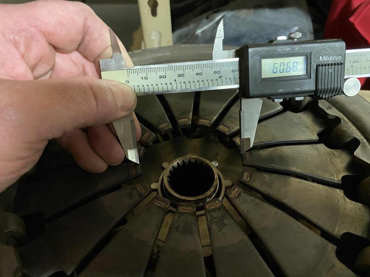

    Todays findings...
    The bearing CM is using with these kits is too small in diameter. I went and found my OE clutch and flywheel today and bolted it all together. The OE bearing contacts the fingers of the pressure plate in a 68-70-ish mm circle. Yes, the pressure plate is bolted down to the flywheel in these pics.
    The bearing they’re using measures 61mm (2.39”) at the contact point (fulcrum)
    This means that their bearing is just barely catching the tips of the fingers of the pressure plate.
    Hence my wanting to use something else.
