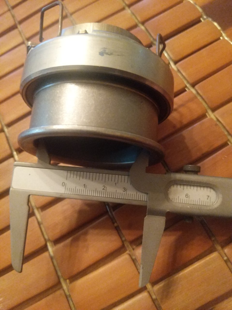

    2015 Tacoma Sport 4x4 access cab 6spd w/ tow package
    So this problem is inevitable? Just a matter of when?

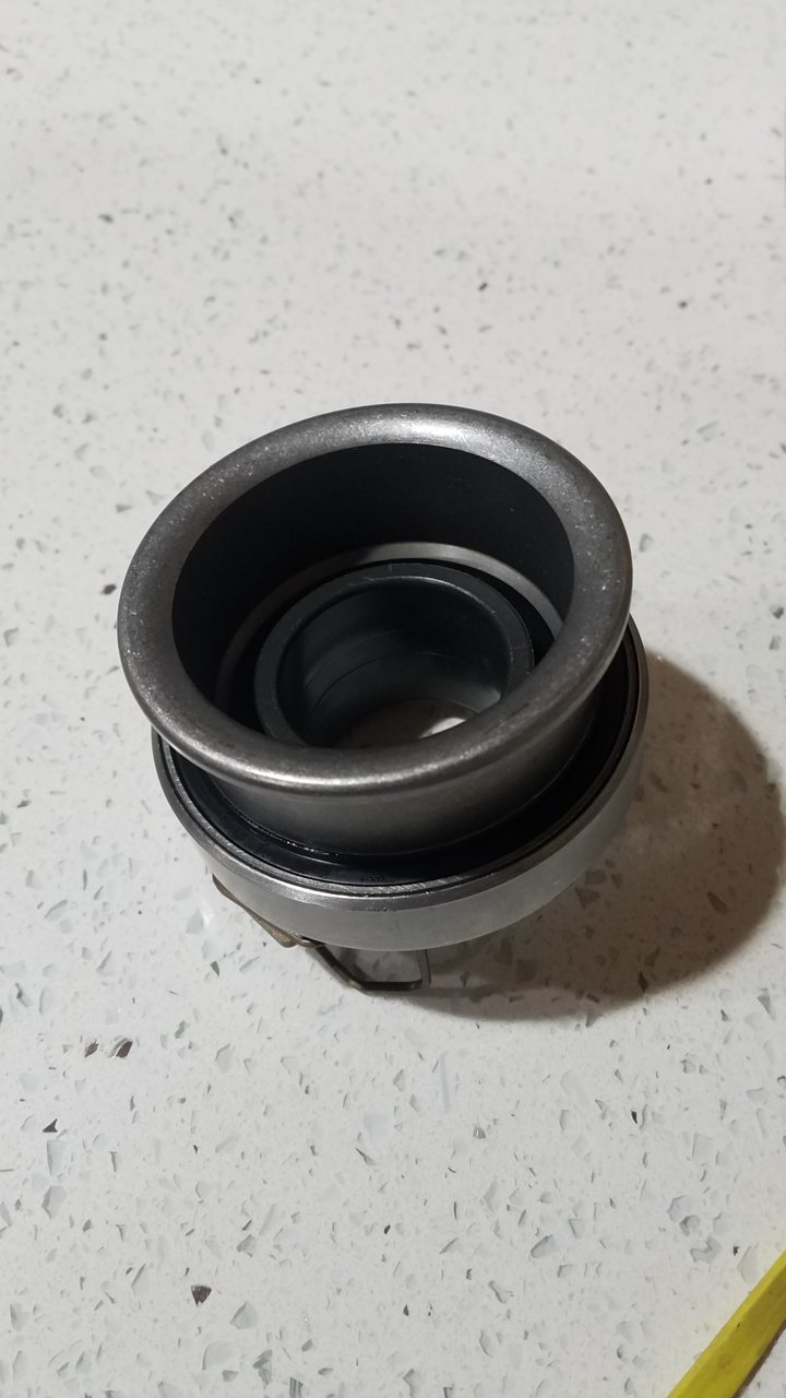

    most of the posts I read have been from ‘08’s and ‘10’s. Just when I thought I was safe with a ‘15, I saw some third gen owners with the noise.

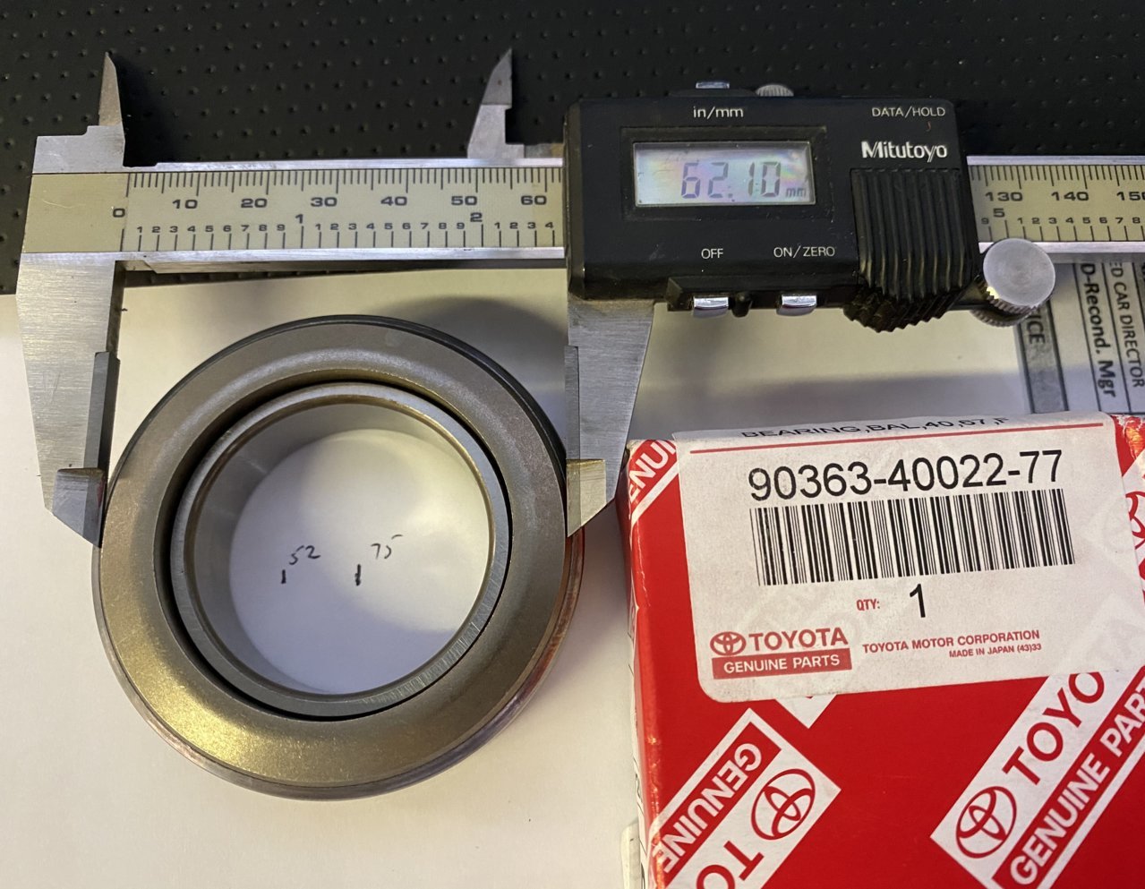

    #802
    TheFang
    TheFang No Big Deal
    Jul 15, 2014

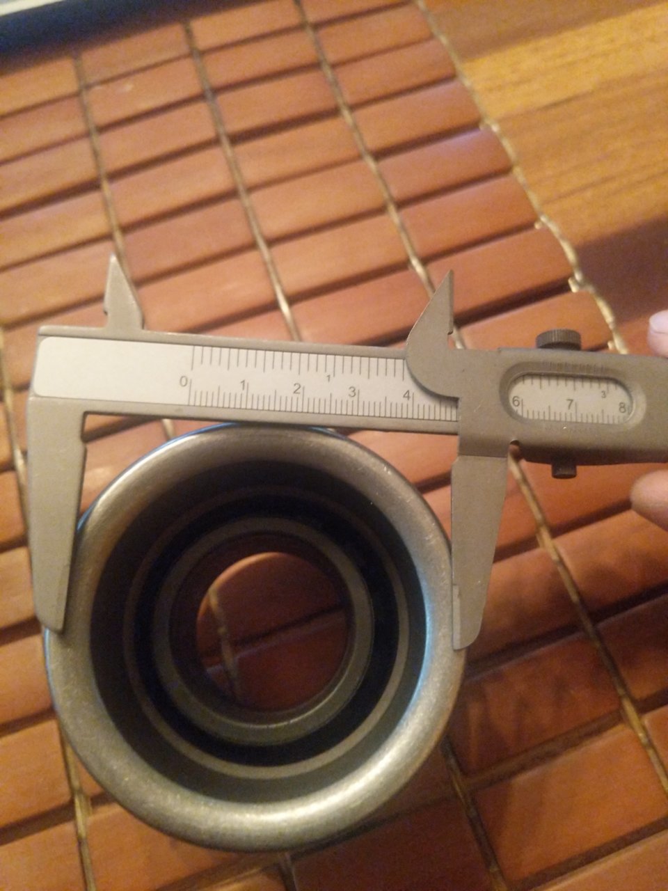

  12. Dec 15, 2020 at 6:24 PM

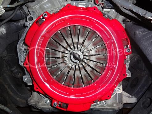

    wrmathis
    wrmathis Dark Lord of the Sith
    Sep 10, 2008
    #9126
    9,445
    Bonaire, GA
    2006 Tacoma TRD OR 4x4
    parts and stuff
    I have the URD twin disc clutch and pressure plate and the fingers on it look like they are longer than stock. I don’t have a measure meant but this is a pic of what it looks like with clutch alignment tool installed

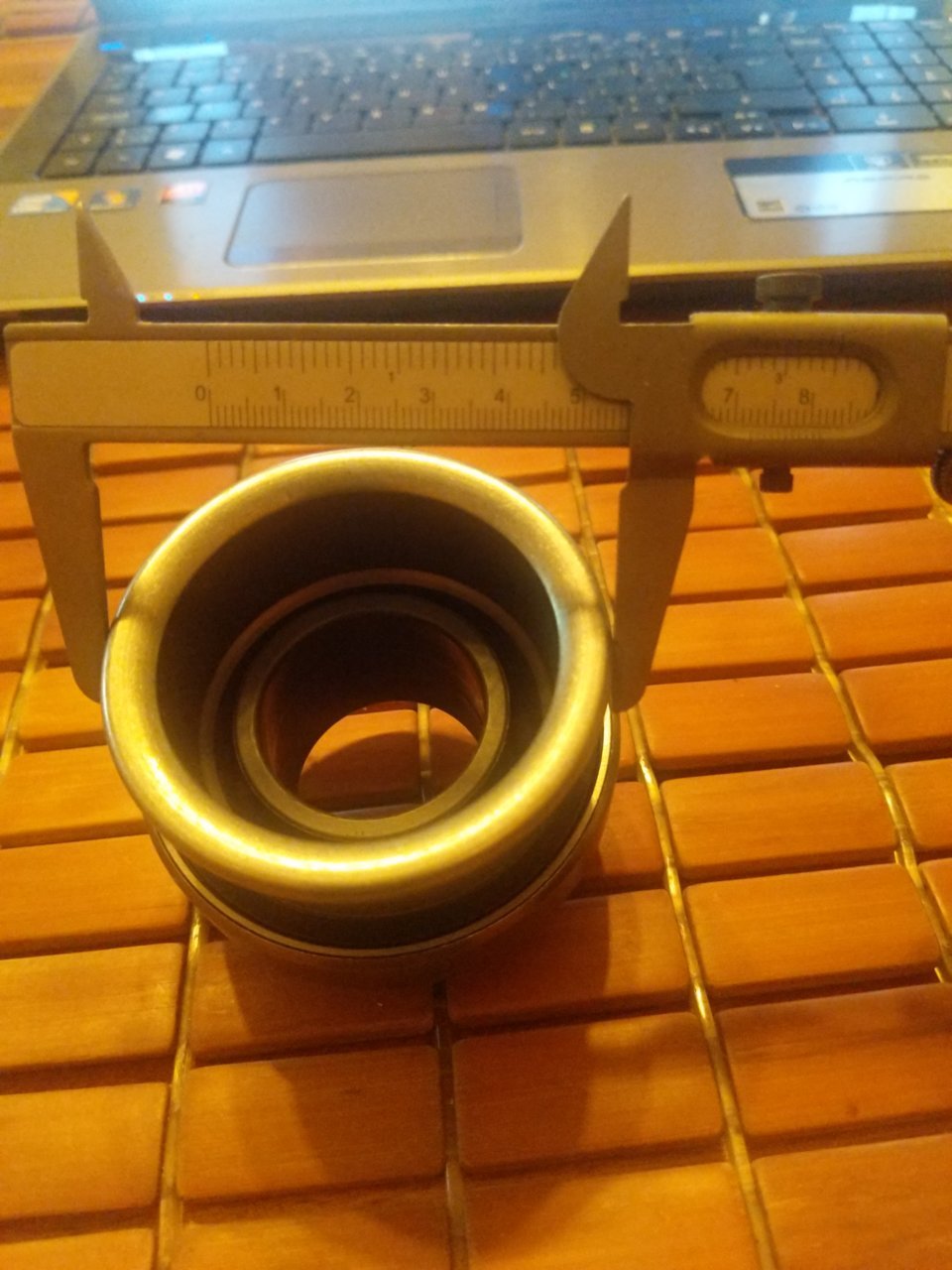

    I have one that came with my URD flywheel... I dont own calipers, so a ruler would be the best i can do... no numbers or markings on it anywhere
    BillDaCat8 likes this.

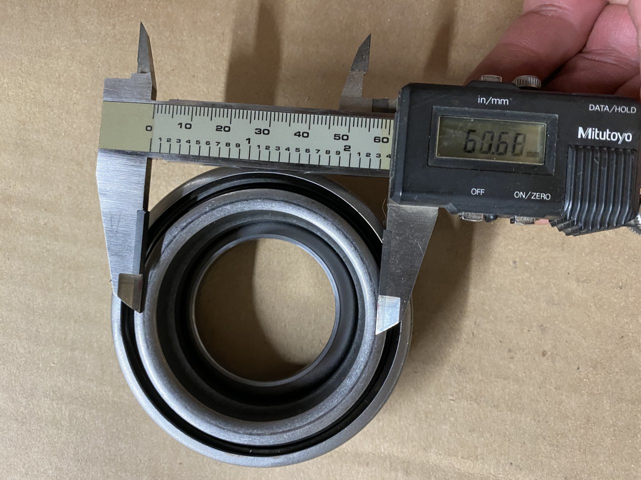

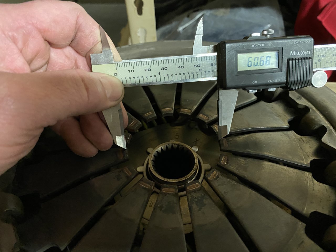

    TodayWasTHeDaY
    TodayWasTHeDaY Hoser
    Jul 10, 2017
    #223673
    2,056
    Russ
    Calgary
    2015 DCSB SC M/T TRD Sport
    Excuse the ghetto calipers
    2.81"
    2.21"
    2.5"
