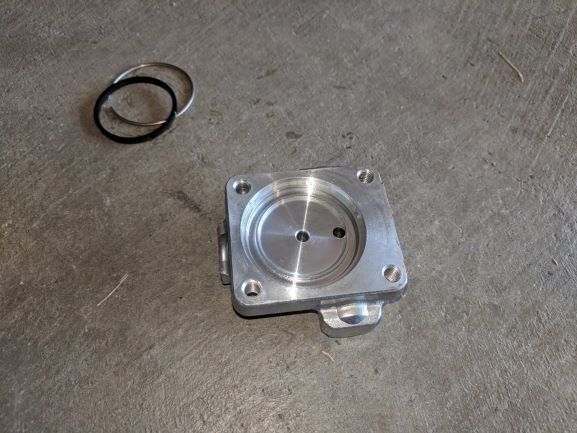

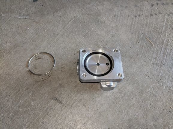

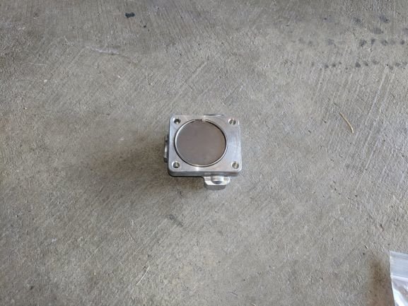

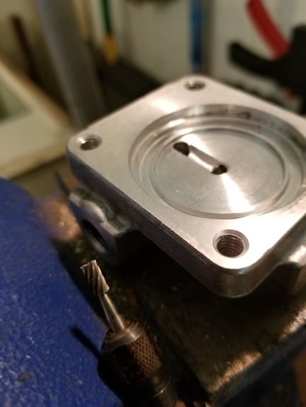

    I ordered PAJ312 from Ebay and the Brass Brake Line Union, 3/16 (M10x1.0 Inverted) from Amazon but did not use it
    The top bolt on the accumulator closest to the engine was so hard to remove I decided not to risk bending any hoses and rather cut a groove in the accumulator, see the photo below, not mine
    I used a carbide cutter in the drill press and it came out very well, unfortunately I didn't take any photos, after wrestling with a bolt on cold concrete for a day I just wanted to finish the job
    The clutch is a lot better after deleting the accumulator, I changed the transmission oil to Redline and it made shifting a lot easier
    I also added a TRD quick shift and it's even better now
