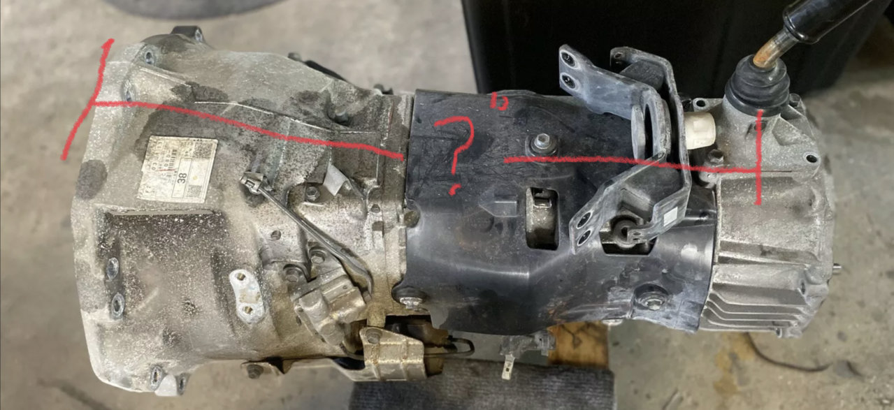

    Anyone have their 6mt out of the truck? Or possibly one laying around in the corner of the garage? I need a measurement. Bell housing face to center of shifter socket.

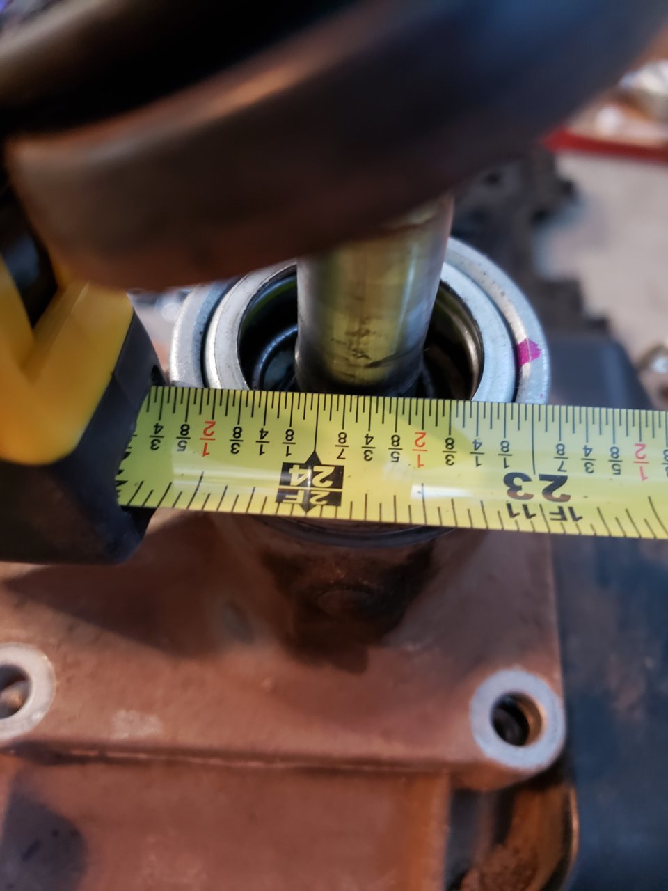

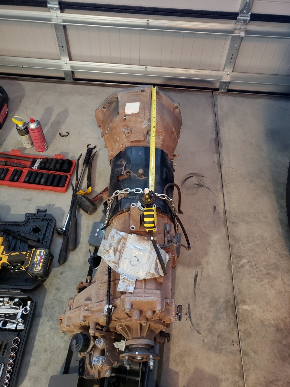

    Sorry for the delay.
    I got 23 13/16th" to center of shifter with it in neutral.

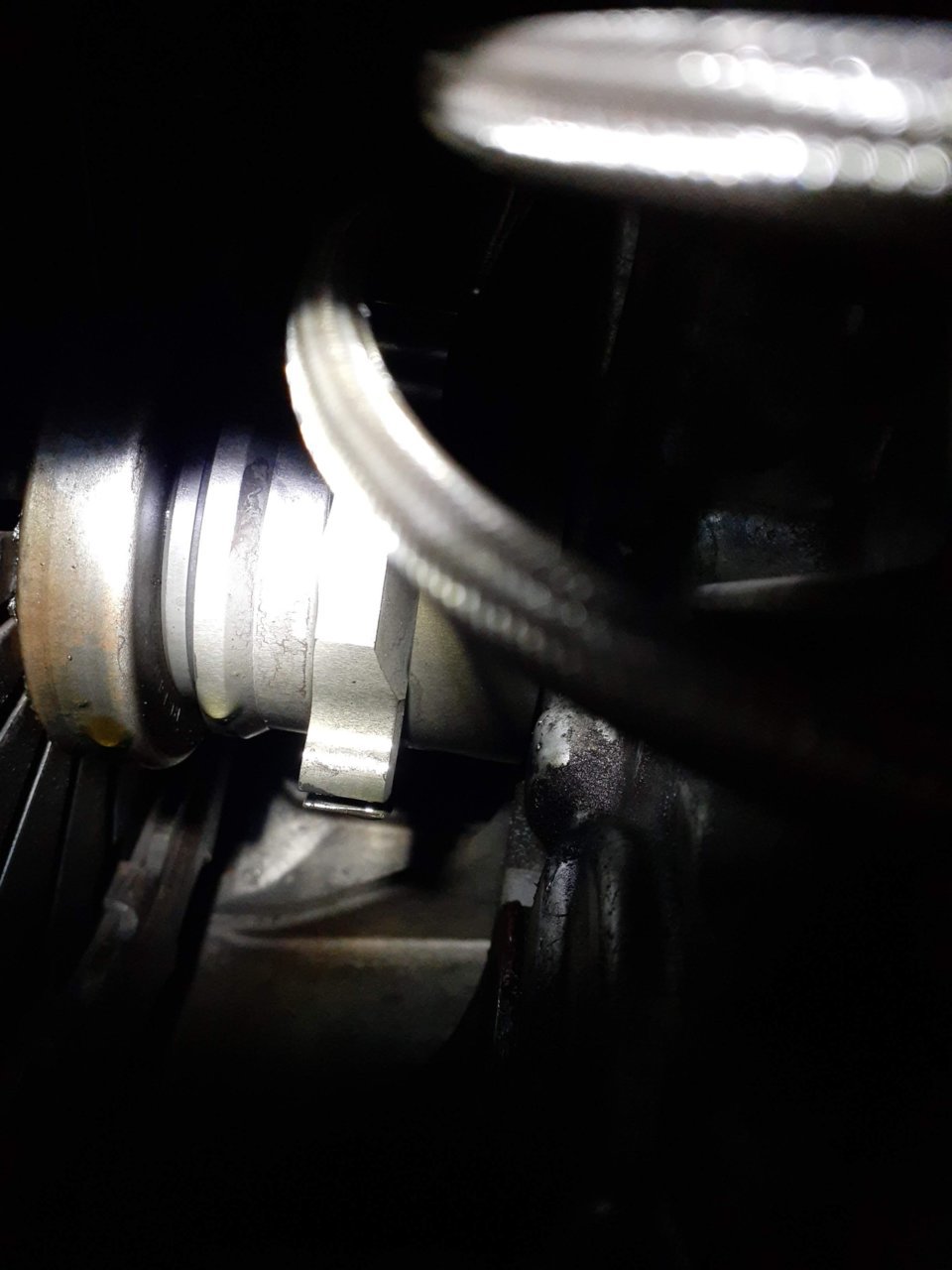

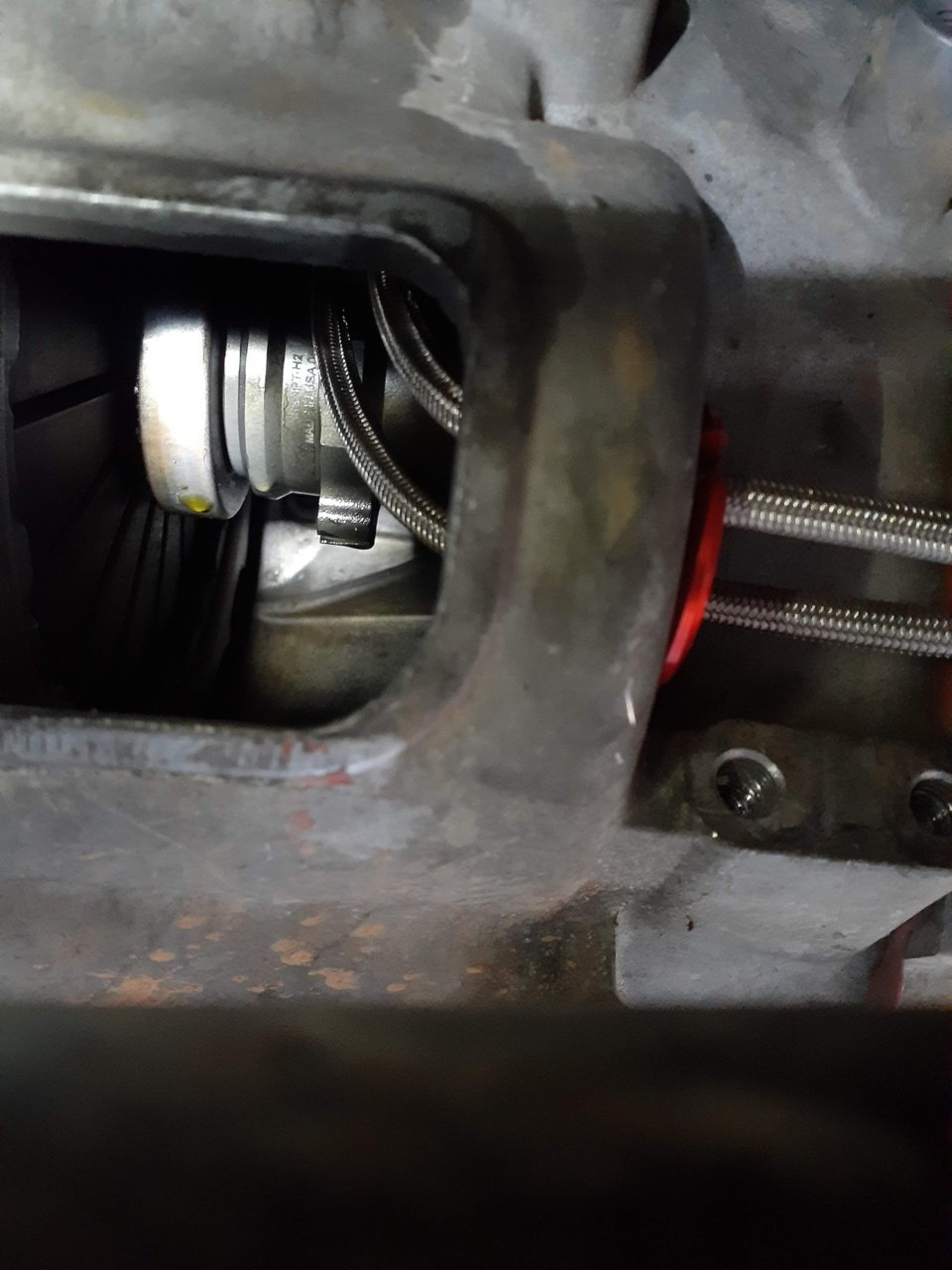

    I haven't got a lot of driving time, but so far I like it. The clutch engagement feels a lot more crisp, even with the heavy flywheel.
    I forgot to measure the URD dimensions. If they are the same as stock, than I think you're right as the stock throw-out bearing definitely has a bigger radius. However, I haven't noticed any wobbling yet, but ill keep an eye on it.
    Also, regarding a few people complaining about inconsistent pedal feel, I have a feeling there might be a misunderstanding. The pedal definitely has less travel...so depending on the master cylinder adjustment, the pedal only has spring tension until it makes contact with the master cylinder. I'm wondering if people are confusing that for "inconsistent" pressure

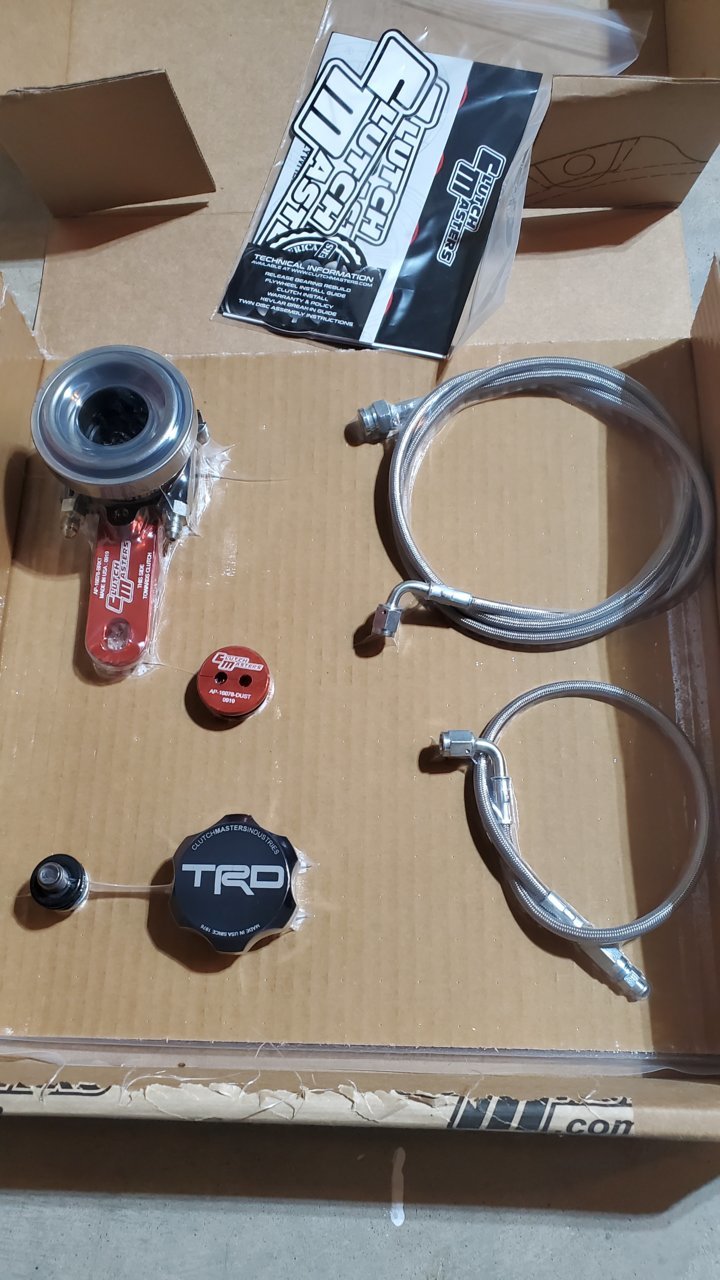

    Less than 2000 miles on this CM gem. Sent two emails a day for six days and over 10 phone calls and not one response. All I needed was a seal kit and still not a word. I speed shifted all the way back home and threw stock TO bearing and slave back in.

    Another vote for this thing being a piece of shit. Most of clutch fluid under truck with under 1900 miles. Have to try to get it around the block and into my garage.
    Haven't tried to contact them and probably not gonna bother with the way they seem to handle things.
