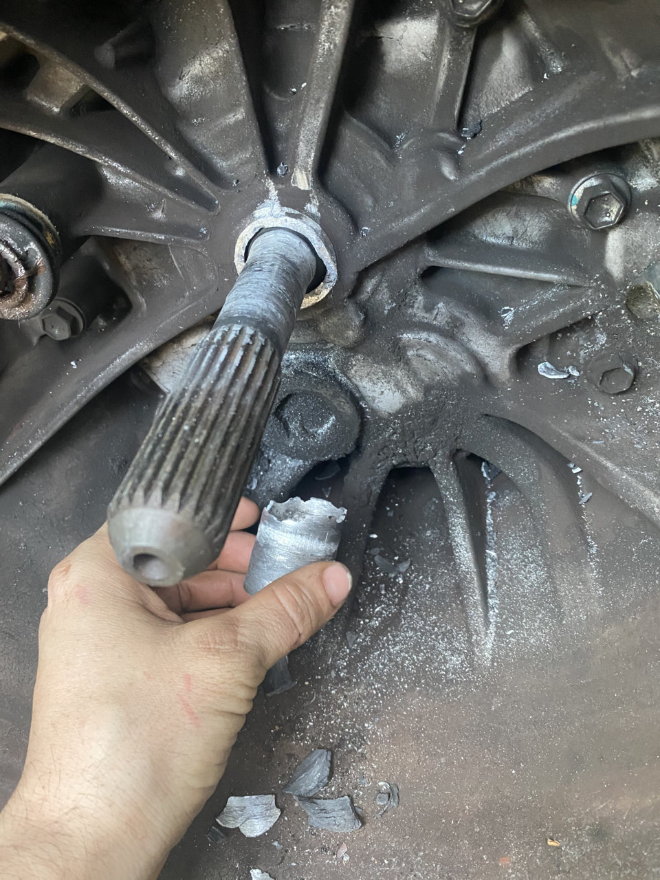

    I know old thread but my quill also sheared off. I was under the impression that cm centered around quill, with none of quill left would cm part work? I know many reported issues but I’m weighing at replace Trans @$3000 used or $500+- for running truck that might eventually leak. Pretty much no lip to hold onto

    Would it be possible to find a bell housing for cheaper instead of replacing the trans?

    From what I’ve seen bell housing not just unbolt-able, would need to disassemble starting from rear and working forward

    Real problem is that input shaft looks like hell too

    was planning on cleaning that some too. I know anything I do short of replacing trans could just be a band aid. These trans are just outrageous even for salvage, can’t believe I’ve bought a different trans from picknpull for $75 but these trucks could be $3,500 for junkyard trans

    The bell housing had to be replaced in result of the quill breaking off. I don’t recall the cost of the bell housing now but it wasn’t over a grand. I also had a local shop do my repair and install the kit. So they sourced all the bell housing and I bought the CM bearing kit and URD clutch kit that I went with. Sorry for your breakage.

    This one looks like a goner I’m afraid. That input shaft looks pretty bad. What’s the last 8 digits of your VIN? Where are you located?

    If you dig early on in this thread, you will find that I am running this CM set-up without the quill in my bell housing
