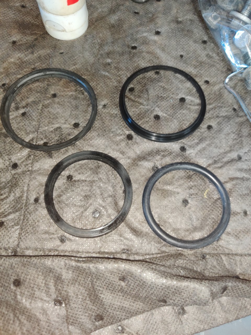

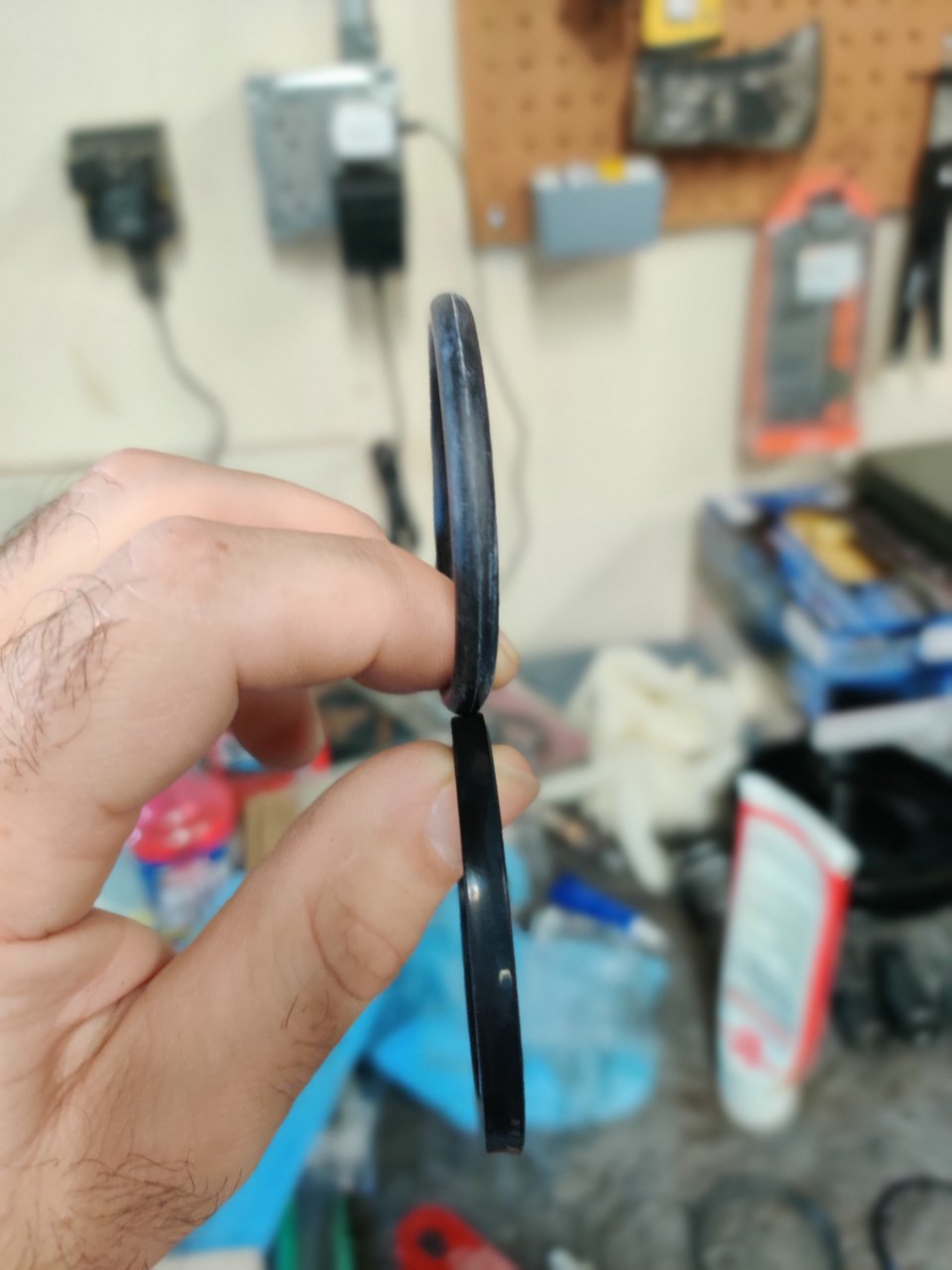

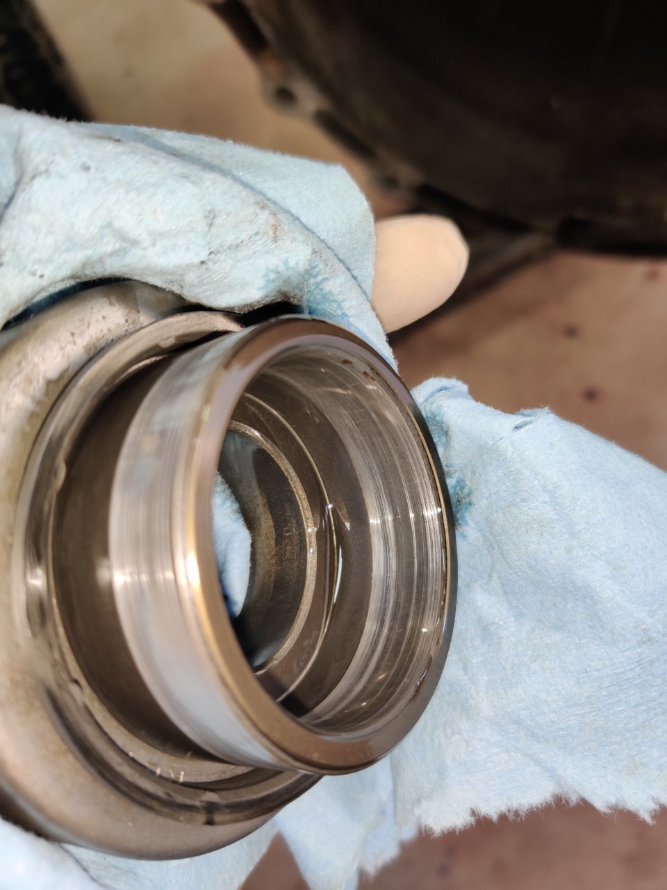

    Since my release bearing has gone out. I got a seal kit before dropped the trans. after taking apart the bearing assembly, I can see the updated the seal for the kit. The seal in the unit is a square edged seal and the new one in the kit is round.
    Edit: pic and of damge

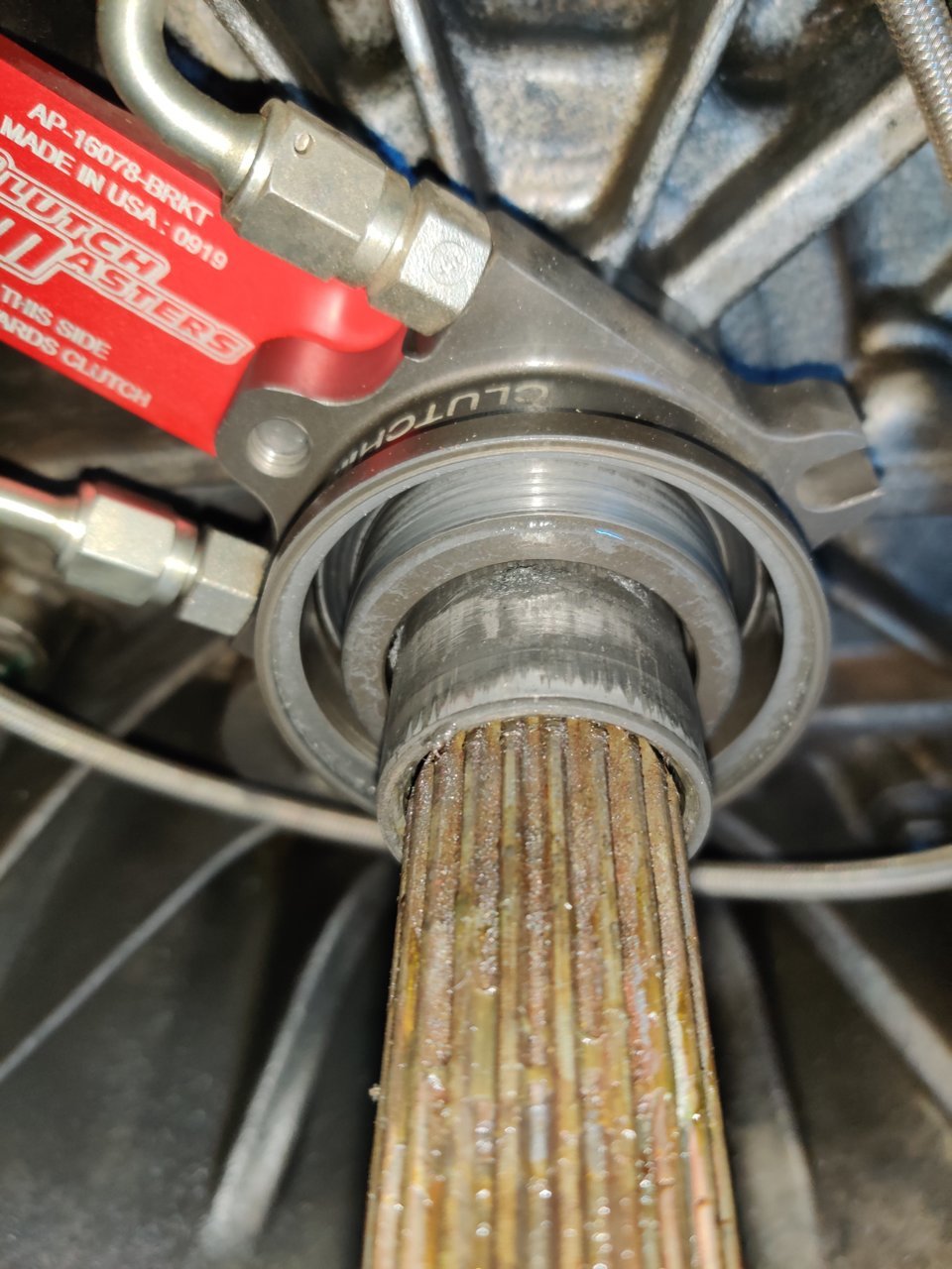

    #939
    garciav
    garciav Well-Known Member
    Apr 11, 2016
    #184036
    582
    Houston, TX
    2013 Tacoma TRD Off-Road 6MT
    TRD SC,HPTuners
    Doing some maintenance on the truck today, found this little present in my clutch res, metal shavings...
    After about 20k miles rolling the dice with this hydrobearing looks like it’s finally on the way out. Guess I’m gonna have to drop this trans sooner rather than later
  20. May 30, 2021 at 2:20 PM
    #940
    rheath08
    rheath08 Well-Known Member
    Nov 16, 2016
    #202554
    1,766
    Russell
    Bakersfield, CA
    Frankenstein's Monster
    converted AWD, RC62f swap, Supercharged
    Sorry to hear about this. I hope you come up with a better solution.
