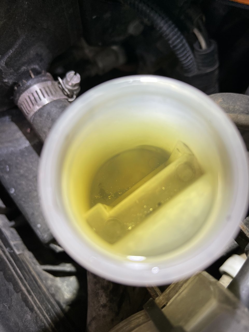

    Are we sure that this isn’t a CMC issue? That seems more likely than those shavings working their way up to the reservoir from the HRB.

    I thought the clutch master cylinder was all plastic parts, could these shavings come from there ?
    I have had this issue in the past where the clutch fluid gets off color and I find what looks like clutch dust in the reservoir. This is way more noticeable after I’ve ridden the clutch hard thru wheeling, etc.. I’ve already drained and replaced the clutch fluid 3 times now with this clutch master crap, I know I have a slow leak somewhere.
    Regardless, I’ve been waiting on the CM bearing to take a crap on me so I can get rid of it- this looks like a good enough excuse..

    With the presence of those shavings, If’n it were me, I’d replace the master. May as well go to the Fj master and pedal while you’re there.

    The Tacoma has used an aluminum master for years now and the clutch pedal TSB also replaces the plastic master with an aluminum unit.
