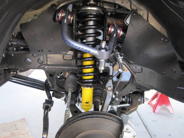

    I have DCSB With OME nitrogen 90000 886x with top plate(from toytec) and DAkAR with OME AAL , d29xl . It's been 2 weeks since I install the front and 1 day since I install the rear. I didn't do alligment yet.
    This are my ground to fender with OEM tires 265/70/16 like in the picture:
    FD 37"3/4 FP 38"1/4
    RD 39"1/2 RP 40"1/2
    AND THIS IS THE APROX MEASURMENTS CENTER HUB CAP TO FENDER:
    FD 23"1/2 FR 24"
    RD 25"1/4 RP 26"
