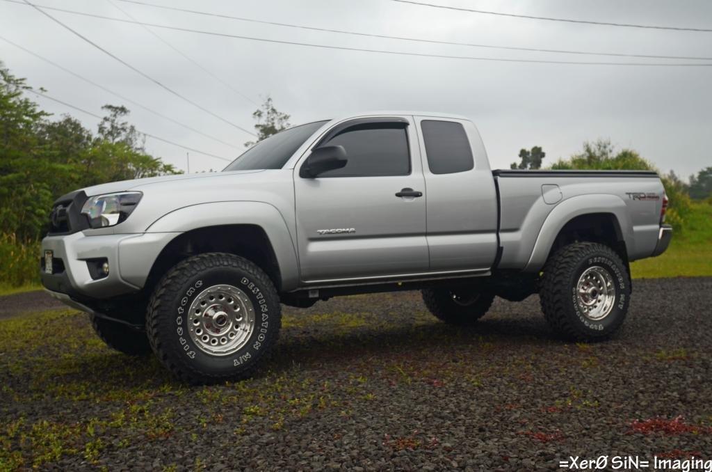

    just wanted to leave my numbers here. i just replaced my stock trd off road leaf pack with the toytec 2" aal. i know its already been established but the stock leaf pack is freaking shitty! the dakar leaf with extra overload leaf is the way to go (imo). shit is super stiff, just the way i like it though. with the stock leafs when i threw away trash, which is never a lot mind you, the back would sag right away; and dont even get me started if i load up my quad. with the new leaf pack, there is no variance. i load anything up (within reason) it stays the same. im very pleased. the rears, from middle to fender measured 25 1/4". the only thing im sad about is the rake. its prominent now. with my icon (extended travel) coilovers maxed, there is no adjustment, so front is 3 1/2" of lift and rear is more like 5". not a deal breaker but its there.

    oz: i contemplated that. i mean, im sad cause now the rake is so prominent. kinda like how it was stock, but lifted LOL. but not sad enough to take everything apart again just to take that leaf out. its something that i can get used to cause it actually doesnt look that bad; its just my preference i the whole matter. plus also, im anticipating (hoping) the rears to settle a half inch or so, but by the way and how stiff these leaf packs are...i doubt it.
    EDIT: cause i said i was gonna post up a pic
    JimboAnz likes this.

    I vote to leave as is. Looks great xero, maybe even haul around the quad for a bit to see if it will speed up the settling process?

    Looks sweet
