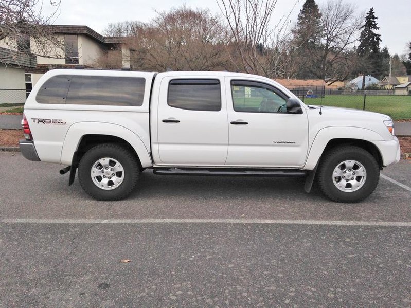

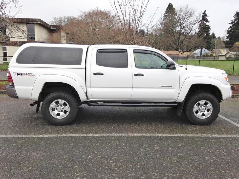

    Stock front= 20-1/4”
    Stock rear =21.0”
    OME 885x with ¼” spacer
    Dakars
    Front =23-5/8”
    Rear =24-1/8”

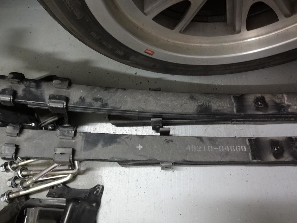

    I thought my truck sat high in the back with the factory springs. Had a nice rake to it. When I removed my leafs, one of them had a plus (+) on it. Is this common?
    Anyways, here are my DCSB before and after Dakar measurements.
    Stock
    DF 20
    PF 20.5
    DR 21.75
    PR 22
    1 day after install with about 35mi
    DF 23
    PF 23
    DR 25.5
    PR 25.5

    Anyone got a side view of a Dakar pack, preferably before installation, so those who are considering this can see which leaf is which for removal? If this has been posted, sorry...
  13. Jan 30, 2015 at 7:58 PM
    #453
    OZ-T
    OZ-T [OP] I hate my neighbour
    Dec 15, 2009
    #27584
    50,587
    Peter North
    British Columbia
    3rd down from the top
