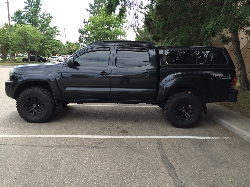

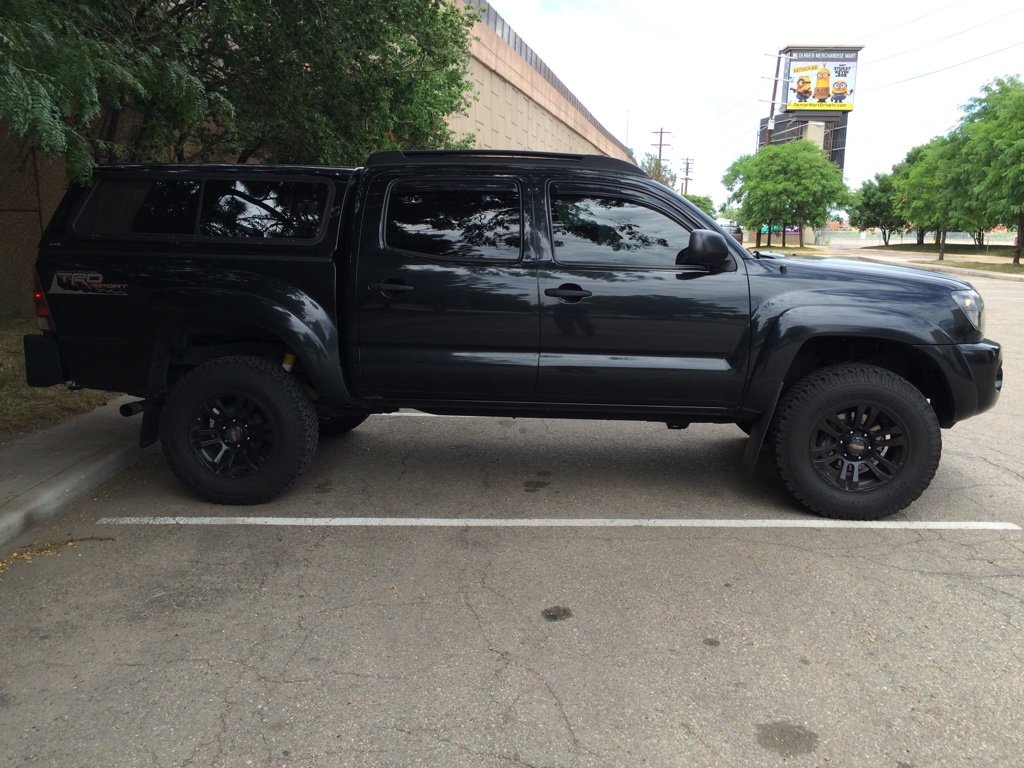

    24.5"
    Think i f'd up driver side put the bolt in wrong direction on shackle
    Edit: sitting at just a (insert preferred word here) hair under 24" maybe 1/4" dr lower than pr. Sawzall cured my shackle bolt being in wrong.
