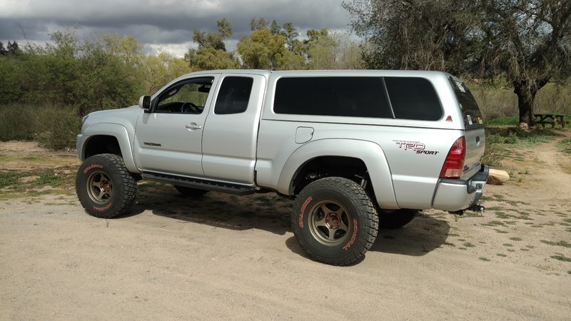

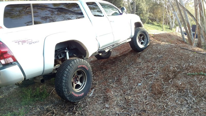

    2nd screen name Tacodelaplaya
    Nov 17, 2015
    #169943
    286
    Bob
    LV/SD
    06 AC Sport Prerunner
    Front: Maxtrac, DK heim UCA, 6112 Rear: AP expos, Fox 2.5 RR DSC Fn fivestar with General reds
    i know this might not be the best place to say this but i am extremely happy with my expo pack. i did install it exactly as it came and the ride is buttery soft and provides about 3-4 inches of lift. i have done some desert running, jumped a few times on and offroad, and regular street driving and it has been a great upgrade performance and looks wise. coupled with fox 2.5 DSC RR i have been able to tune the rear to be perfect with my bed shell and storage. i have absolutely no complaints about stiffness. i only suggest this because you are buying a new part and modifying it before its on the truck to decrease the stiffness. I can only tell you i would never consider wasting my time after installing this part, its perfect as it comes.
    i cant speak to the regular pack but i would expect the similar performance and less height. they purposely designed these to be flexy which means a nicer ride in my opinion. coupled with a huge shock like i have its perfect. shock over spring is what we should be aiming for.IMG_20160306_165550133.jpg IMG_20160306_165542652.jpg
