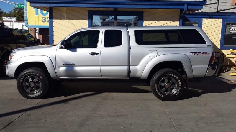

    FWIW, I removed my second overloads, rather than 3rd leafs. Ride is great. I haven't hauled anything really heavy, but here's side shot after my topper was installed - no sagging.
