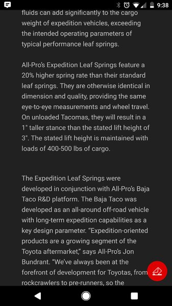

    Is it possible to get 3.5-4" of lift with OME if i get the added leaf? Want to put 308/60R18s, thx!

    Thanks I wasn't sure if they would work since it says 3". I see now.
