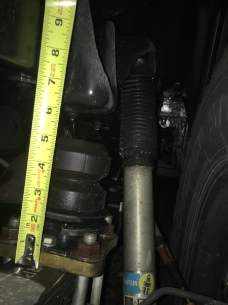

    That sounds right. I'm at 25" now after carrying some extra sand bags and putting miles on them. Seems like the 2nd overload is worth about 1/2", since we're at about the same weight but I took out the 2nd add a leaf.
    Did you flip the u bolts? I did and am trying to figure out bump stops- running 2.5" energy suspension stops but they are probably too short.
    I have a 1/4 inch spacer in there now because I grabbed the ubolts from wheelers and I really need the specific ubolts from allpro due to washer/bolt size and clearance against the universal Timbren black platform that rests directly on the top plate
