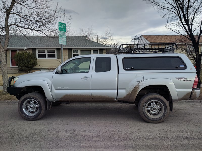

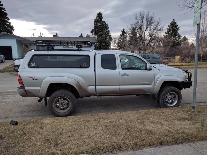

    Just got my ARB bumper and OME kit with full CS047R leaf springs, 9000 struts with 886 coils and 60091 shocks installed (stock UCAs), I'm pretty happy with the appearance and the ride so far.
    My taco is a 2005 Access Cab, 4x4 TRD Sport, I have a canopy with a roof rack on top, also usually cart around a decent amount of stuff in my bed.
    Driver's side rear: 24.5"
    Passenger side rear: 24.5"
    Driver's side front: 23.5"
    Passenger side front: 23.5"
