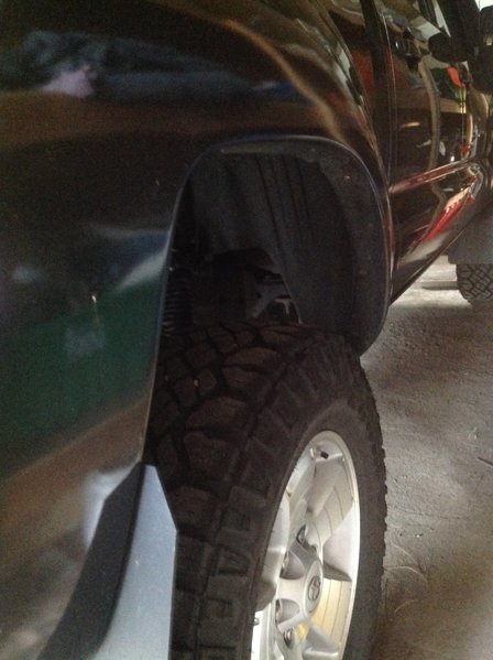

    Had my suspension installed today. 6112s w/ Eibach 650# springs, JBA UCAs, OME Dakar full leaf pack w/d29xl aal and Bilsten 5100 B110 shocks. Both leafs packs are "+".
    Where to start....With the rear set up above the ass end of the truck is quite high (almost too high). I have a SnugTop Rebel cap and a sleeping platform in the bed all the time but I did the aal because I will have a rear bumper, tire swing out and fuel swing out in a month and then next year the cap goes for a bed rack, RTT, fridge and gear.
    Sorry for the bad pictures but I just ran out to the garage with the iPad. @OZ-T. I had just under half a tank of gas.
    DR- 25 3/8"
    PR- 25 5/8"

    It will come down with the weight you are going to add
    Sna likes this.
