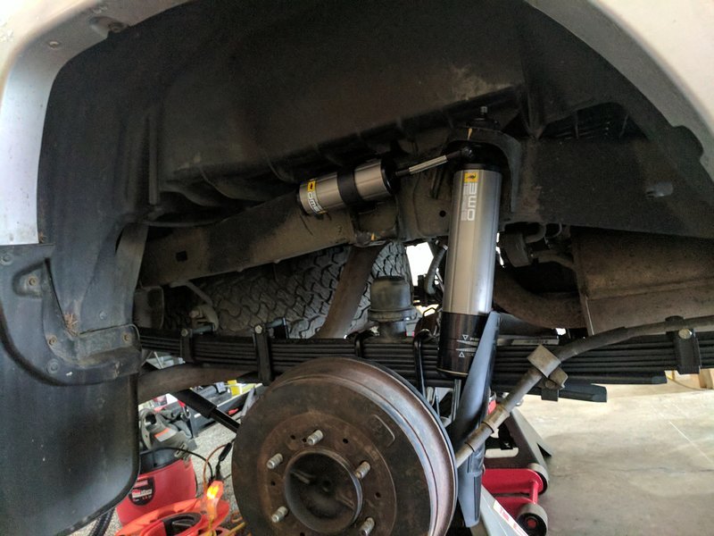

    I acquired EL095 package and b110's from Marie @HeadStrong Off-Road. Great customer service! Thanks again!
    I accompanied this setup with +4" brake lines from @OCTaco. Great lines, easy instillation, working great and looking good. Thanks again for the easy transaction!
    I have a 2011 Tacoma 4cyl 4x4 with an ARE cap. The EL095 have OME poly bushings, 3* shims and wheeler's bump stops. This instillation was done 11/18/17, 11 days ago.
    Rear Measurements:
    Before: Driver: 19 3/4"" Pass: 20 1/4"
    After: Driver: 24" Pass: 24 1/2"
    *Please note: these measurements were taken with a full fuel tank.
    No vibrations to this point through all rpm and speed ranges.
