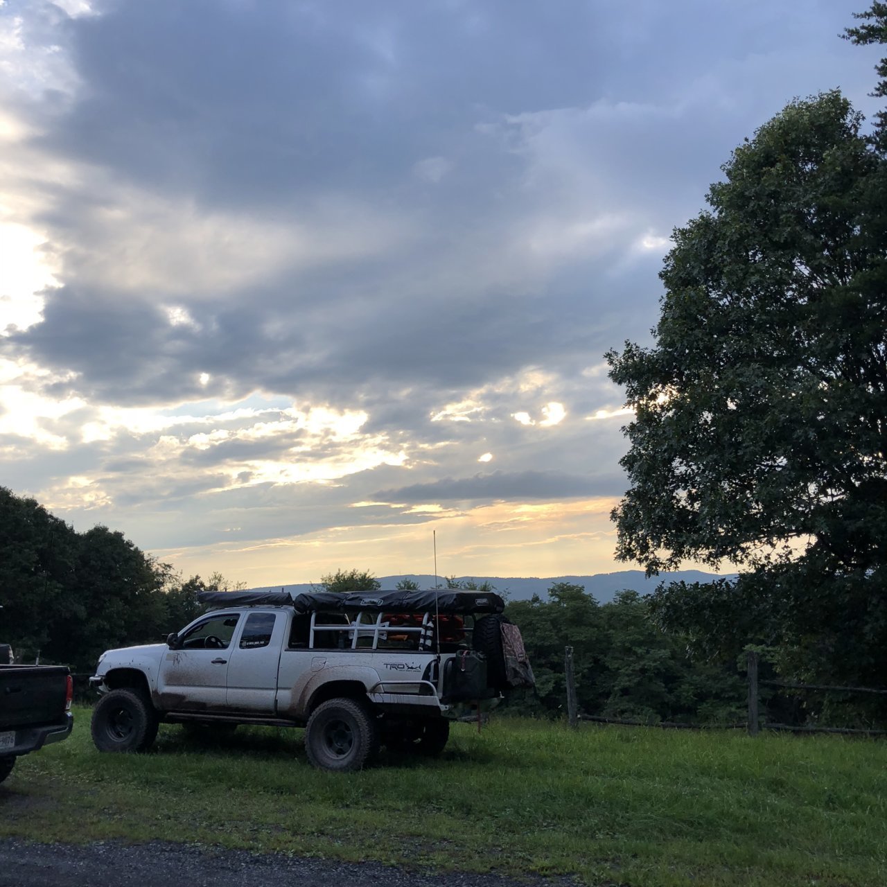

    Somehow the Dakar HD and extra AAL were taller..
    AllPro Expos
    Dakar HD + AAL

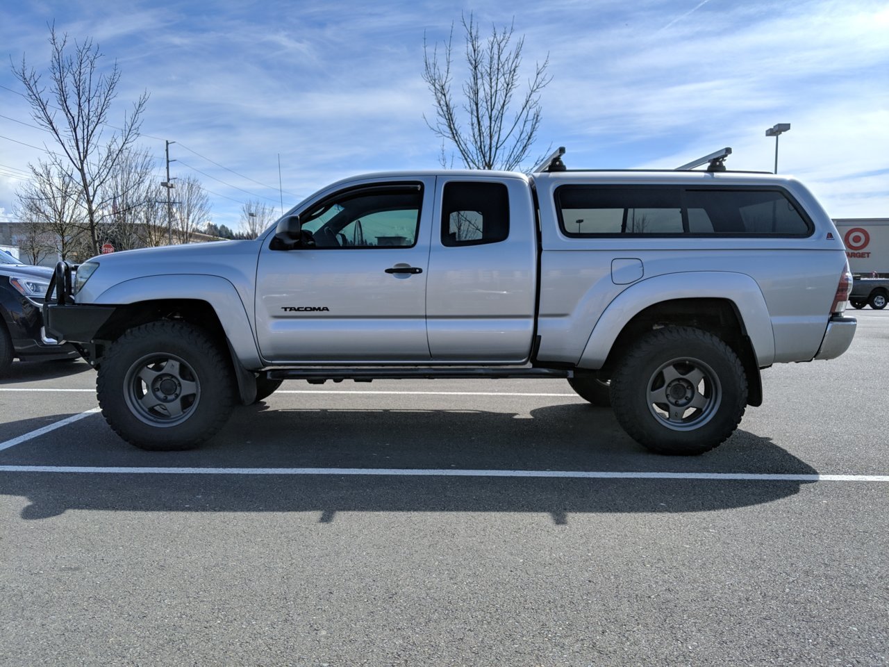

    Installed my EL095R yesterday on my 2006 AC OR, ended up at around 22.5" hub to fender but started at around 20.5". I've got a canopy, sleeping platform, topperezlift system, and fridge+battery bank in the back seat, so shes a fat pig. I will eventually be adding the Dakar AAL once I get the fronts installed, everything settles, and I know I can fit in my garage :)

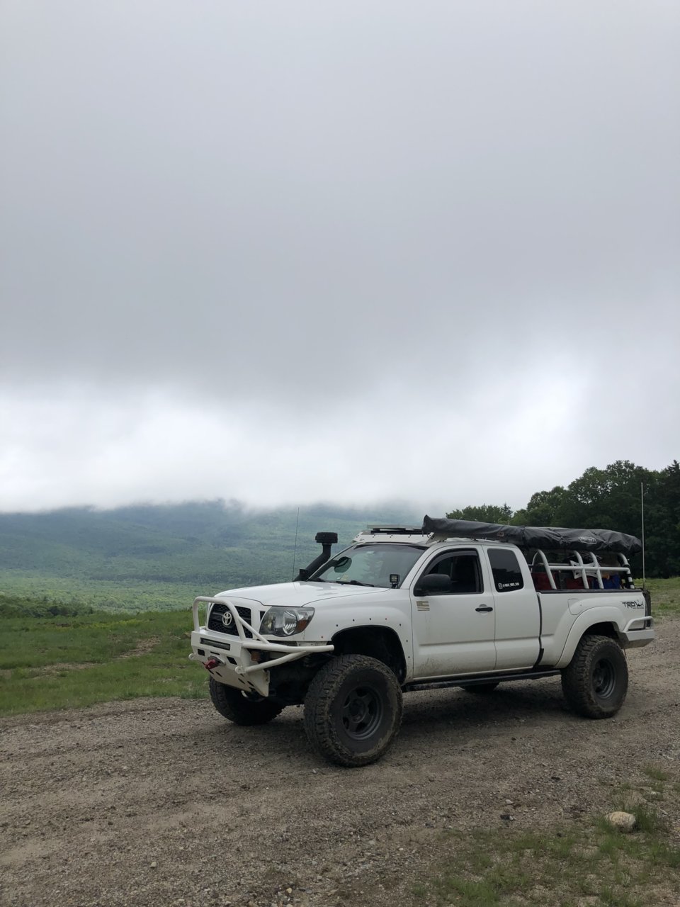

    Question: will removing the 3rd leaf from my CS047R leaf pack affect the geometry of the front suspension enough to require an alignment? I went from 20mm of preload down to 15mm up front on my BP51s and forgot to check how much rake I had before getting it aligned. I don't overload the bed so I'm not worried about sag.

    It looks good the way it is ! What is the reason for removing the 3rd leaf ?

    Maybe it's just that way I'm looking at it, but since the front is lower now, I notice the rake much more.

    How long have your leafs been installed, @yeos? FWIW, mine settled a little over time.

    Leafs have been on for two years. The fronts are new warranty replacement BP51s which I reduced the preload from 20mm down to 15mm because the ride was too harsh and kept topping out.

    Well, that means they've settled as much as they're going to.
    FWIW, I removed the second overload from mine, rather than any of the leafs themselves. It was relatively easy and gave me the height I wanted without changing the ride characteristics.
