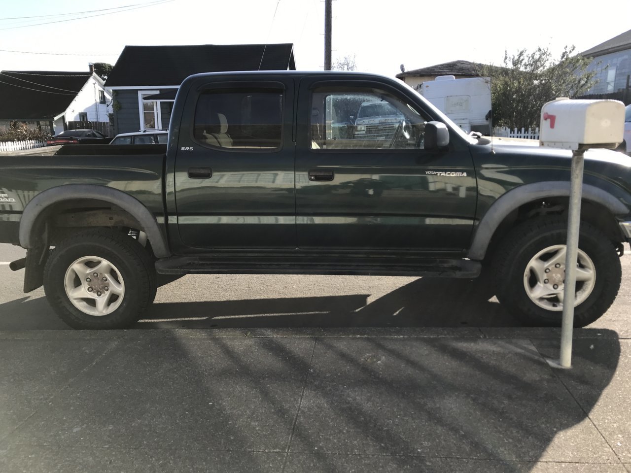

    Hey everyone, my stock leafs were inverted with no weight in the back, and I was due for some new tires, so I decided to install the springs along with Gabriel g57010 struts up front and G63494 in the rear.
    Full tank, empty bed -
    Front: 21”
    Rear: 24.5”
    The truck rode rough on the original ‘01 Bilstein hardware, but I am surprised at how much I can feel every bump with the new hardware. The rake is obviously significant, and I’m not sure why it’s so much different. Any recommendations on how to proceed? I’m thinking I’ll take a leaf out as OME recommends, but maybe I just bought the wrong struts? Should I be installing a levelling kit up front or something (saw another posted saying those are bad for the suspension)? I’m new to all of this and kinda confused as to why I gained so much more lift than expected... I thought that my hardware had a 1.5” lift over stock (stock being the low sitting non TRD) and that the 2.25” lift of the Dakar’s would bring me up 3/4” and now I’m 3.5” of differential :( any advice would be appreciated.

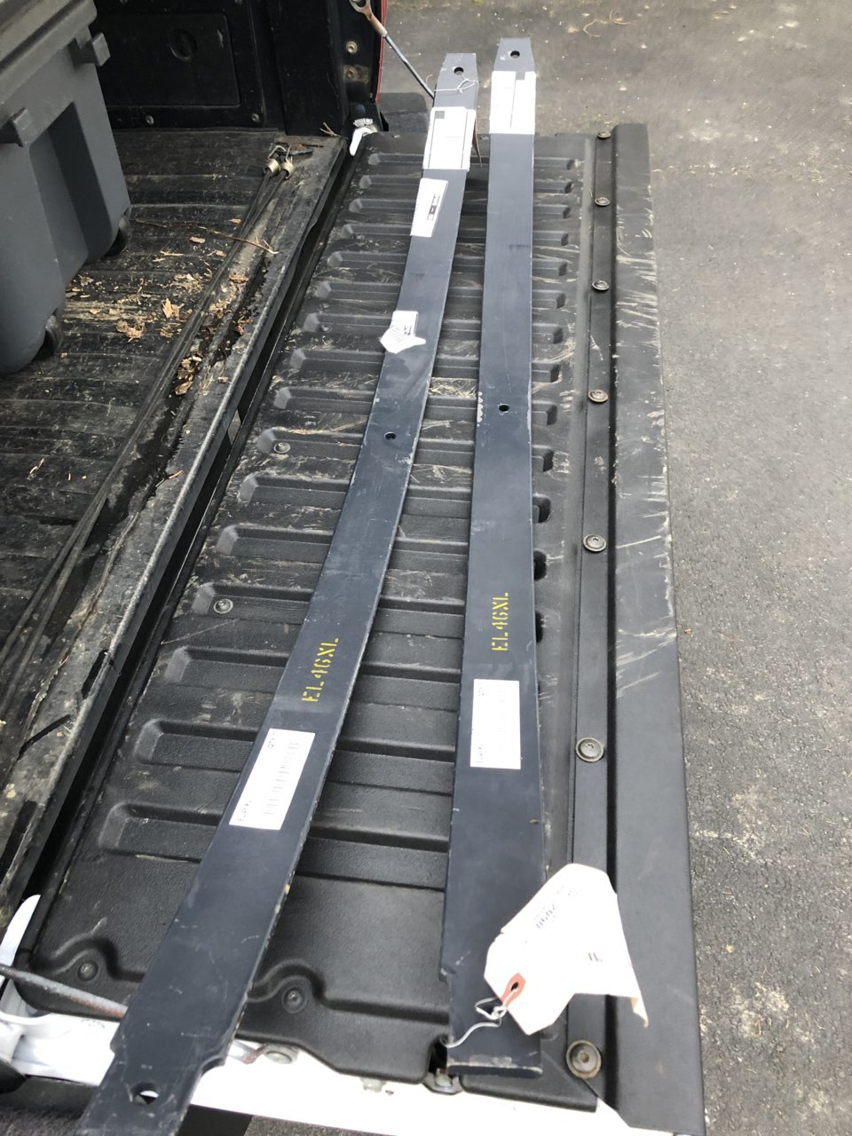

    OME AAL on the way with some anti squeak pads . Medium duty Dakar’s just not giving me the height I want .
