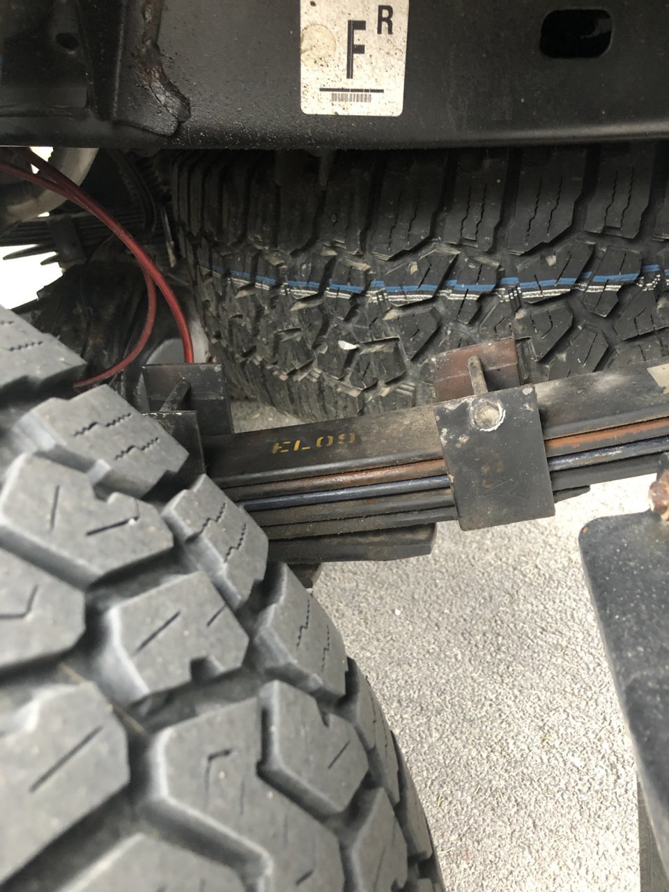

    Went on a ride that had a lot of gritty, sandy, wet dirt roads on it back in January. No mud bogging or anything, but it was raining like hell so splashing that gritty water everywhere was unavoidable.
    Anyhow, I've got a freakin' horrendous squeak coming from the driver's side leaf spring I believe at the front hangar. The leaf springs themselves do not appear to have any mud or rust in them so I'm inclined to think the squeak is coming from the hanger/front bushing area. It's bad. As in you can hear it inside the cabin above the radio at times bad.
    Is there anything you guys suggest I can do short of taking the leaf off and cleaning out that area? I thought about giving it a good soak with WD-40 or PB Blaster to see if it quiets down, but I also don't want a big greasy area that's going to attract every particle of dust and grit back up again. The leafs were installed with the Energy Suspension bushings about a year and a half ago so they're pretty new with low miles.
    Thoughts or wisdom?

    I spray the crap out of my Dakar’s about 3 times a year . I use Krown rust prevention but you can use anything you like ! I soak the whole leaf pack including the hangers . Never had a squeak.

    Finally had a small squeak from the leafs . Just sprayed again with Krown and squeak gone .

    I ended up drowning my bushings in Liquid Wrench silicone spray. Hopped up and down on the tailgate for a couple of minutes. After a day or two of riding squeaks were gone (fingers crossed).

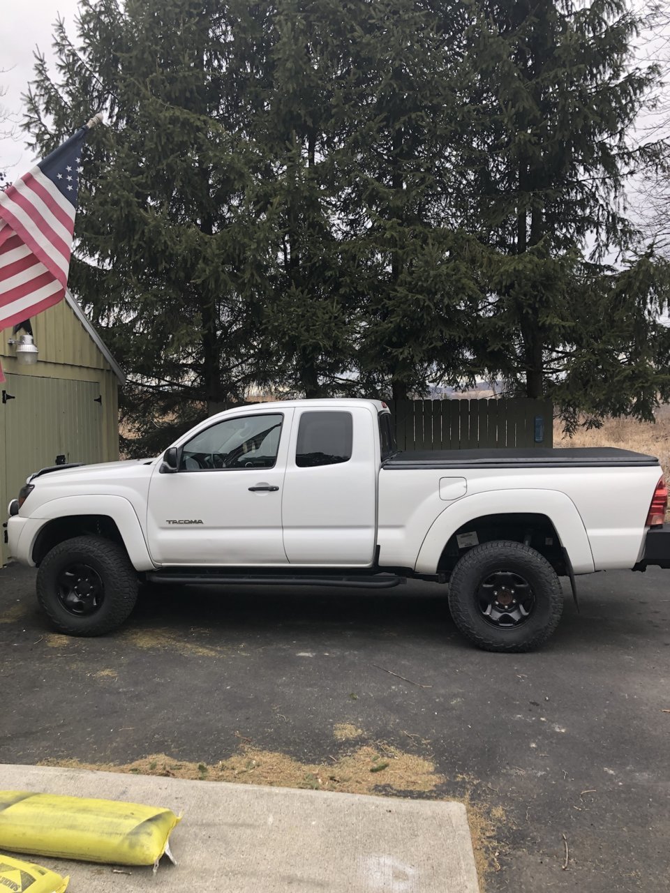

    I’m back with some new measurements:
    Bottom of center cap to under fender with half a tank of gas . I do have a tool box in the bed with a lot of stuff but it’s centered in the nose of the bed .
    Front drivers side 25 1/4
    Front passenger 25 3/8
    Drivers rear 26 1/2
    Passenger rear 27 1/8
    See post 883 ,some settling has occurred since adding my AAL .

    Need another measurement. I notice a lean that looks a little more pronounced on the drivers side :(
