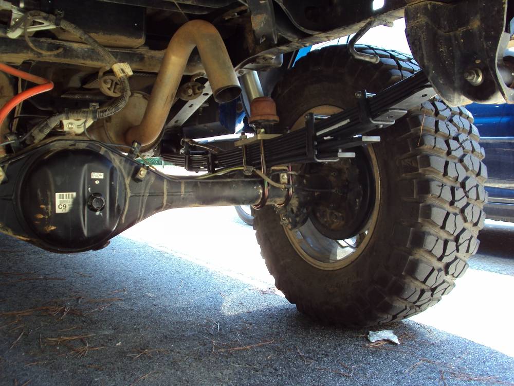

    OK so, just installed yesterday.
    OME Dakar with D29XL add-a-leaf. Between bed mat, hi-lift, spare tire, bed rack, gas tank skid, and rear bumper, the ass end of my truck has about a 200lb. constant load. Hence the add a leaf.
    Hub to Fender:
    Driver: 25.25in
    Passenger:
    25in
    Ground to Fender
    (33in tire):
    Driver: 41.25in
    Passenger: 41in
    Bear in mind, this is the day after install. They're going to settle some, but I expect a final height around 40.xx in from the ground, 24.xx in hub to fender.
  18. Jul 8, 2012 at 1:30 PM
    #138
    OZ-T
    OZ-T [OP] I hate my neighbour

    Peter North
    British Columbia
    You put the d29xl below the 3rd leaf down from the top ?
  19. Jul 8, 2012 at 1:31 PM
    #139
    jandrews
    jandrews Hootin' and Hollerin'
    Jun 7, 2009
    #18122
    16,432
    '09 FourDubDee TRD OR
    A-TRUCK, Fat Kid in the Bed, Custom Pinstriping, Ported and Polished Muffler Bearing, Hi-Performance Bed Mat
    The D29XL is the 4th leaf down. Below the 3rd leaf in the pack. This was where it fit in the leaf structure...slightly shorter than the leaf above it, slightly longer than the one below.
