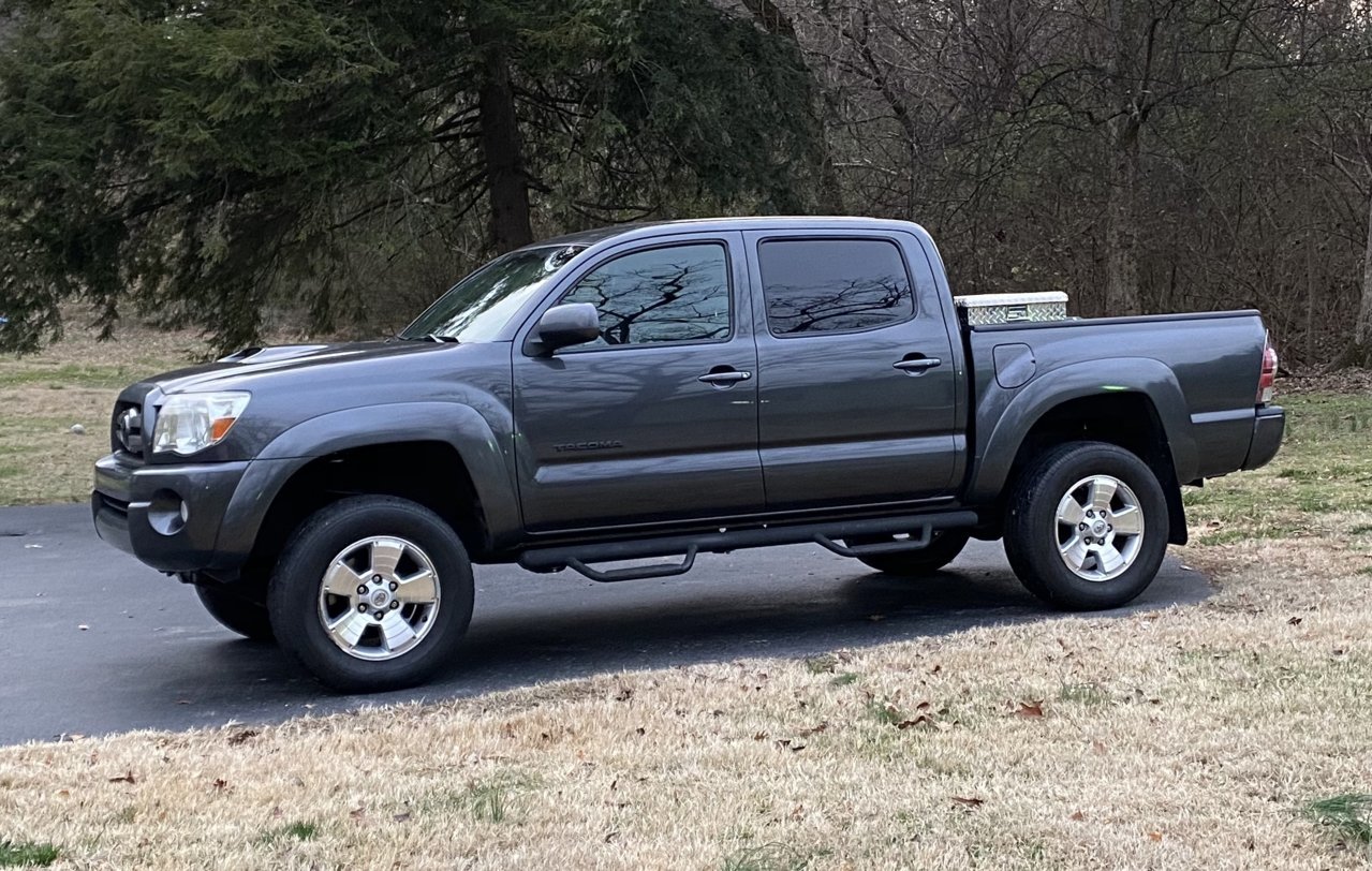

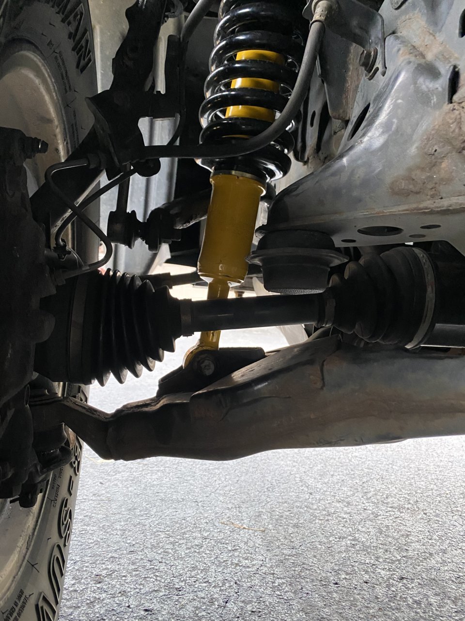

    Just completed my first suspension build. I’ve been wanting to do this for 2 years, and you all have unknowingly helped me tremendously in my decision making.
    I went with OME 885X coils, 1/2” spacer plus trim packer on DS, front and rear Nitrochargers, and a Deaver add-a-leaf in my TSB rear leaf pack. I gained roughly 3 1/4” in the front, and 2” in the back.
    Tires and alignment soon.

    Pics of your CV angles? Getting ready to go with OME but 887’s so should be just under your 3.25 inches in the front.

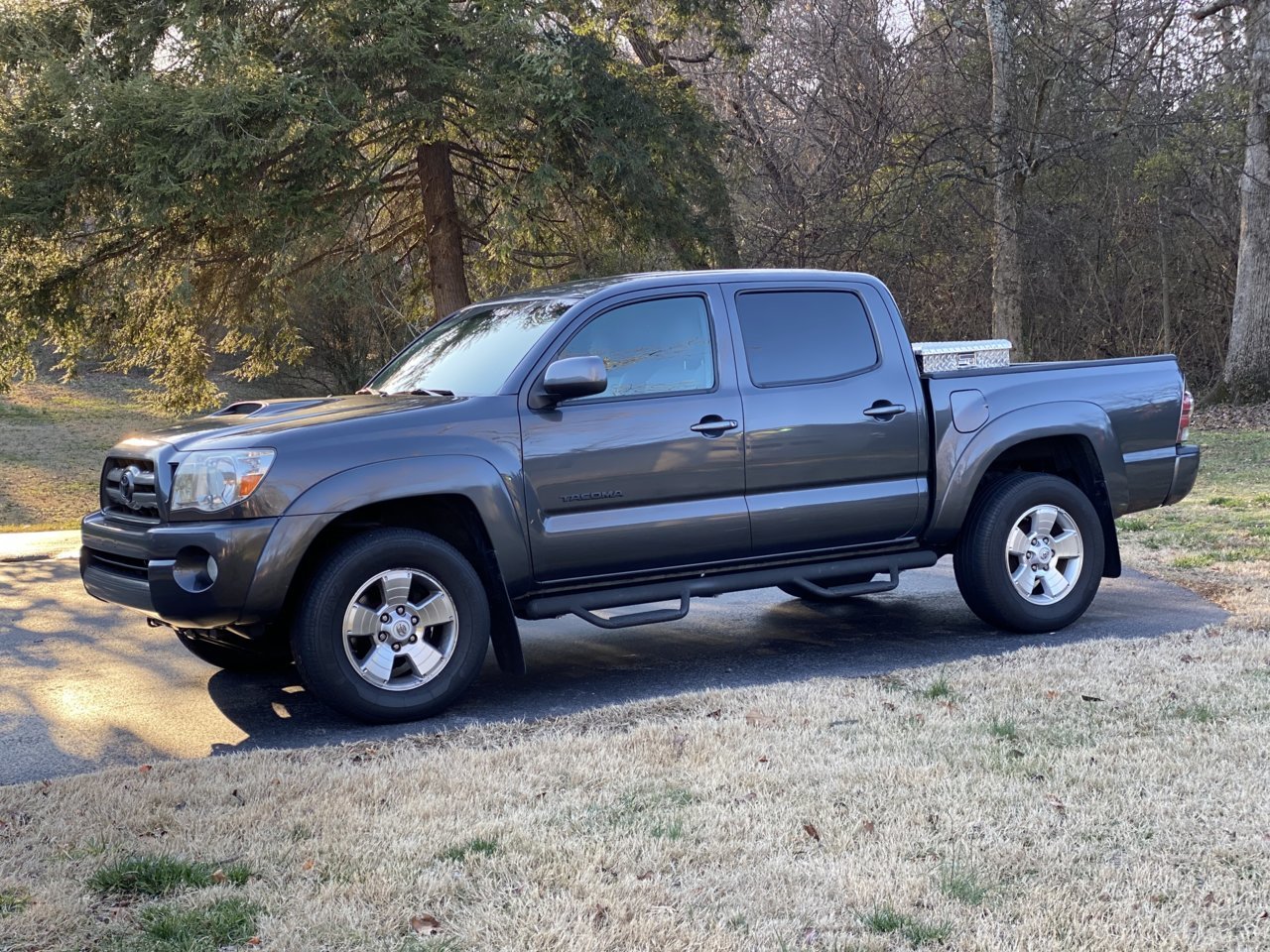

    Everything feels tighter, and more controlled. Not near the body sway it had. I can’t really report on bumps yet. I will get pics of the CV’s up, I knew that was coming. I have no idea how my alignment will go, I understand I will most likely need UCA’s to get close to spec. I will say that I was pleasantly surprised how well it drives. I thought I’d be all over the place. It drives straight down the road, no vibes at all, and I got it up to 85 last night.
    Also, it looks nose high in the picture, but really level in person, I like it.
    Here are my actual before and after measurements, just after I got done.

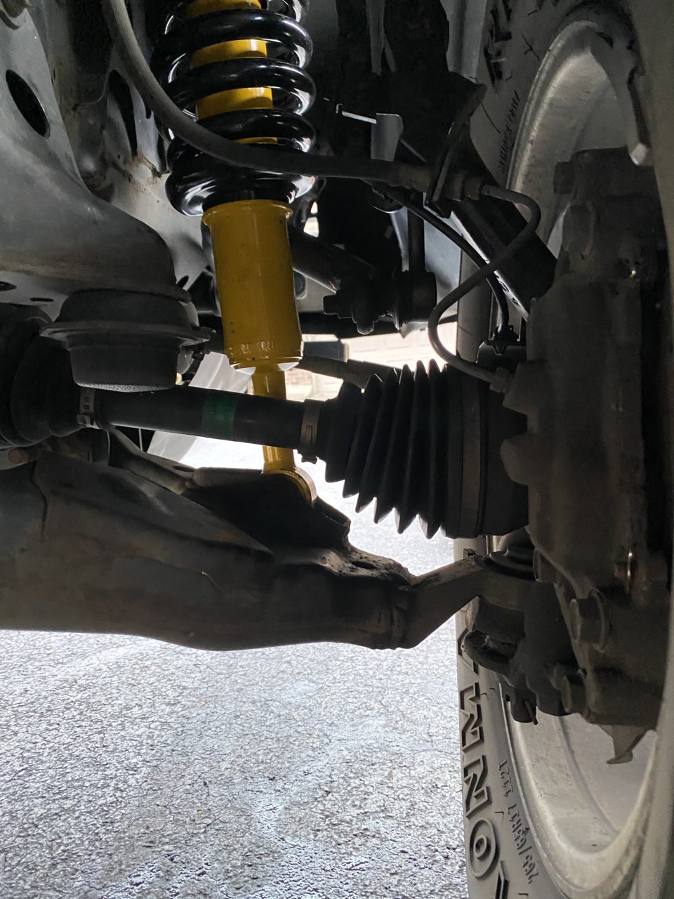

    CV’s, as requested;

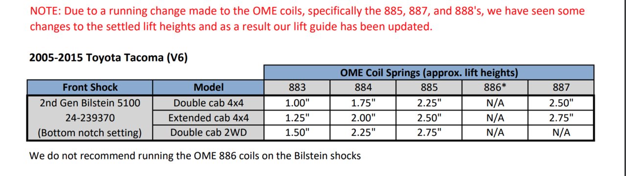

    Nice setup! My 885s (with Nitrochargers) only gave me 2.5" up front. But I got almost 3" in the rear with the 3 leaf progressive AAL in the rear (kept overload leaf).
    When I ordered mine from Headstrong Offroad, the chart showed 2.5" of lift for the 885 coils (couple years back). Last I checked, they don't have the chart and refer you to OME's spec which shows 1.75" of lift with the 885 (https://arbusa.com/site/wp-content/uploads/toyotaTacoma.pdf). If others see this, did OME change their spring? I don't know what to make of the differences and how OP got over the list lift amount.

    These actually look pretty good. Hard to see the inner fins but from my limited experience they look good for that height.
    Here is the updated lift amounts from Headstrong Offroad. They list it under Bilstein shocks but it will not matter as the coil is what is providing the lift.

    I was happy about the CV’s. I was pretty nervous when I still had it on jacks, but once I got it on the ground with some weight on it, they flattened out pretty good.

    Thanks for finding and posting that. I was thinking about going with 887's one day, but I can see that it wouldn't change my setup.

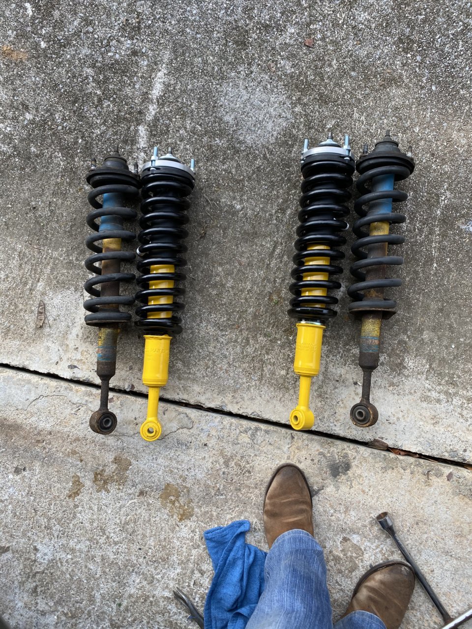

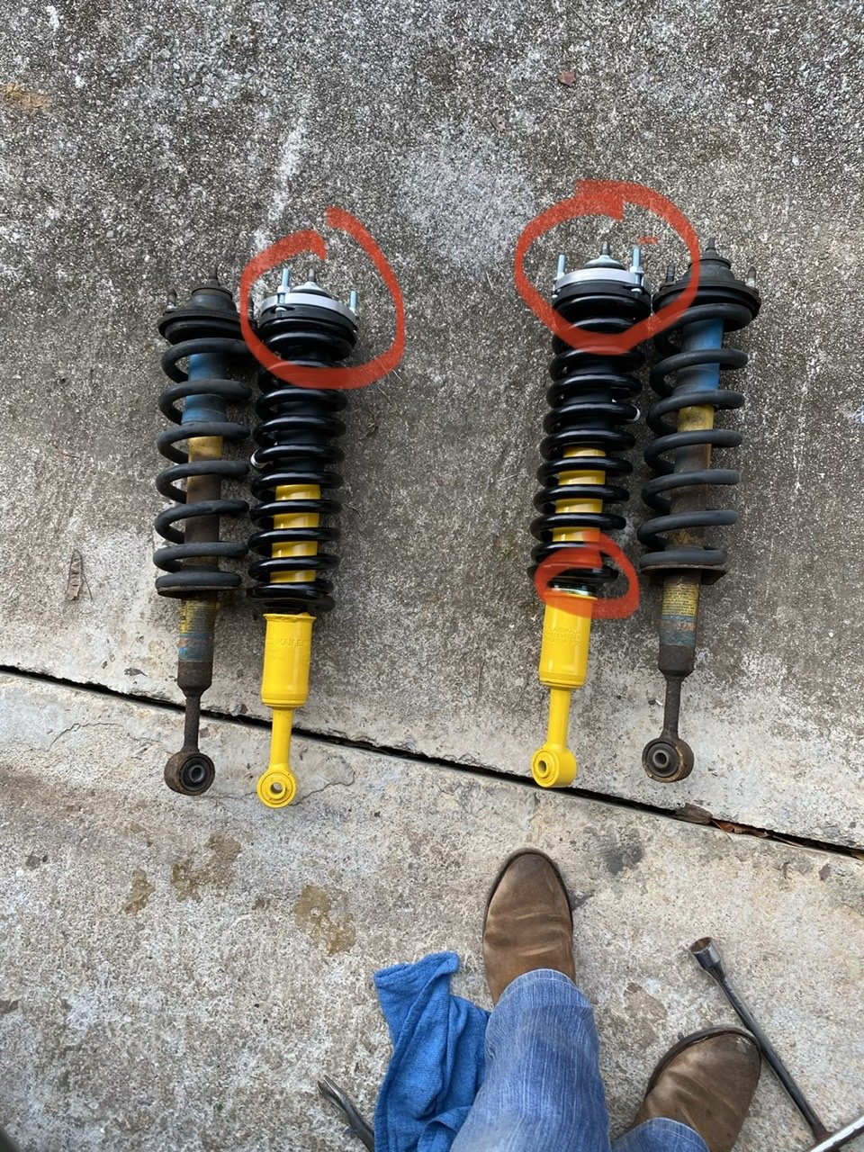

    So how the heck did OP get more than 3" of lift with the 885's?
  15. Jan 16, 2020 at 12:10 PM
    GrayTruck
    GrayTruck [OP] Well-Known Member
    Jan 7, 2020
    #315435
    88
    2009 DCSB TRD SPORT 4WD MGM
    Yea, great idea. I don’t have spare leaves, I had the leaf pack TSB done last year and Toyota kept them. I can just make something though. @Musubi3 this is how:
