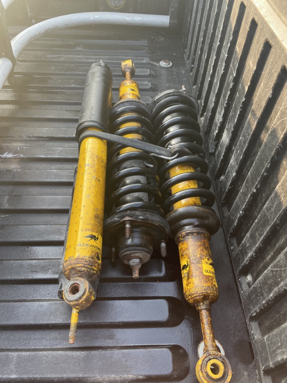

    So I just got some OME Nitrochargers with 886 coils from a friend of mine, and I’m wondering how to tell which front shock is the driver side and which one is the passenger side, or if there’s no difference? Any advice would be appreciated

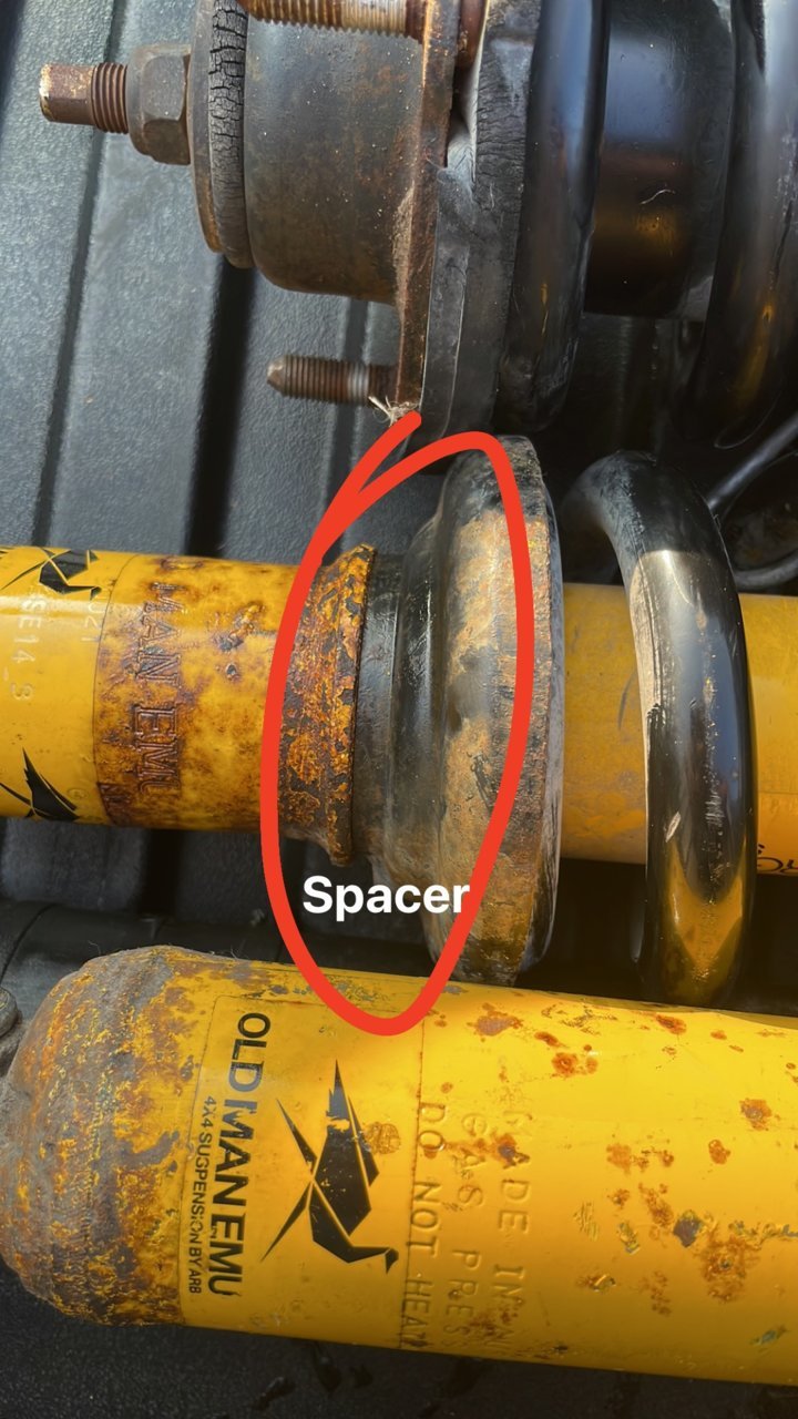

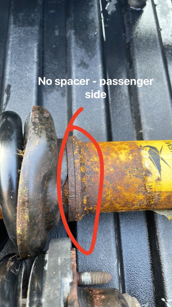

    Do you know if one side has a small spacer? If so, that would go on the drivers for the "lean".
    Do you have added weight up front? I ask because the 886's are meant for additional weight, and without it the ride will probably be stiff.

    I was told by the seller they had 886’s because he has a steel bumper and winch combo. I believe I saw the small spacer, I labeled them in the comment if you could verify for me I’d really appreciate it.
