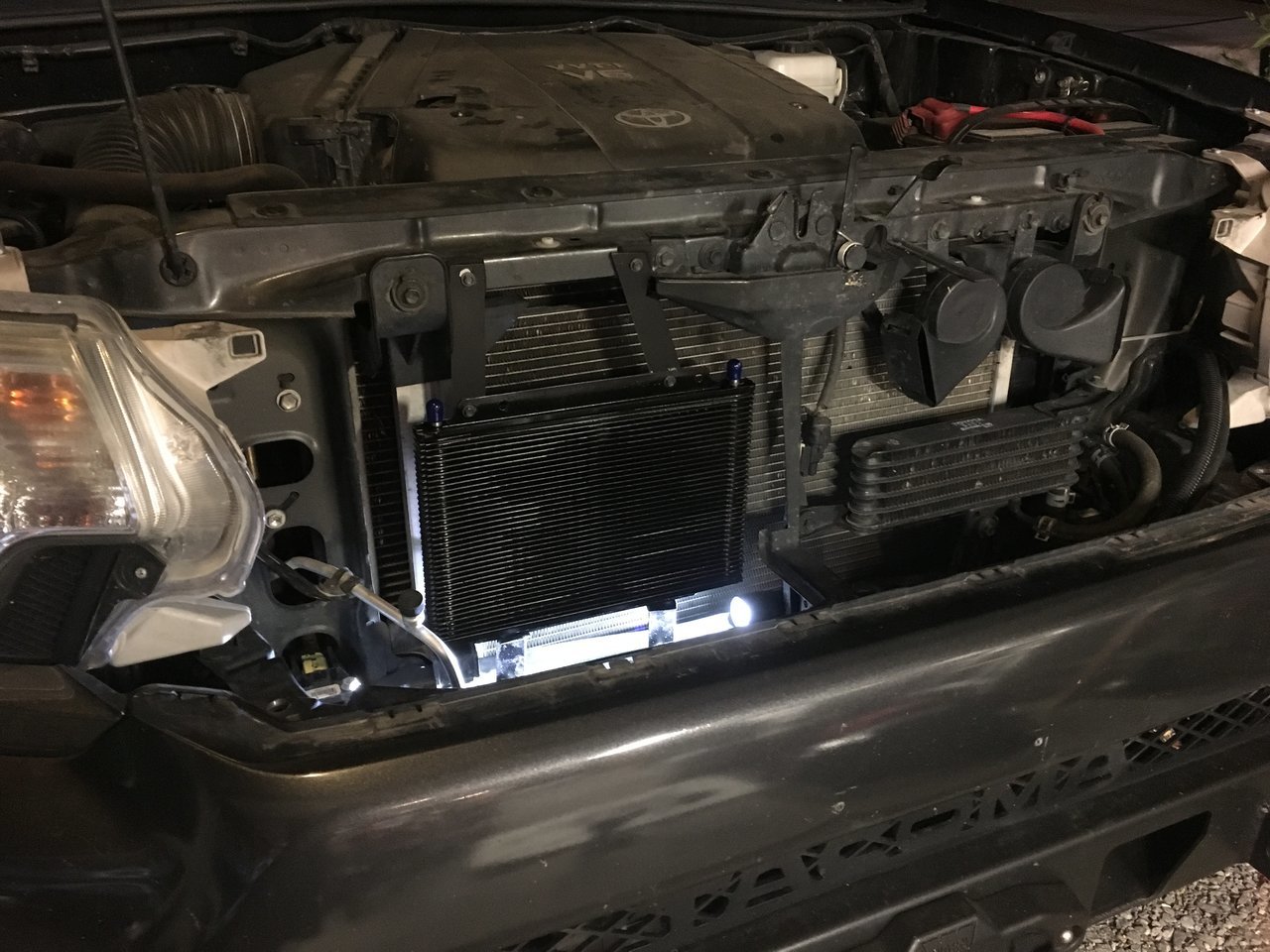

    The cooler on the lower right under the horns is the OEM transmission cooler (present on automatic transmissions only). Look for that, a larger 27 battery (vs the 24) a 7 pin plug at the hitch, and a larger 130 amp alternator (vs a 90 amp).

    Yes but if someone is going through the trouble to add a transmission cooler they will likely not be using the small OE cooler.
