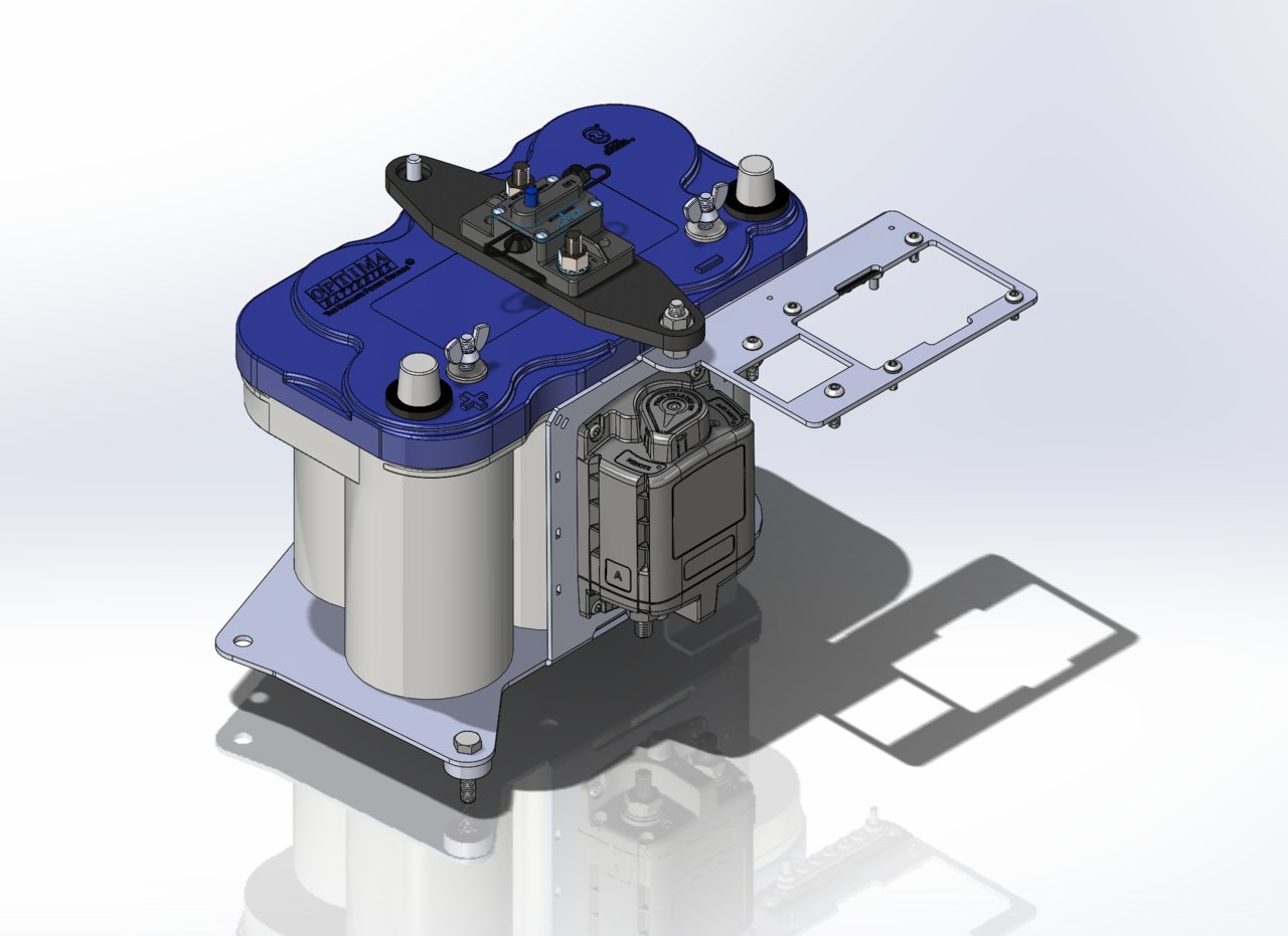

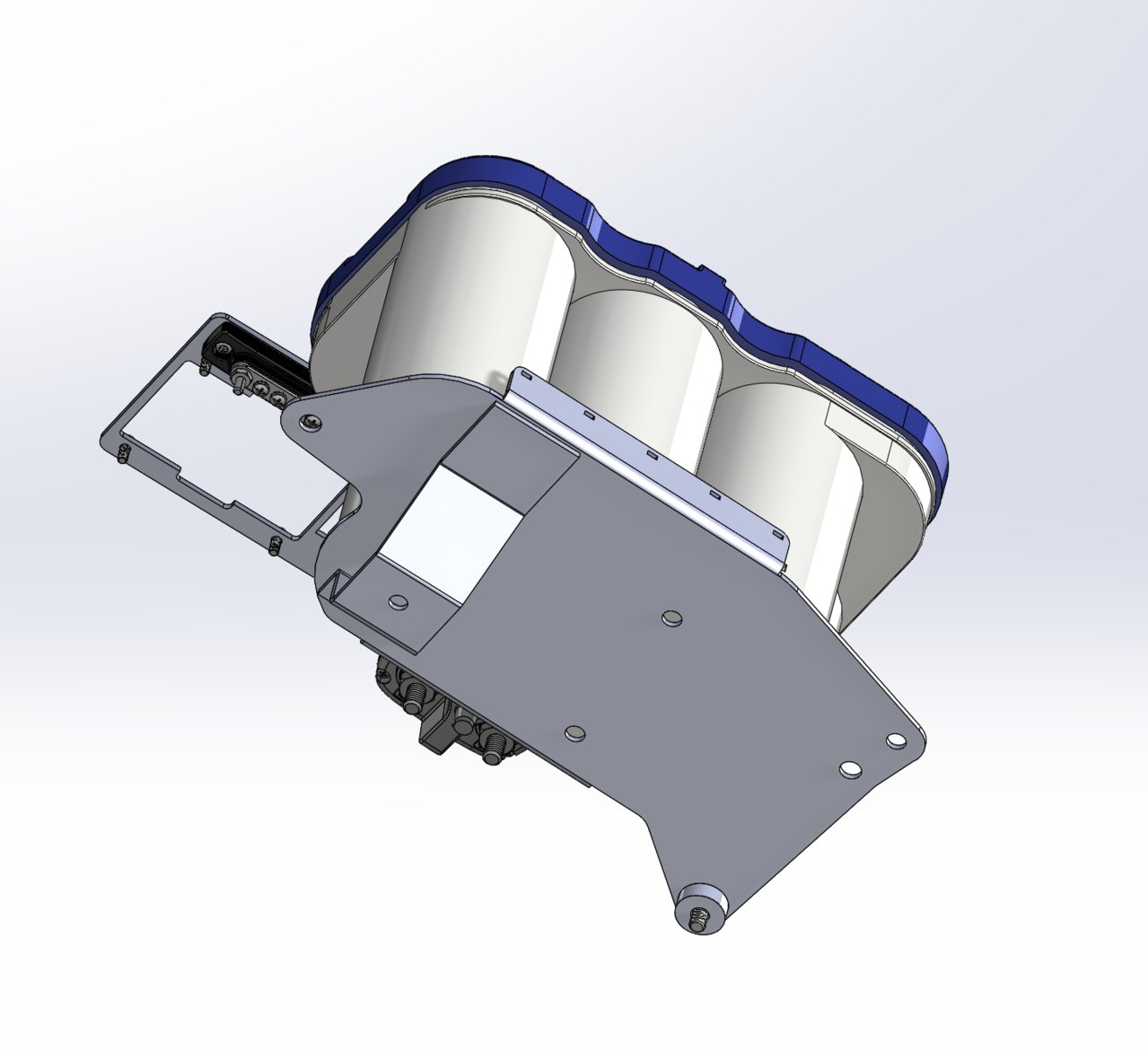

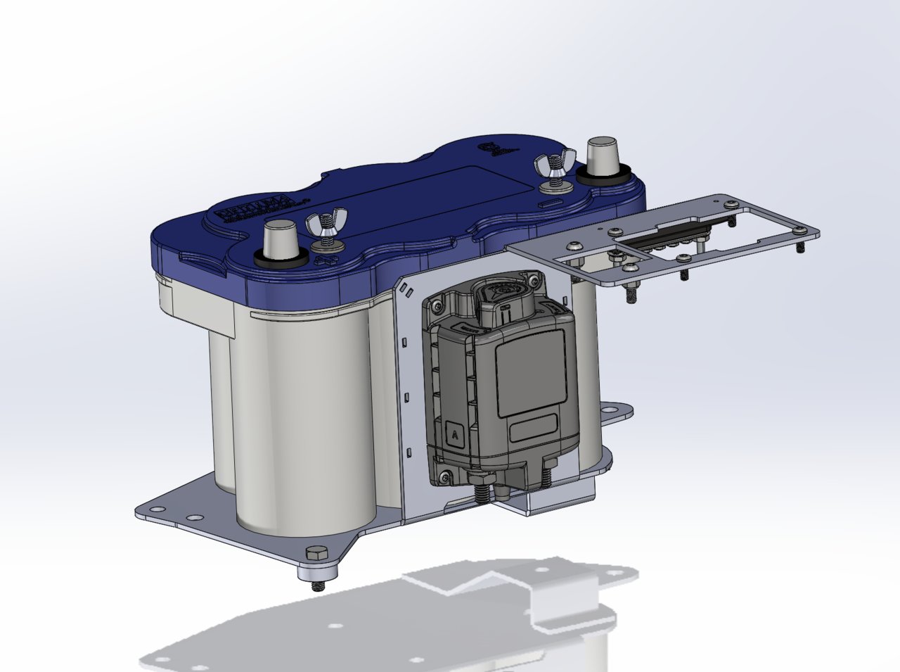

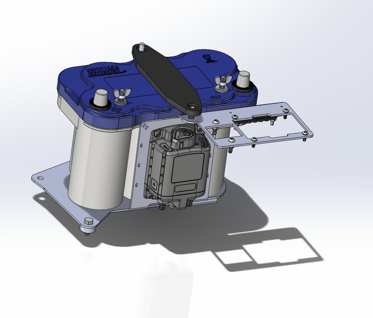

    Ok guys, this is it for today. 90% drawn up. The Top tie down bracket will also work with the stock battery.

    Ok it’s final guys. Just need to check clearance to see if the top mounted breaker clears the hood. I’ll shoot an email tomorrow to get pricing.

    I assume this will all drop into a 3rd gen, so if you need a guinea pig let me know. They seem to be the most thought out design I've seen so far. Subd
    @Iggy are you going to offer an option w/o the breaker/fuse block extension? Also, does the breaker/fuse block interfere with engine maintenance (ex: spark plug change)?

    Is this tray pictured going to be compatible with a 2013 SR5 offroad with manual trans? If so, I'm definitely in for one.

    Don't think so, you have the air injection pump thing on the way.

    Ok guys, I got a quote for these. What would be the idea of getting them done in stainless steel vs mild steel? Mild steel is way cheaper, but I would have to figure out powder coating. Is there any preference?
    Edit: It looks like powder and steal vs raw stainless is the same. Unless we run no powder and it's a paint your own type deal.

    I'm out the game on this - I actually was able to pick up the used one someone posted in this thread.
    I need to touch up the paint on it as it's missing quite a bit - given the choice SS would have been my preference.

    FYI I also added mounting holes for a sPod Bantam, if you don't want to go the RTMR route.

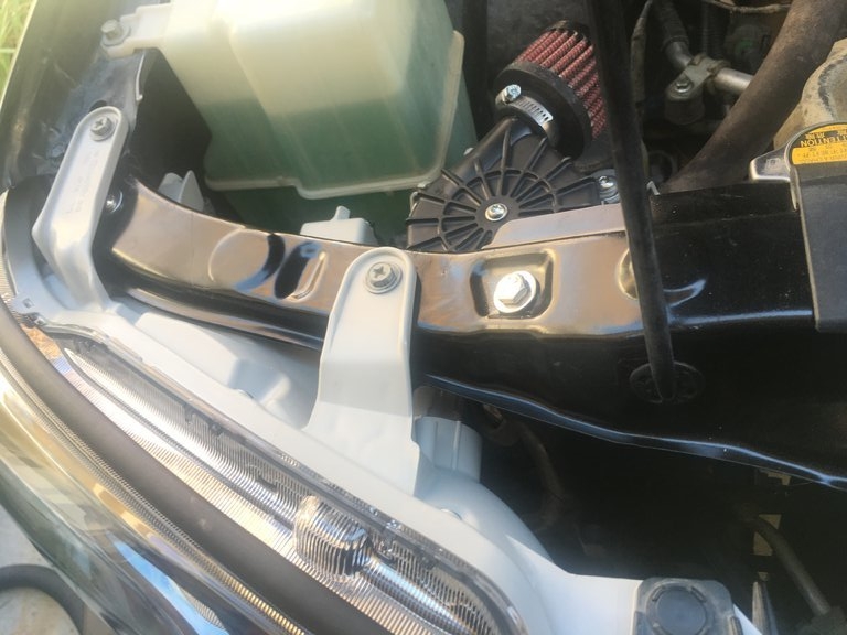

    It is possible to relocate the air pump, I did on my '13. K&N can sell you the needed hardware (usually supplied with one of their intakes), but you have to call.
    Here is the list:
    Description Qty. Part #
    Z Bolt; M6-1.00 X 25MM, SS 2 07858
    N Washer; M6 Split Lock Zinc 2 1-3025
    AA Washer; 1"D X 1/4 Hole Fender 4 08160
    AC Bracket; "C", 63-9037, STL, TB/PC 1 083169
    AB Bracket; "C", 63-9037, STL, TB/PC 1 083168
    S Bolt; M6 X 1.00" X 20MM Hex, SS 1 07795
    M Washer; 6MM Flat, SS 1 08269
    W Nut; 6MM Nylock, Hexhead, SS 1 07512
    The installation document (also attached to this post) is for the intake; just pay attention to the steps having to do with the air pump.
