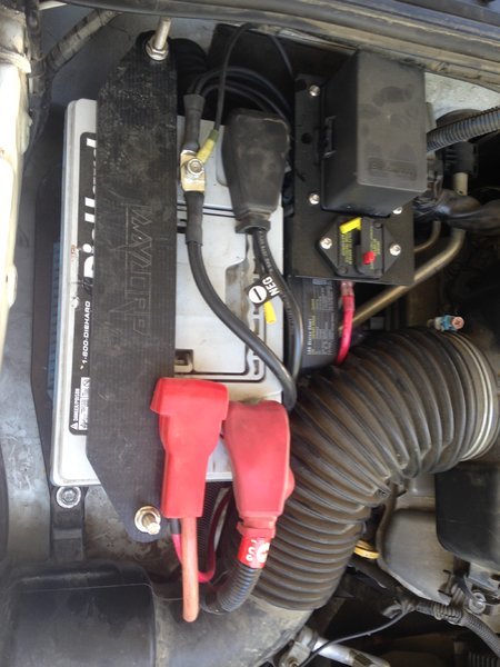

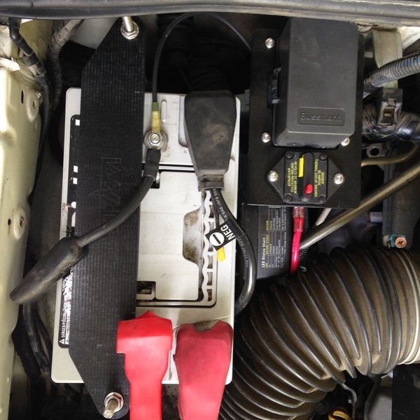

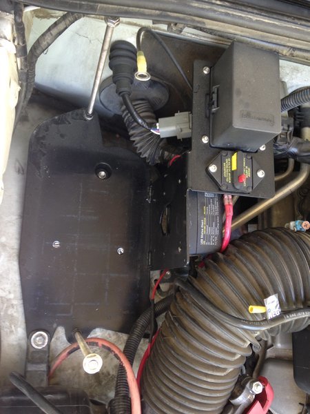

    Got one of these installed! So clean and consolidated. 5 relays, 5 fused connections, battery controller/ isolator, circuit breaker, and battery mount in one nice package.
    I used my existing group 34 and Blue Sea SI series battery controller. Actually, most battery controllers would work with this mount, but it's tapped for the Blue Sea ML series. Plenty of space. It's a little dirty after last weekend, but everything help up beautifully.
    This was right after installation- before some wire re-routing & additions today.
    Thanks again @Iggy. !

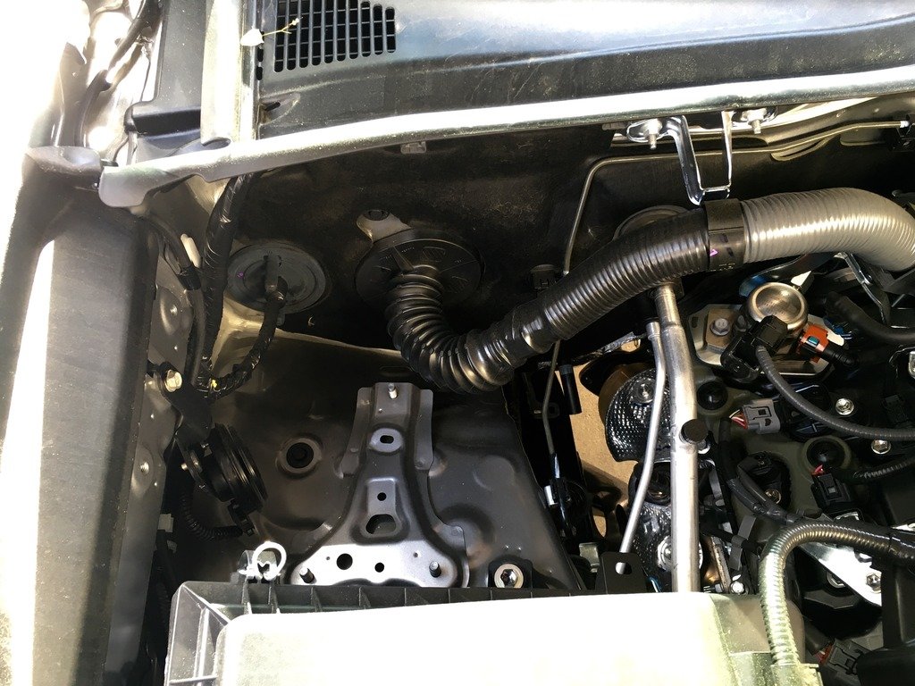

    Any progress/news on fitting the plate to the 2017 TRD Off-Road w/ ATRAC?

    Not really. With a group 27 battery the space is really limited in that area. I could design the same system to use a smaller battery, but I'm not a fan of the 34/35 size batteries for extended overloading use. You are better off getting a big main battery with solar.
