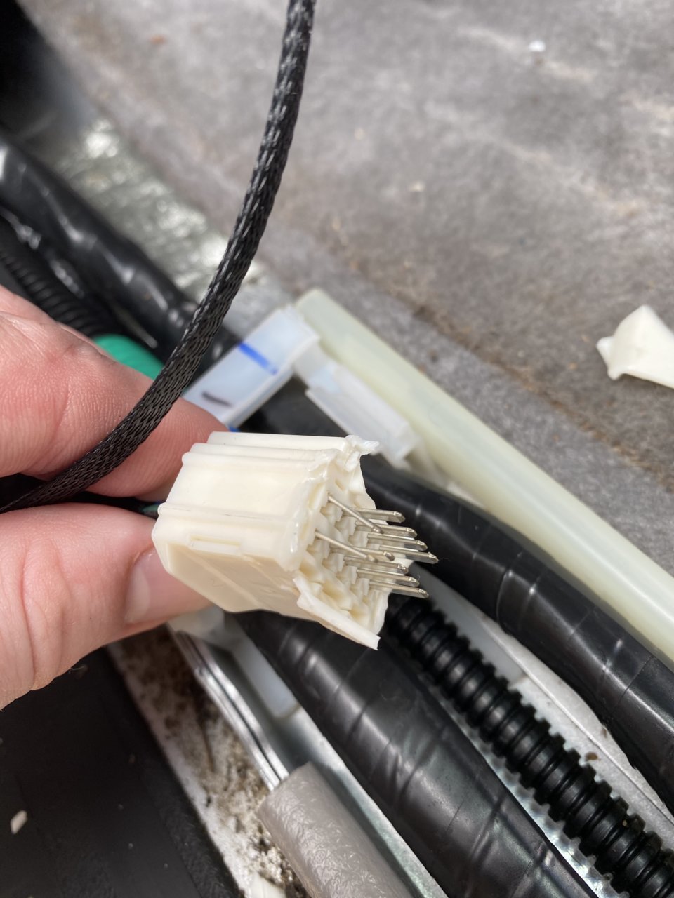

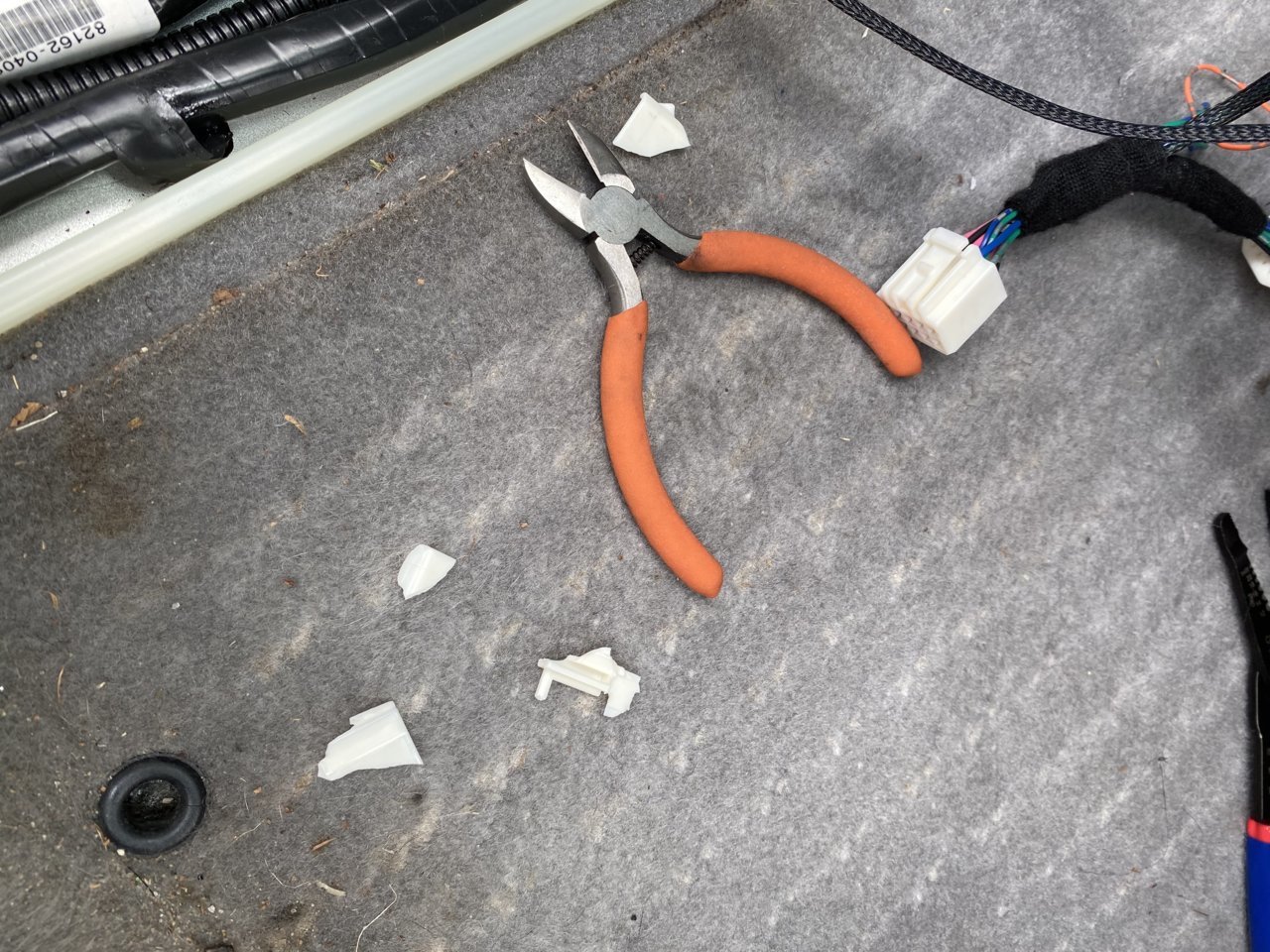

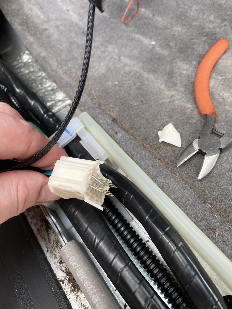

  15. May 5, 2020 at 2:22 PM
    #235
    prone2xl
    prone2xl Well-Known Member
    Jun 23, 2009
    #18803
    681
    Mississippi
    2008 Silver TRD Sport DC
    well my first attempt at install was a bust haha. Got to the very last step where you plug in the power lock harness and it was a bitttttch of a plug to get to. basically there are 2 plugged into the door jamb that are so hard to get to and of course I End up getting the wrong one unplugged and can’t get the other one unplugged for my harness. The top of my hand had already gotten cut up earlier getting in a tight space. Long story short I close my door to go inside and clean it up and get a bandaid and I hear this crunch sound. Part of the harness was caught in the door and it completely shattered the plug plastic housing and clip. ‍♂️. I was sooooo close. And hey here I sit with dash torn to shreds and no remote start. a quick phonecall to 12volt solutions and they are shipping me out that part of the harness that I need. man luckily it's a piece that's separate from the main t harness.. I can definitely say there are some TIGHT spaces to get into for plugging in these harnesses. the main ignition one was so rigid and stiff it took an act of congress to get it hooked in a certain fashion to plug in the harness. oh well. hopefully I can resume operations and get that one piece unplugged... anyone with a 2nd gen that has any tips for that last section please I am all ears. bc it is a MOTHER. I don't exactly have the best luck tho either
  16. May 5, 2020 at 2:45 PM
    #236
    Regnar
    Regnar Well-Known Member
    Apr 25, 2018
    #251674
    250
    Kodiak,AK
    2014 DCSB PreRunner SR5
    I’m pretty sure I just used a flat head screwdriver on the clip and pull on the wires to get the harness out. The hardest on for me was the OBD Harness
  17. May 5, 2020 at 2:49 PM
    #237
    prone2xl
    Jun 23, 2009
    #18803
    681
    Mississippi
    @Regnar that one was tough for me too! I hope that I put it back in right but I didn't really get a satisfying CLICK when I put the clip back into the original OBD spot. everything seemed so damn tight with these things without much give. So you used a screwdriver to pry away the clip for the lock harness ? I'm guessing that's what i'm gonna have to use. I tried unclipping that thick harness piece that he shows in the video to move to the side and thought that someone had used a zip tie around it when installing my stereo so I cut that and still wasn't able to move it away... i'll have to find something to try and get it away b/c I would definitely love more room to work with there. of course I would have unplugged the one that wasn't the right fit for our clip. damn.. oh well I guess at least a large portion of the install is done, but I fear i'll have problems finishing her up given i'm at a critical stage... sigh.....
  18. May 5, 2020 at 4:28 PM
    #238
    jbaker1976
    jbaker1976 It's always Taco Tuesday
    Oct 18, 2019
    #308323
    272
    Jason
    East TN
    2015 DCSB OR
    Camper shell with side windoors and bed slider, JL Audio Component Door Speakers, JL Audio Stealth box, Grill Craft Grill, Husky floor liners, Hondo Radio knobs, Predator steps, Remote Start, Pop N Lock, etc...
    I do remember that harness. It was a pain to get loose. It was deep back in there. That sucks man. I hope your luck improves.
