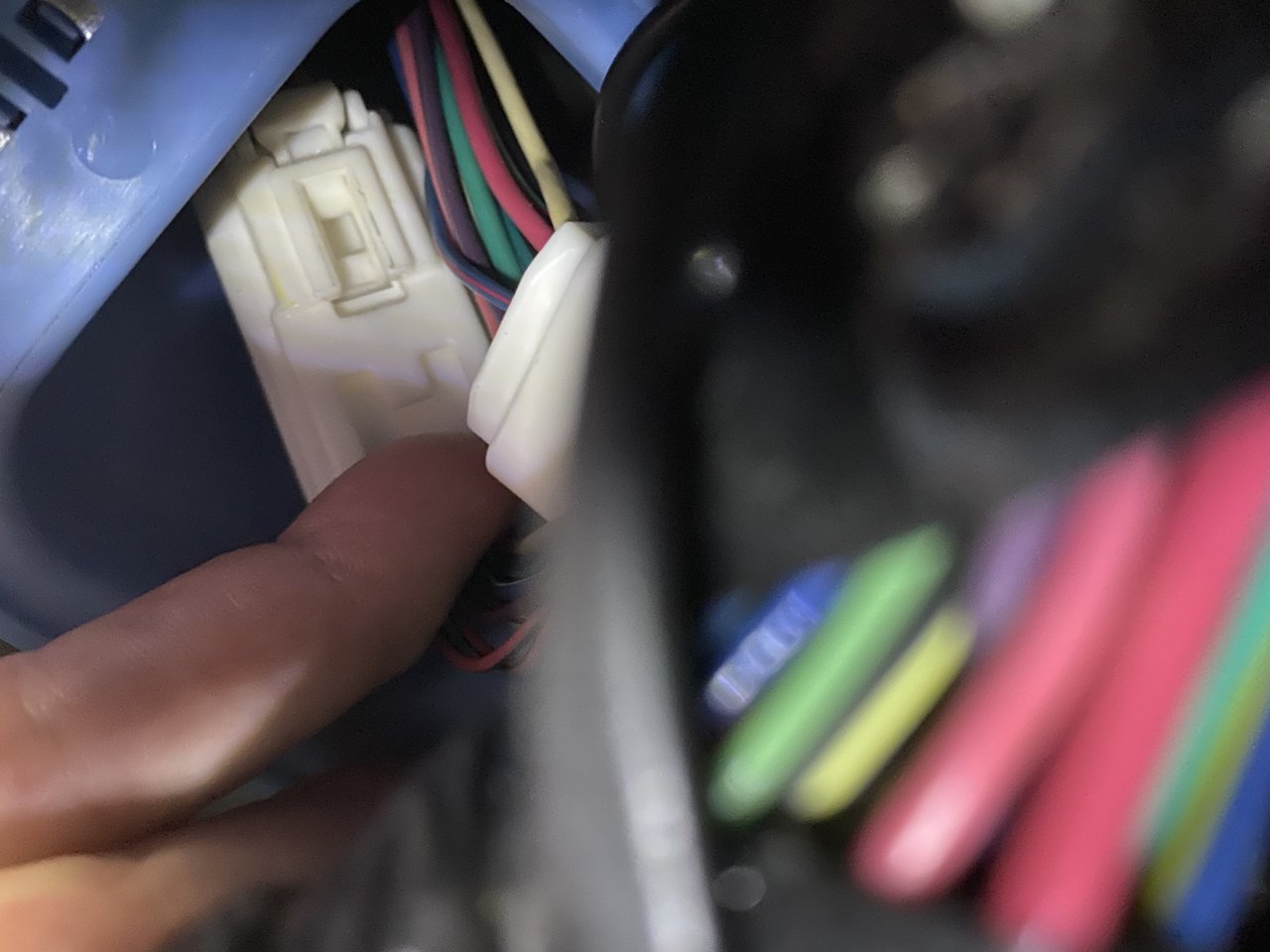

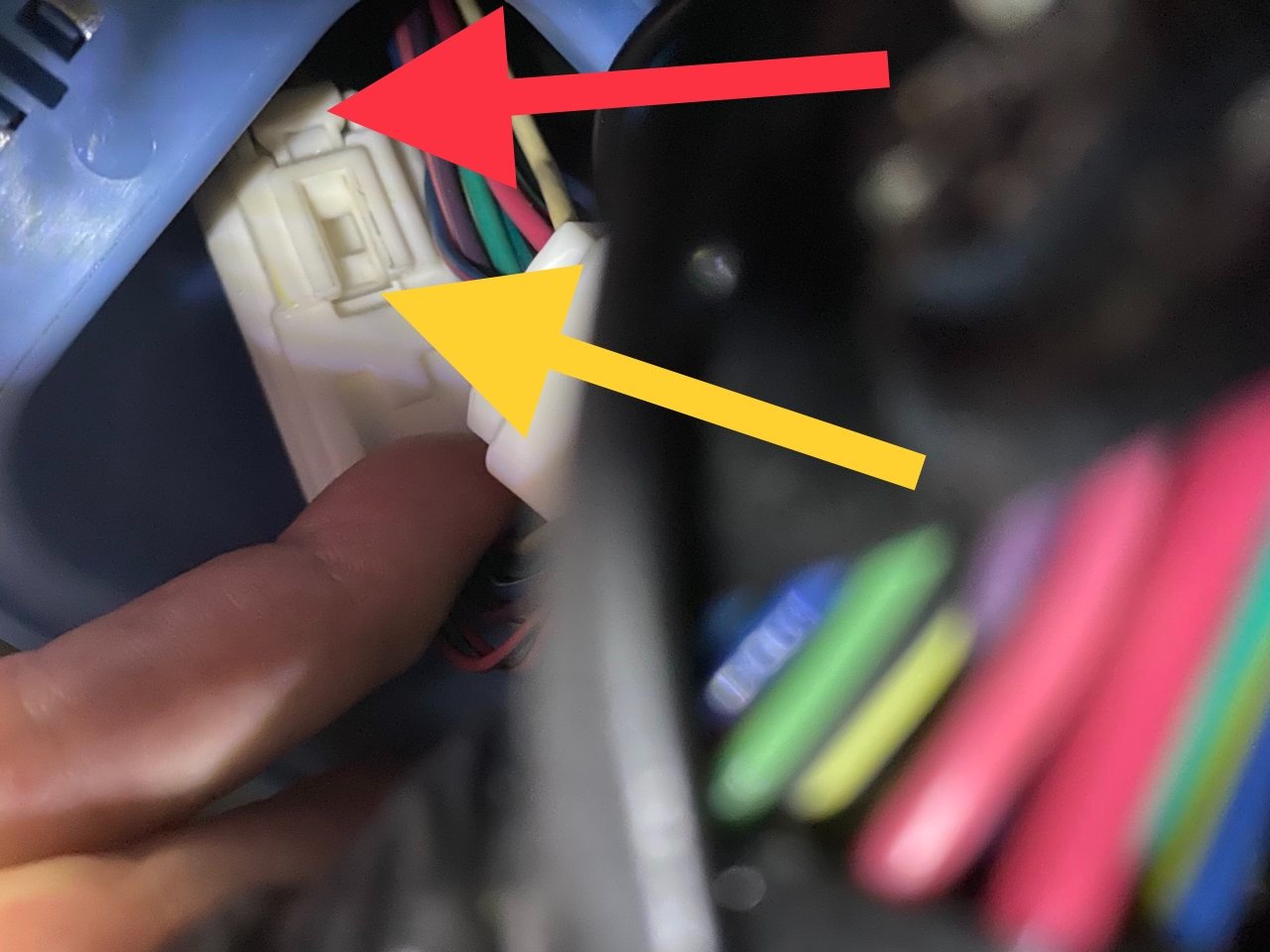

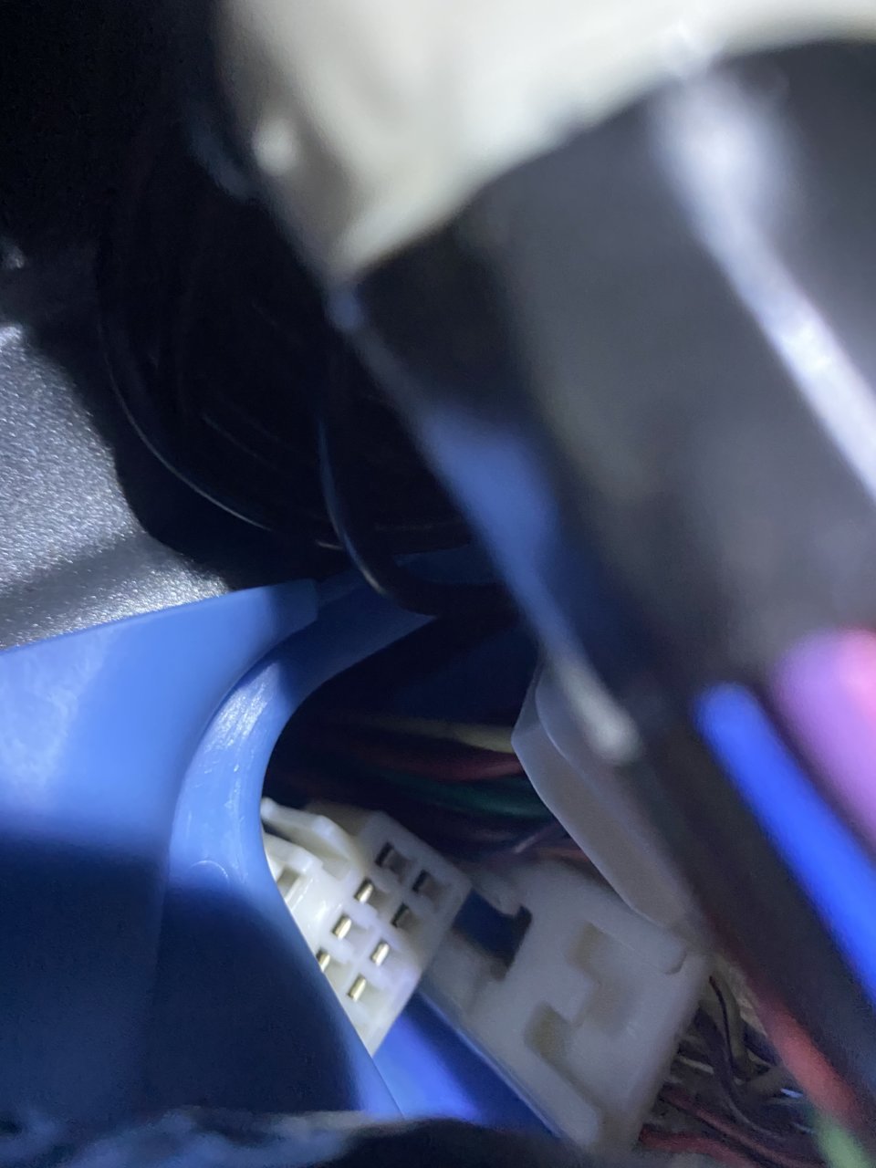

    Can’t for the life of me get this final plug unplugged guys for the power lock this is the final step in the driver kick panel. Have tried every possible weigh my body and hands can maneuver without success. Please any best practices/tips. This is driving me nuts. Best pics I can manage

    Pretty sure you can remove or slide that blue cover, should slide right out.

    I’m tugging the slack wire as best as possible even cut my knuckle up again. Best pic I can obtain. Is the back portion of That clip what I have to engage in some way. FDAFFCF7-4753-48AE-9170-790D8EE8DF5F.jpg

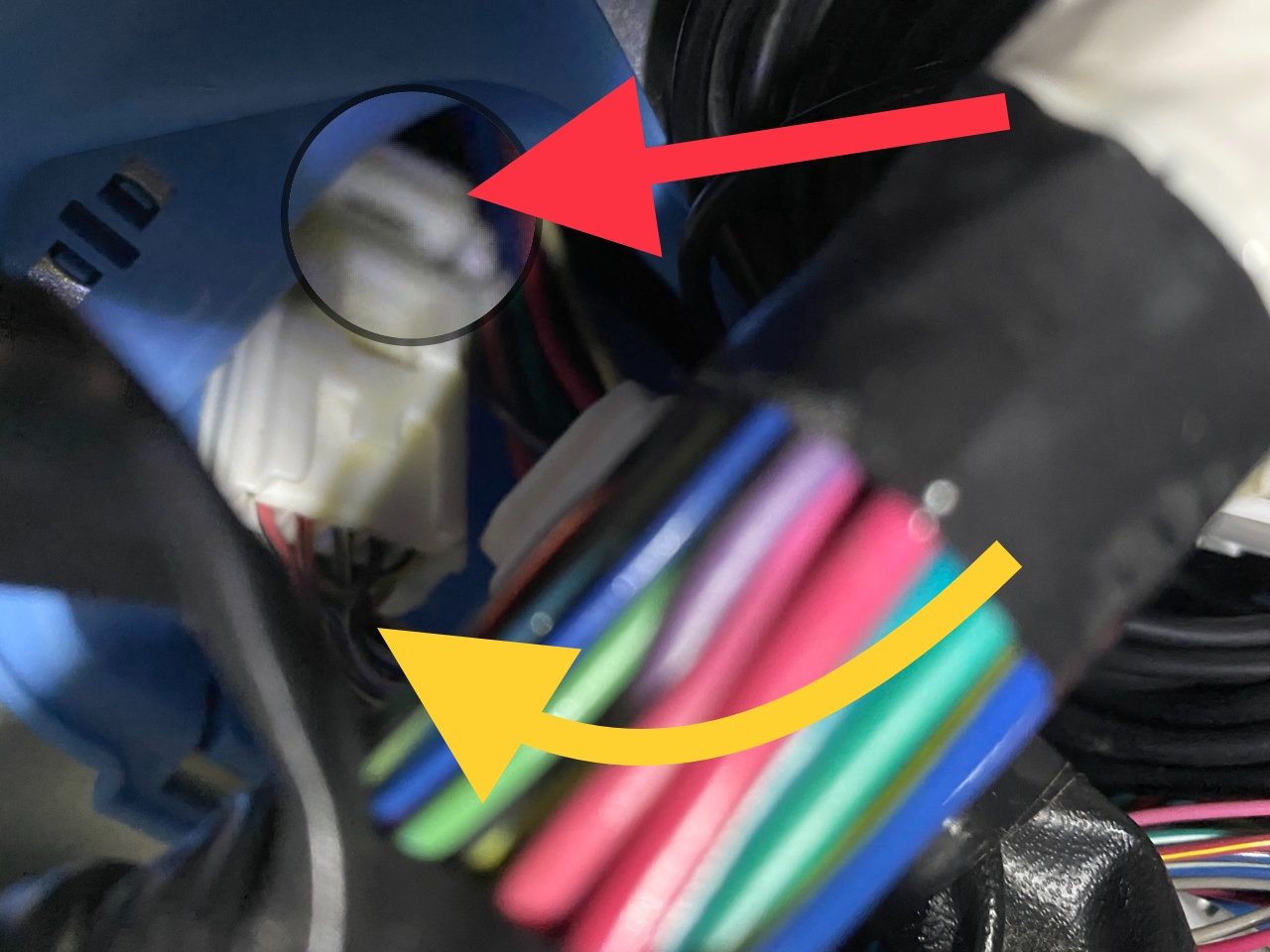

    Push on clip with a long flat head screwdriver( Red Arrow) and pull on the wires (Yellow Arrow)

    Remove the blue plastic, it’ll give you little more access to that plug.

    I wish I knew how. I see lots of little clips going around it. I guess I’m worried to break even more things lol. Gonna attempt the long flat head pressure trick now. I can truly say this is technically plug and play but it is definitely not easy on this final damn plug!! Thank u guys so much for your quick help and support. I felt like a boss getting to the very last step and now I feel like a failure

    You can all try pushing on the clip (Red Arrow) and inserting another flat head screwdriver and twisting (Yellow Arrow)

    Omg it was finally achieved with the flat head and steady pressure. I was afraid it was gonna break. @Regnar and crew i owe u guys beers. Hoping i can fit in the plug now and hopefully that’s the right fit !

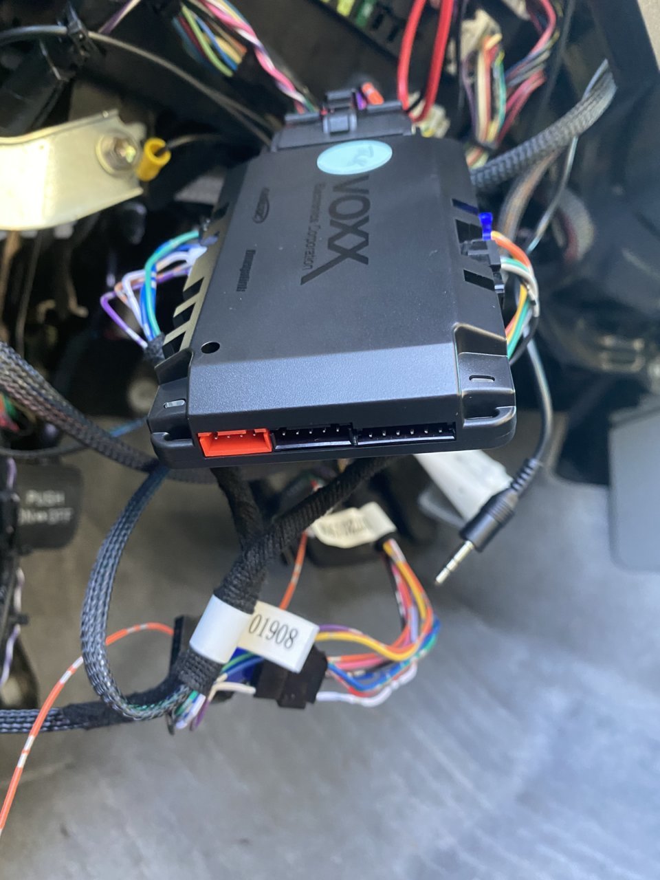

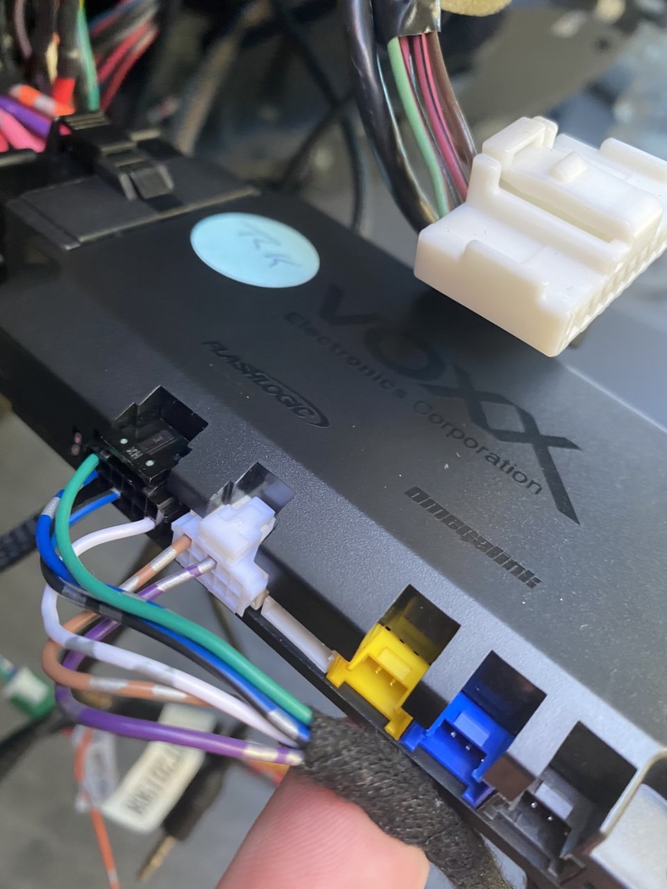

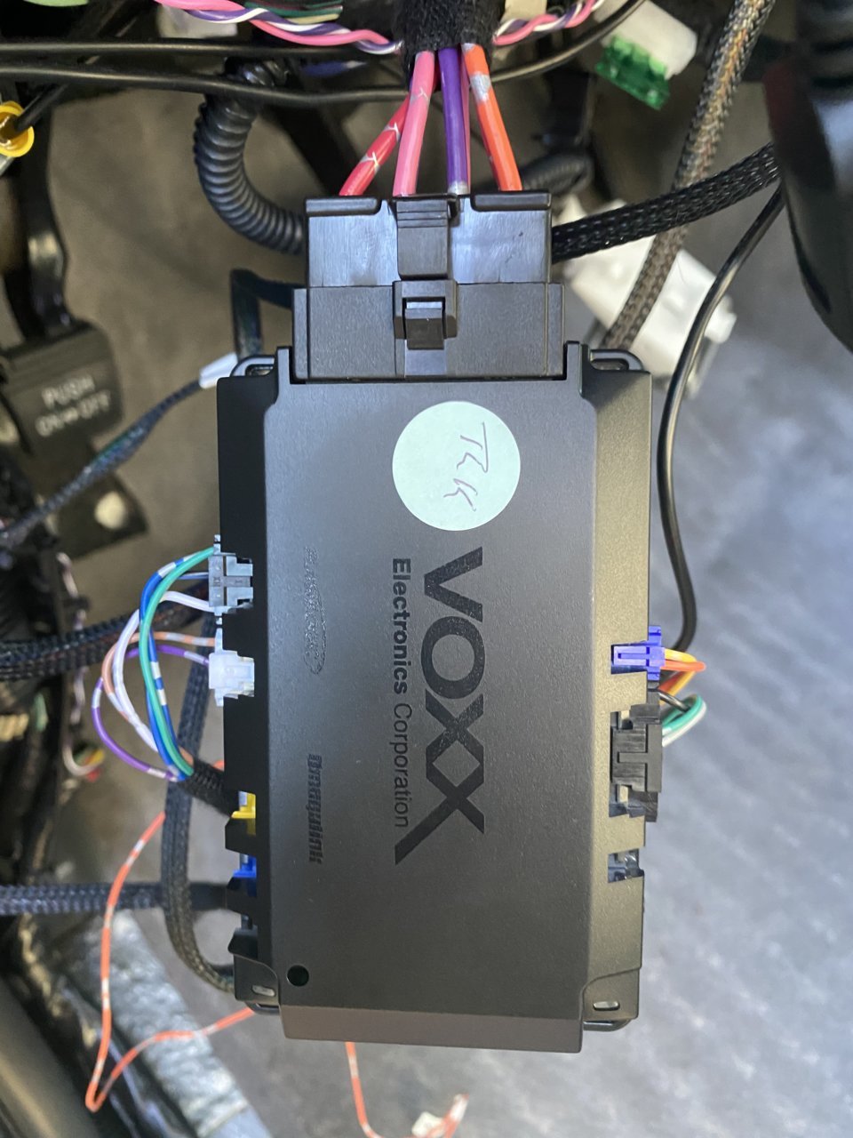

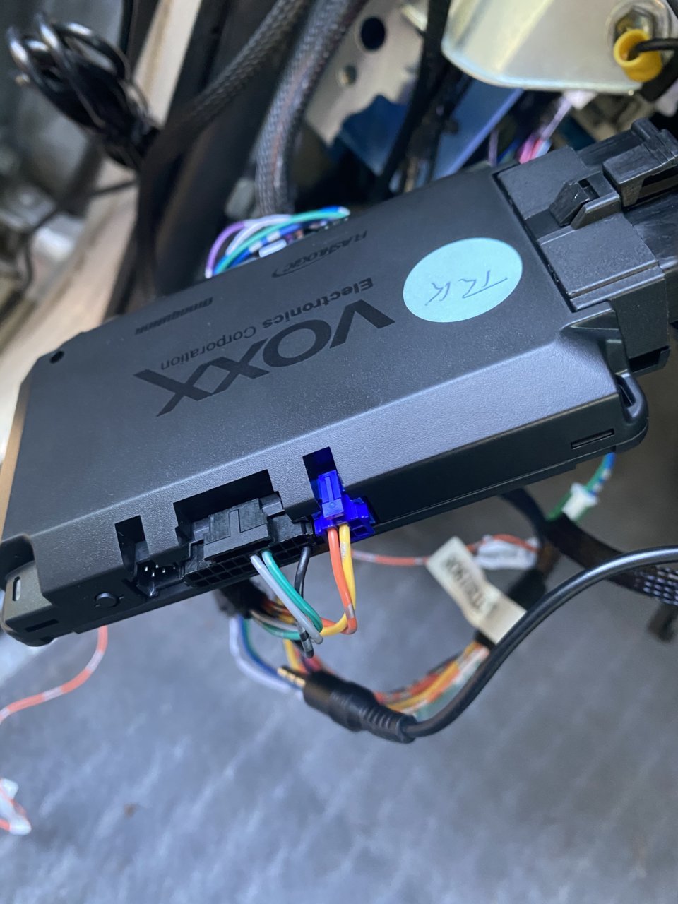

    Ok what plugs into this smart module? I don’t see any instructions as to what plugs go into the module portion ? Pics showing what I have plugged. I tried plugging everything they had somewhere. Nothing I can see to go into the red or other black plug ins on one small end in my final pic. Thanks. I’m tryin guys. I really am.

    I’m pretty sure it’s color matched for the ports for the most part. I believe I had two slots left empty and one was for the smart phone module I didn’t add on, and the other for something else. I can check mine tomorrow possibly and let you know for sure. I don’t remember taking any pictures of it. The instructions weren’t precise and that was my only gripe about this thing/company.
