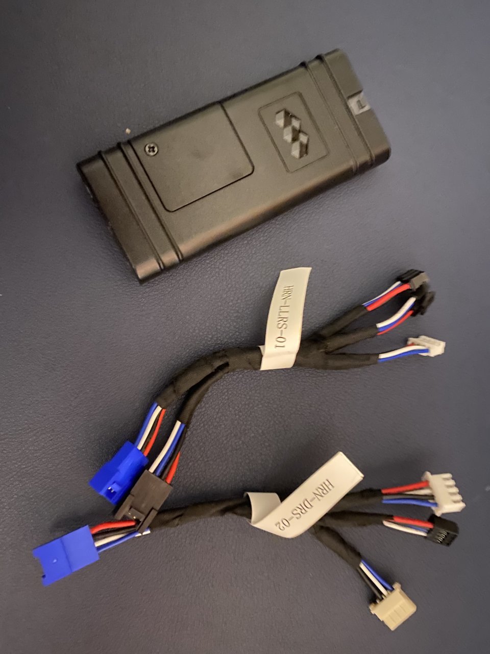

    Hey guys anyone that can help me with the Carlink ASCL6 smart phone module add on I would greatly appreciate it as there were absolutely ZERO instructions given in the product i received from Amazon. Got a great deal on it but no idea how to connect or which harness to use. Or protocol.
    The contents of the device are pictured below. I of course have the 12volt solutions module for the 2nd gen Tacoma 2005-2011. Thanks a lot in advance guys. I’ve learned a lot through this but man the instructions have been very lacking for someone who doesn’t do this on a daily basis such as myself !

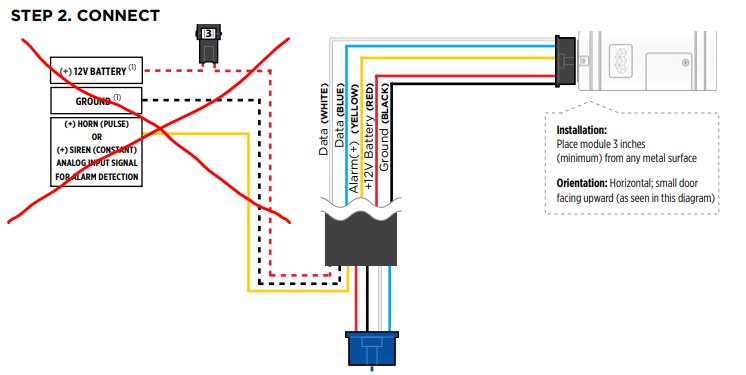

    1) Find out what brand your remote start module is, for example directed, Fortin, Compustar, etc...you can open up the trim and look, or call 12VS and ask (tell them you bought it from them so they are not reluctant to guard thier secret since they always claim to be manufacturers when in reality they're re-kitting and re-packaging the modules; the harness on the other hand IS theirs and made in house).
    2) Find out which model it is as well (i.e. Directed DB3 or Directed DS4 or Fortin EVO-ALL or Fortin EVO-ONE etc)
    3) Once you find out, you're home free. You can click here and reference the setup based on that you find out from #1 & #2 above.
    In most applications, you will NOT need to use the extra 3 wires that protrude from the "MyCar" Main harness in the ASCL6 smart module as seen in the linked instructions (#3 above).
    Download the CL6 app from the app store, and after registering, you'll get an activation link in your email.
    Some remote starts require that you do a small programming sequence to sync/teach the smart module to the remote starter, while some, you just plug it in. It'll be in the guide I linked above.

    Yeah I looked at their youtube online and it seems they mention the ADS type. the only thing I wonder about is what goes to what. they mention a different usb plug that's (sold separately) but I don't know if others have to use that on here or not. anyone that has any info i'd love it. thanks guys !

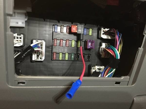

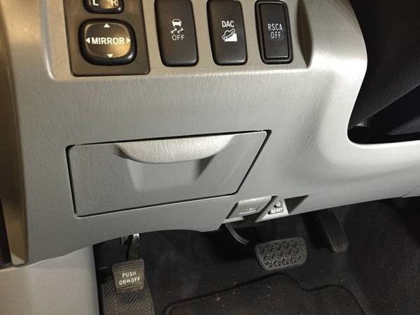

    Ok got it installed! Ended up not using those extra 2 plugs that were sent with the unit. Only having one problem now. I can’t get the dash fuse pocket cover back in given wires behind the dash from the harness. It just stays open and won’t shut or latch Any tips/best practices? Don’t have a direct pic of what my mess looks like but I’m talking about this area

    Just got my Accessorides kit installed today. Install went very smooth, I'll admit the instructions that came with it were pretty vague on the connector locations. To speed things up I used the 12v install video on youtube :rofl:
    I ended up putting the module here and spent some time routing and zip tying everything clean
    I did have to splice 1 wire which was the brake sense wire, I ended up soldering it for reliability. I haven't tested the range yet but I'm very happy that the 2 way remote has an audible beep when locking, unlocking or remote starting. I was already doing research on how to wire up my factory keyless piezo buzzer but it looks like I won't need to anymore. The module has some nice output relay options so I might play around with auto roll down windows or something that will engage the AC if it isn't on when the truck starts
