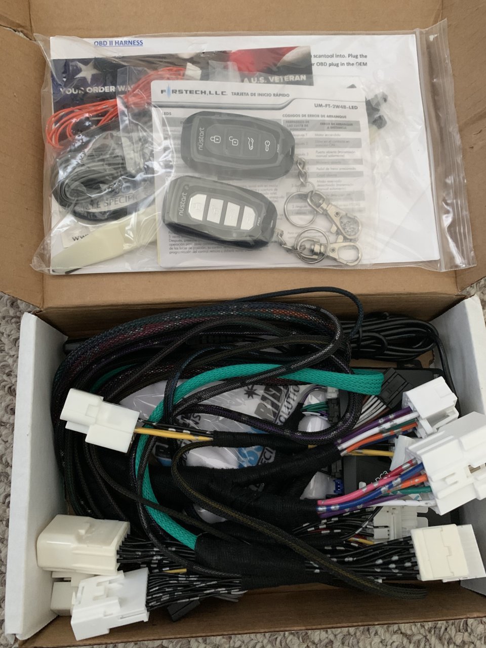

    Ordered mine in November 26 and it arrived December 7th. Install tomorrow

    I ordered the same day and it was suppose to be here the 7th

    Mine finally showed up today. Looks great so far. Hopefully i can get to it this weekend. It came with a hood pin switch which i wasn't expecting so thats a plus.

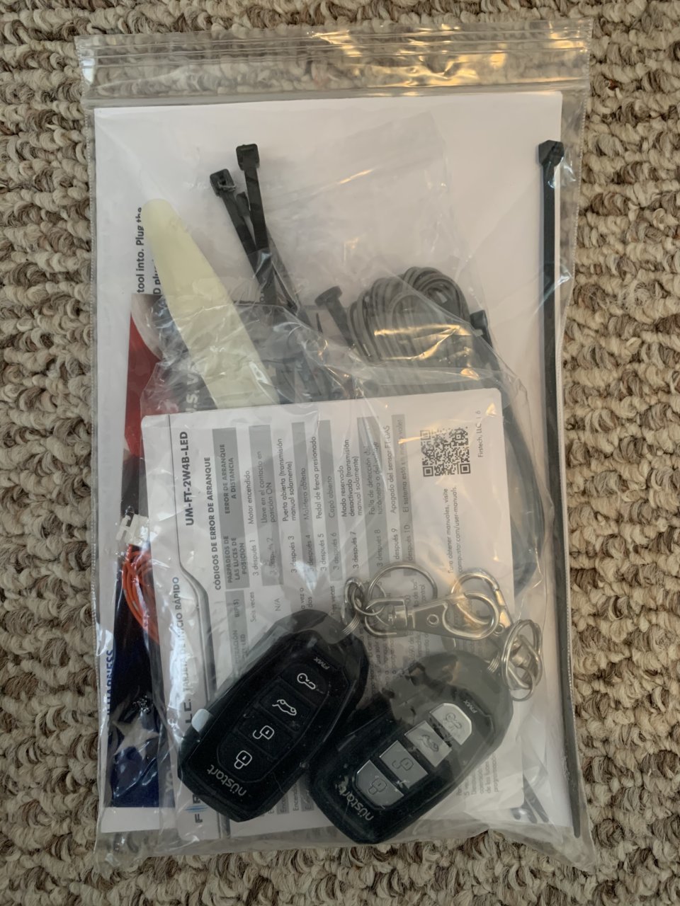

    I get it too, I really do think its out of their hands but they were very polite about my issue as well. I was looking through the kit late yesterday and saw an orange wire with a connector with no info about it so i emailed them to ask (after6 pm) and they replied back a couple of times confirming what it was for. I have packages coming from 1 state away that taking well over a 2 weeks
